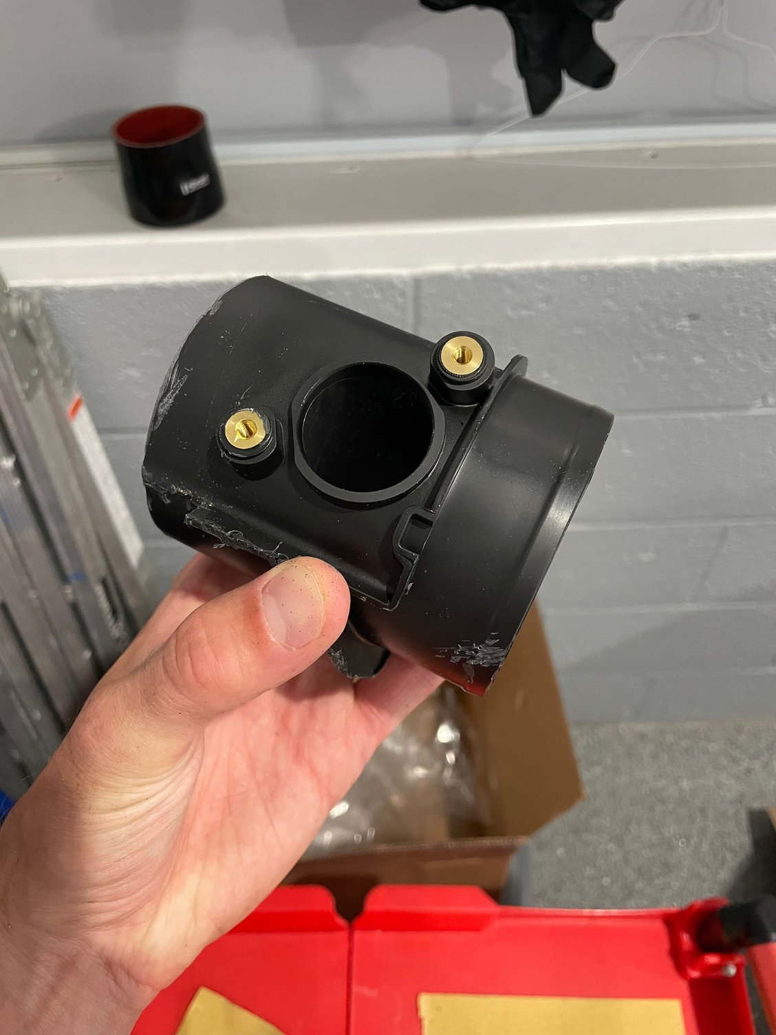

Missing part.
I've ordered 3 of these kits....2 for TLX Type S and latest for my '25 RDX. I had all items laid out to get ready to install. Had OEM factory
unit disconnected. I looked at everything and realized the new kit was missing a part. Look at the pic here....right side just above the hose clamps.
That part goes down in to the larger hole in the PRL silicone intake hose. I didn't get that. Took awhile to make sure, etc, etc. Called PRL at
724-325-6300 and pressed "2" for Cust. Serv. The lady was pretty knowledgeable, but, I also asked to confirm the issue with someone in the
Tech Dept. He called me 15 min. later and we talked it through. Apparently this same issue happened once before...leaving out that part.
He confirmed it's what i needed and they are shipping it out UPS today. Their picture on PRL web site for the 2019+ RDX 2.0T Stage 1 does NOT
show this piece. And it should.
So, what you see with the picture that was posted and I copied here is what you should get.
Best Wishes! OH...just for info on my '24 TLX Type S with this Stage 1 Intake Kit......the throttle response is VERY noticeable. Throttle "tip in" is right there
and the acceleration is smooth, strong, and linear. Felt the same on my '22 TLX Type S. Same Kit. Easy install. No real increase in HP or 0 to 60 times I'm
told....but, the drivability is quite apparent. Worth the money...at least to me. Street driven car.
On the RDX...just a little more involved, but, not "rocket science" IF you have decent mechanical skills. Don't need to be an "Acura Master Tech" to install.
True, they don't include an "Install Guide" as I feel they should....so I watched a You Tube video from AHC Garage...a division of a large Acura dealership in
