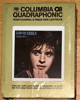

Originally Posted by Tesla1856
Depends on the final mix of the track. Who did it, did they do a good job, did they have a good (multi track) master recording? Pretty sure I already explained this once.
For example, I have a FLAC of David Essex - Rock On (from a [2 channel Stereo] Audio-CD) . But the 5.1/6ch FLAC that I uploaded is a totally different experience and the best version I've ever heard. But that wasn't created from the Audio-CD. It was re-mixed from the master-recording, and was likely originally distributed on an optical media that supports multi-channel recordings like SACD, DVD, or Blu-Ray.
https://drive.google.com/drive/folde...z8yKJVX43MPPfd
The "Rock On" that you have came from, you won't believe this but it's true, a quadraphonic 8 track tape. It's one of the files I posted a while back. It's an incredible quad mix that sounds great in the car. When you consider that it was done around 1973 without digital studios and software, it's quite an amazing mix. It has never been offered for sale in a digital format (SACD, DVD-A, BluRay Audio)
Well, I stand corrected. And you did a great job on this one ... actually all your stuff is nice. We all really appreciate you.
Yes, I see now ... I just viewed it in Audacity. Yep, quad-tracks with no Center or LFE. Well, you certainly can't tell in the car. I have some light DSP running so maybe it matrix-ed the Center and LFE? I'll have to play it some more ... maybe in the home theater this time.

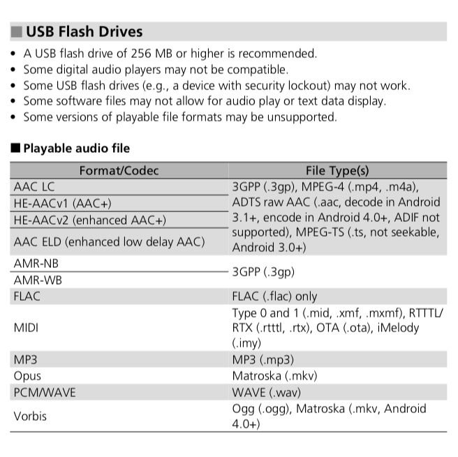

What kind of files WILL my RDX play, if I want to just run non-FLAC but load up a USB with a playlist?

Here the list of playable formats from the 2022 owners manual:

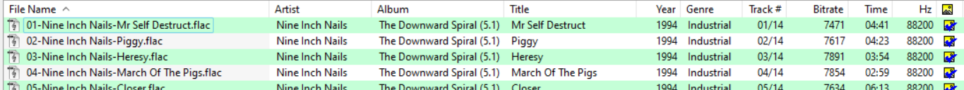

FYI These tracks are 5.1 and 88.1 kHz. They work on my 2022 but did NOT work on my 2021 loaner when I took it to the dealer. So looks like they have improved compatibility for 2022.
