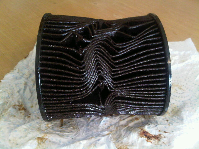

I have 2 cars with drop in oil filters. Basically they are the guts minus the metal housing. The housing is built into the car. With these drop in filters you get a clear view of what the filter media looks like when you change it. I have seen these at 8k to 10K miles and it is not good at all. They start getting clogged up and start to become sucked inwards. These filters seal to the housing at the top and bottom to force the oil to flow through the pleats. When the pleats start to suck in/deform they pull the top and bottom towards one another. This in turn breaks the seal and starts allowing oil to flow around the pleats.
This pic is not mine but shows the deforming of the filter that I am referring to. This is what I was seeing at those extended milage changes
No way will I ever let them go that long again.

it does not matter. Have you ever cut these filters? There is not much dirt in them as people think, they will easily go 15-20k miles. Oil filter that is not clogged filter — will filter just fine even with 10k miles on it. When you change oil, even including filter, you never remove all oil from car, plenty of old oil left that just mixes with the new one.
I change mine every MID cycle, but it’s not necessary. I do however change oil twice as often, half way in MID schedule.
I have seen ones get clogged and start sucking itself in before 10k of use. I have seen this more than once. I posted about it earlier. I will never let a filter go that long.
