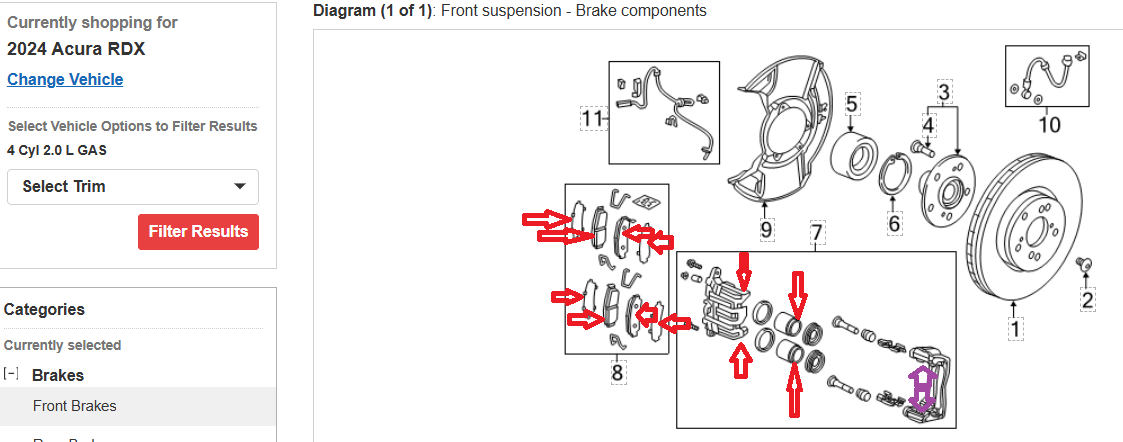

Not sure if any of you all are mechanically inclined; however, when I perform 'brake jobs' (new pads; brake pad shims; caliper bracket retainers; rotors) on my vehicle(s), I reasonably 'lube' the areas indicated by the arrows below:
Acura states on the April 2, 2024 19-053 TSB to apply the included ATE Plastilube paste, as shown below, only to the rear brake pad set.
However, if you look at the updated May 30, 2025 19-053 TSB it completely omits any mention / depiction of applying ATE plastilube to the rear set and shifts its application to the front shim kit?
IMHO, the techs should be reasonably applying the ATE plastilube to the areas, indicated above, to cover all potential 'metal to metal' (front & rear brake calipers) contact surfaces to avoid continued 'squeal' after the customers vehicle has been visited for this issue.
