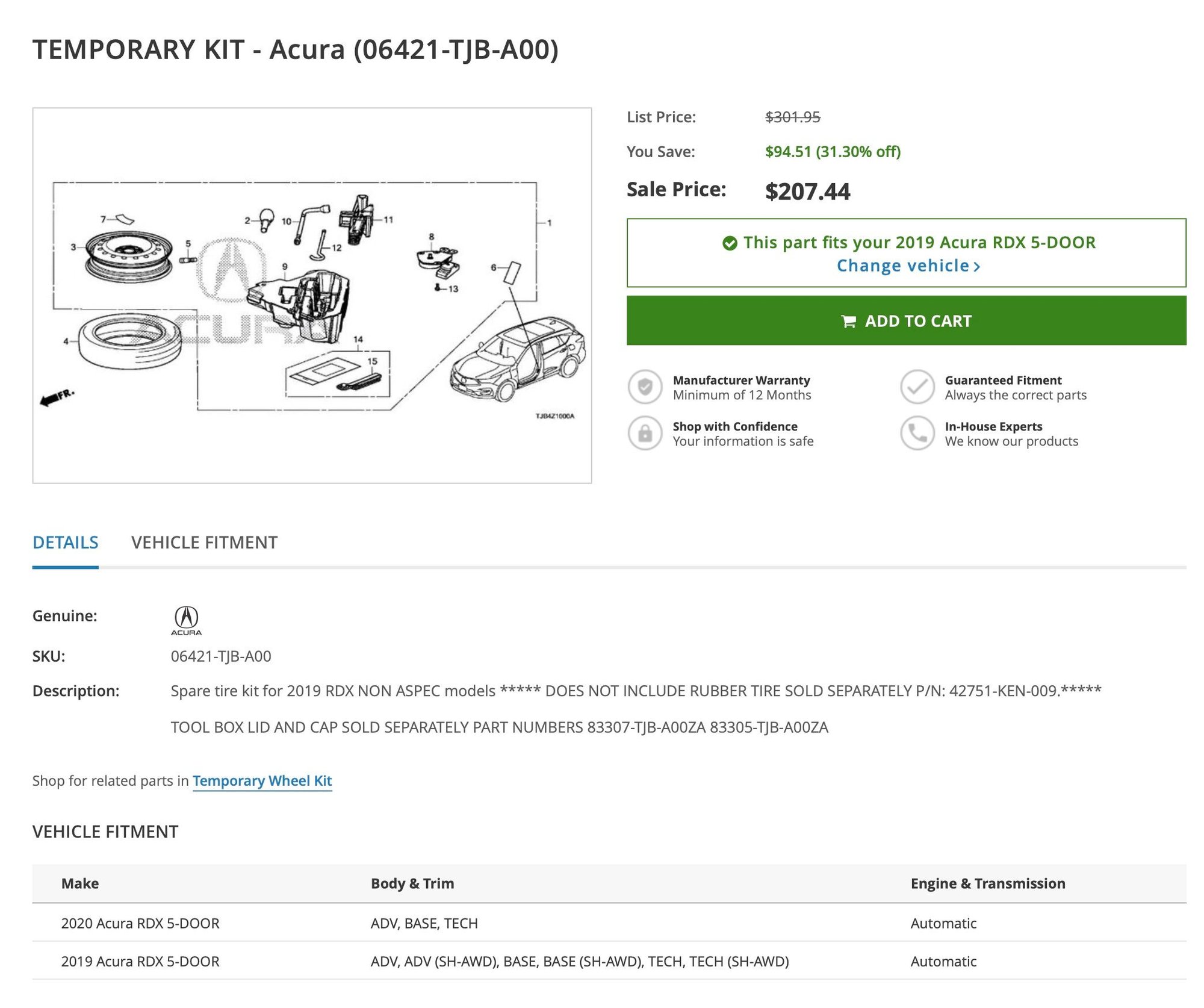

Yeah, as suggested, it looks like you have that backwards. According to Acura parts list:
  • Spare tire kit for RDX Aspec models: 06421-TJB-A50
  • Spare tire kit for RDX Non-Aspec models: 06421-TJB-A00
  • Rubber tire for both: 42751-KEN-009
