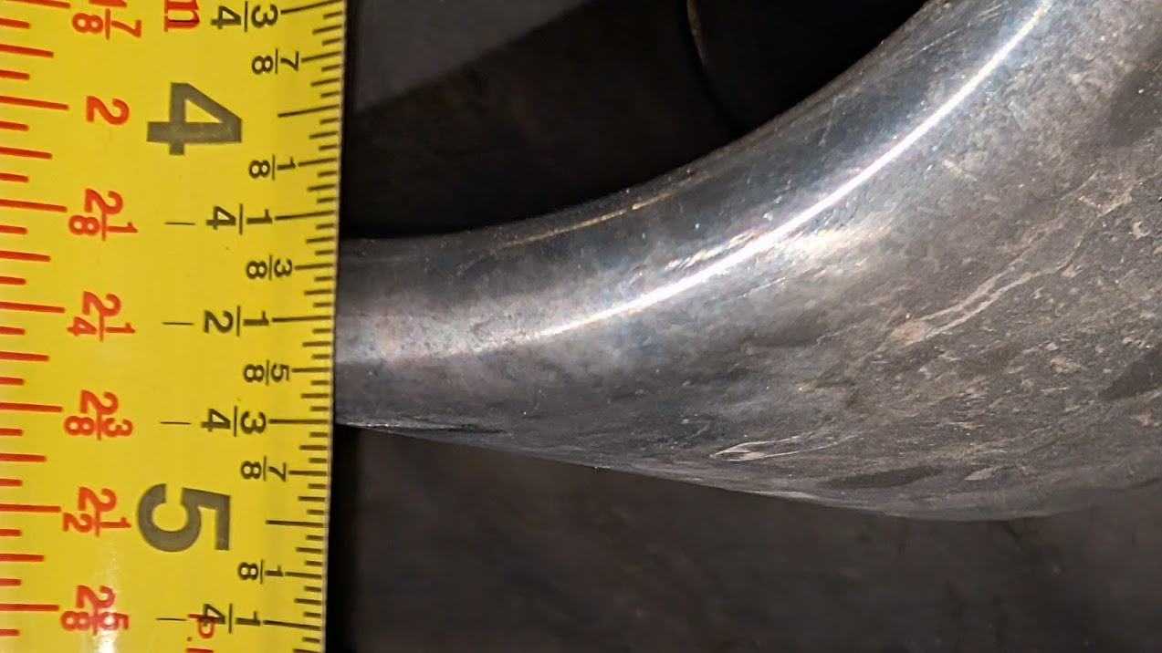

4.75" outer diameter on the A-spec exhaust tips.

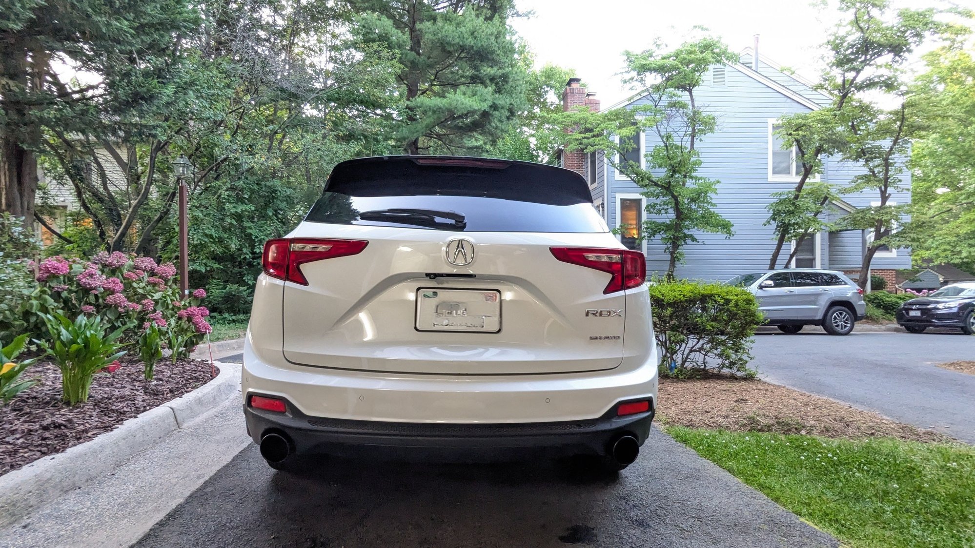

Here's what 4.5" outer diameter looks like on my 21 Advance.
The angles kind of make them look off but they center up nicely in the bumper openings.

I can't speak to that, but I measured my own car's exhaust tips to get the 4.75" outer diameter.

Just to confirm. 4" is most likely referring to inner diameter, at least on this tip. Unless, as someone else mentioned, the pre-'22 A-Spec tips were smaller overall.

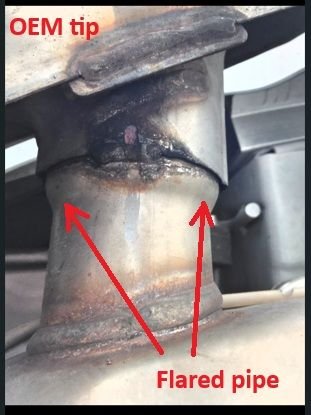

How far 'back' is the tip - I notice on my exit pipe, it looks to step-up a bit larger where the tip is slid on vs where it exits the muffler:

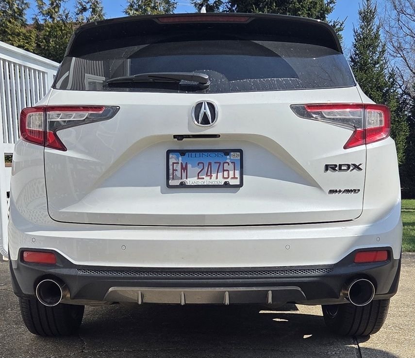

Here's my finished project. Thanks to all here who helped, provided info, measurements, etc. It's not clean but you get the idea. The 'fish-eye' aspect of the camera/lens/etc. makes the tips look sorta off and crocked or mis-aligned but in reality, they look normal/aligned.
I went with clamp on tips. As the pic above shows, there is about a half-inch deep section of wider exhaust pipe where the OEM tips mounted. Once those were removed (I had a muffler shop remove them), I pushed/slid/forced the new tips onto that 1/2" platform of expanded pipe section (which was not easy - lots of scraping/pushing/twisting), rotated them to what I thought looked the best alignment and tightened the clamps. I honestly think I could/should slide them on a bit further to tuck them 'deeper' into the bumper cut-outs but this is where I landed for now.
