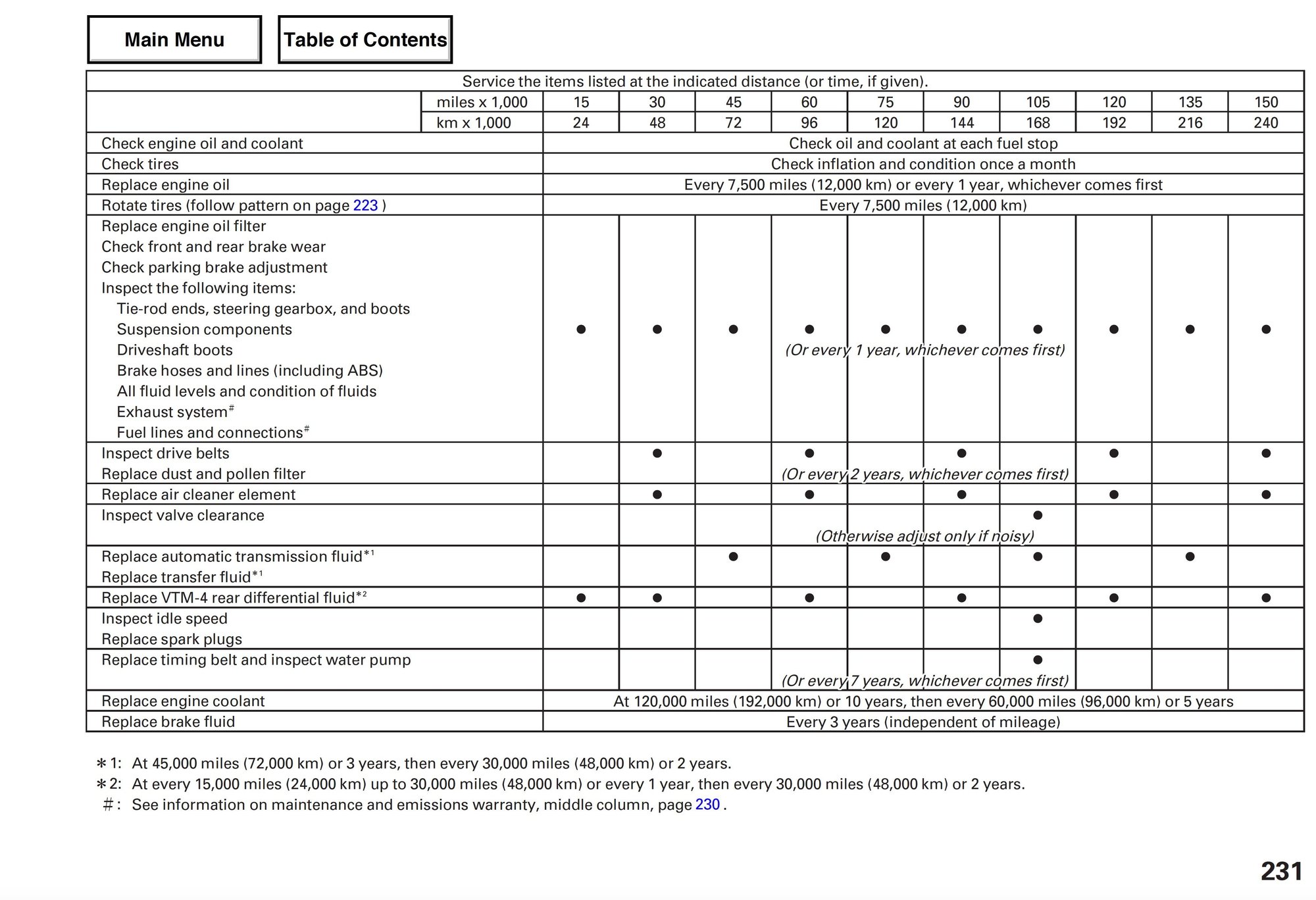

OK, thanks. Is there a detail schedule of services available somewhere?
Have not seen it based on miles, its mostly based on MID, but with my 1st gen RDX I've seen transmission fluid come up every 60-70K miles, not sure if the frequency if different for 3rd gen.
And rear differential is every 30K miles (after initial 15K).

does anyone know what the actual service requirements are and the mileage when they are to be done? I never ever ever get my service at the dealer (unless warranty) and use my mechanic of 10 years. I want to make sure that I don't get screwed in 4 years when I return off lease so would like to see what I need to do. From my experience, much of what the dealer does at these scheduled maintenance visits is visual inspections and wayyyyyyyy overpriced..
I found this but it doesn't show at what mileage to get the service done:
https://www.acura.ca/owners/maintenance-calculator
Live in Canada.
thanks
Live in Canada.
thanks
This is a mileage based maintenance schedule for 2005 MDX, one of the last years Acura published mileage based schedules. I believe current RDX is similar. You could learn more in the DIY section of the forum.
Pretty much, differential fluid change(s), ATF change, and air filter, cabin filter changes are what you're probably looking at over a 4 year lease.
