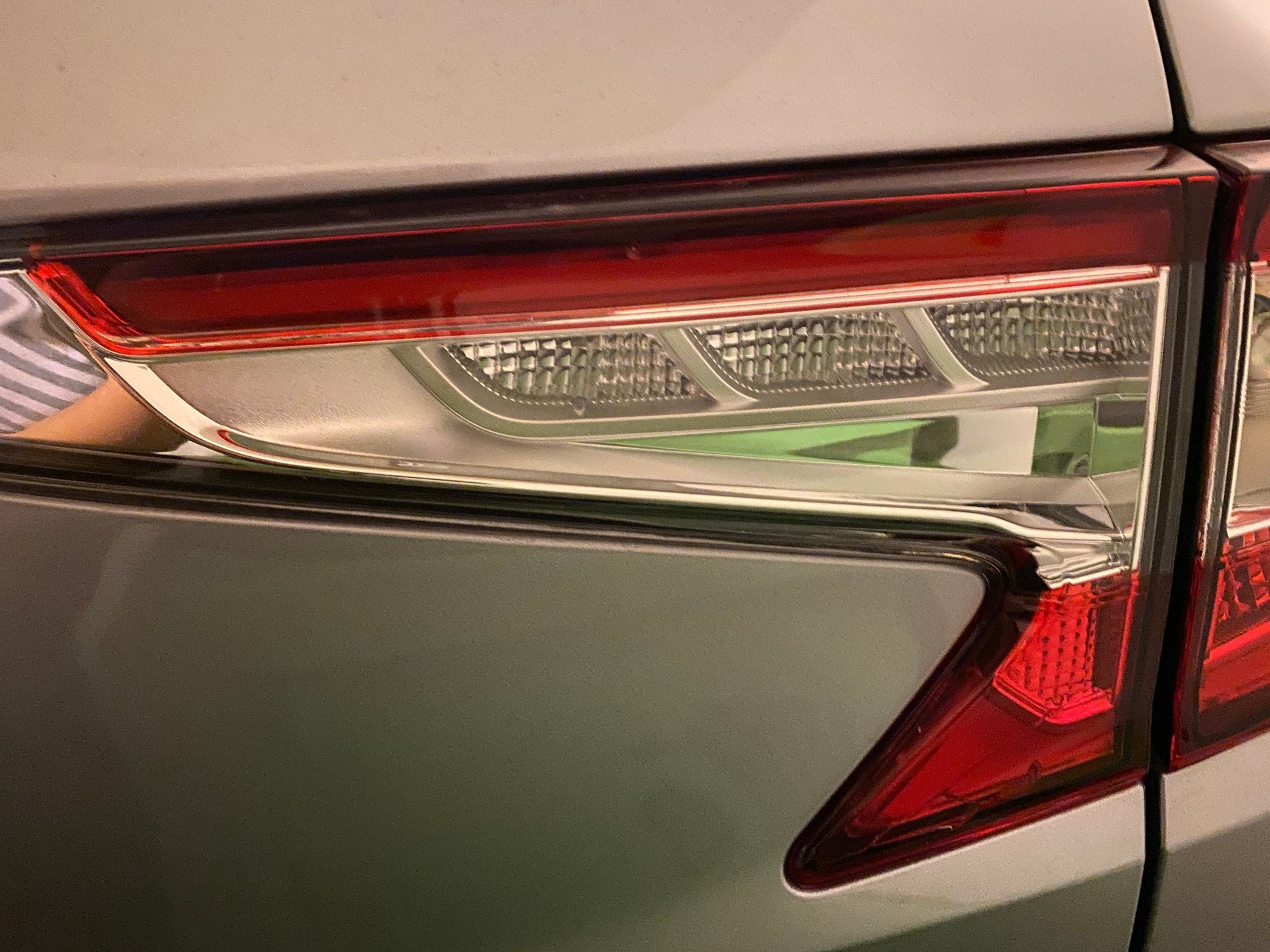

I need to replace my inner tail light assembly (I backed into a trash can in my garage lol) in my RDX 2021 and this shop is quoting me $1895 to replace it which I think is a rip off. I ended up ordering the part myself (waiting for it to come in) and I am wondering is it really hard to replace? I have a pic to show the part I am referring to. I may try another shop if I can’t do it and tell them I already have the part. The dealership won’t change it and told me to go to an auto body shop.
Bottom is cracked (red part, inner tail light assembly)

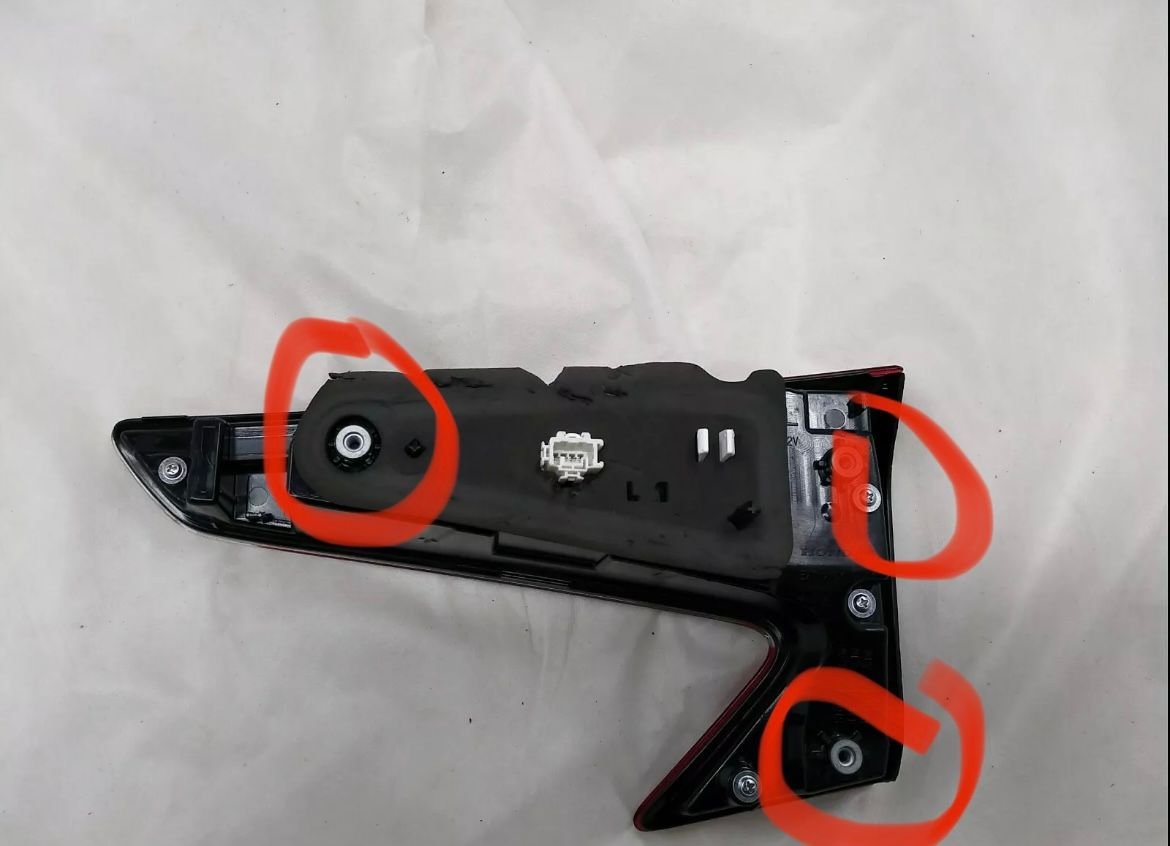

its 3 bolts and one plug
you’d just need to remove the inner plastic liner which u can do with simple amazon pry tools for $5

the hatch plastic isnt hard but ifnu search youtube you’ll find other honda installs or dash cams to get the gist of it
