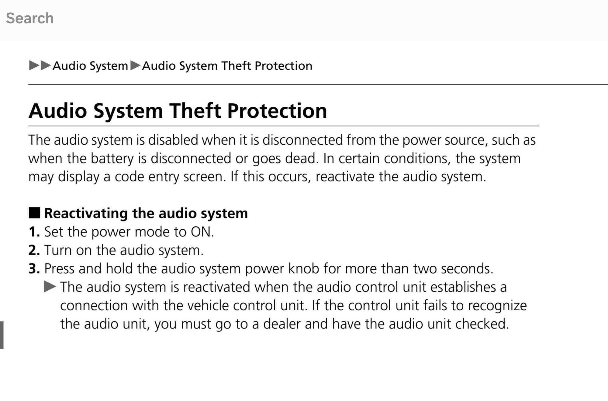

Originally Posted by RDX-Rick
I notice that you are in Canada.
If you search through the (pdf version of the) owner manual for 'immobilizer', you will find that there are different instructions for Canada for this crank but no start after battery unhooked situation. The instructions (for Canada)
Canadian models only: Apply and hold the brake
pedal before turning the vehicle on the first time after
the battery has been disconnected.
There is another section that says to push brake firmly then start button, then release brake fully then start (stop) button. I have no idea why the US and Canada instruction would be any different.

Originally Posted by faithtlx__
Hi, I wanted to ask how did you bypass the code? I cannot find my Anti Theft Code either and I had turned the battery off for like 2 minutes. And the code needed screen won’t go away from my radio.
Just push and hold the audio power button for more than 2 seconds.
That causes the radio to compare it's internal ID with the one stored in the RDX's computer. If they match, then the radio belongs in that vehicle, and it becomes unlocked. If the numbers don't match, then that radio came from somewhere else, and it will remain locked.
