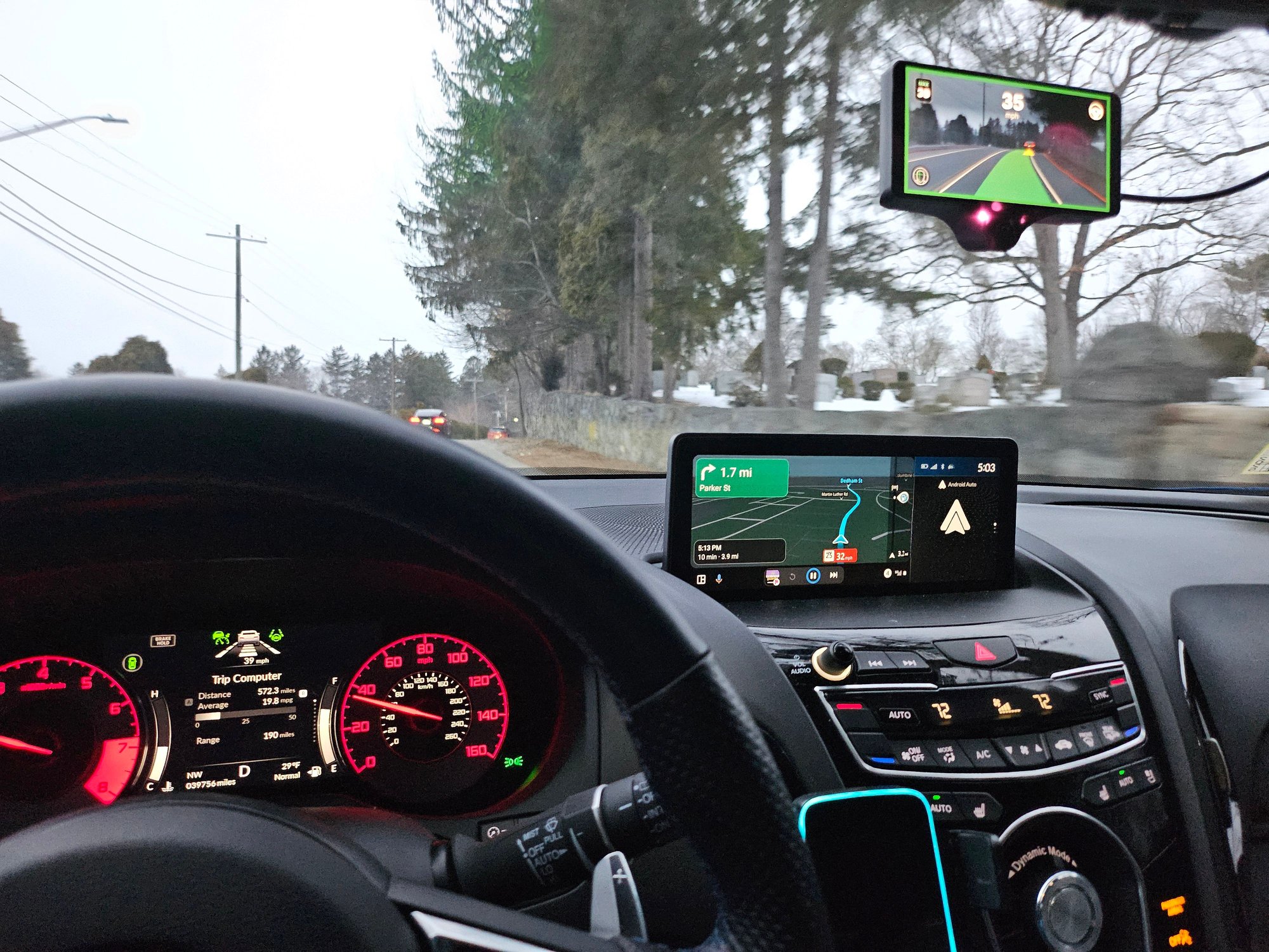

2022 RDX running comma.ai

The 2022 RDX is my wife's car so I don't have as much experience:
V0.97 (release)
- The car steers on small and moderate curves fine above 45mph, you don't need to hold the wheel. You need to override and steer yourself on sharp turns.
- The MPH screen is wrong on the 2022, should be fine prior to 2022 as Acura changed its datafeed in 2022 and comma code didn't yet accommodate
- Uses Acura's longitudinal (stop/go) ACC, so that is the same as builtin
V0.97 (my custom software build in the link)
- fixed MPH bug and fixed a bug with autodim
- Enabled experimental driving modes: longitudinal and end-to-end
- longitudinal is what we use most
----- Car can steer at all speeds for small and moderate curves, not just above 45mph. You need to override and steer yourself on sharp turns.
----- This mode disables the Radar (Acura blocks steering under 45mph if the radar is on, so comma shut it off). Thus uses camera only for stop/go.
----- Comma stop/go is much smoother than Acura stop/go, but it stops too late so I have to brake on my own often
- end to end
----- This mode reads and responds to stop signs and stop lights
----- Car drives way to slow/scared in this mode. Similar to a new first time teenage driver. Not usable.
v0.98 (my custom software in development, working on getting them to certify and incorporate it into core comma software)
- Regular mode now warns with under 45mph that you have to steer yourself
- Longitudinal mode fixed the stopping too late (Comma fixed it, not me), now works fine. This will become a non-experimental feature that all users can use.
- Haven't tried end-to-end yet, Comma claims massive improvements.
There is a separate mode where Comma built in turn by turn navigation, and the car will change lanes and take turns to follow the navigation automatically. I understand they are de-emphasing this work and focusing on getting longitudinal and end-to-end modes stable for everyday use, so I have no experience with this mode.
I'm turning all my efforts to my MDX, as my wife is getting sick of me "borrowing" her RDX to debug. Expect to get the MDX in a similar working state within a couple weeks.
Am also hoping I get good enough at coding that I can add support for any/all Acura service loaners whenever I have them. Comma's user community has very few Acuras, which is why support is below-average for the brand. I'm hoping to fix that.
