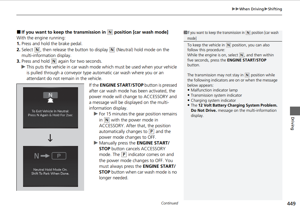

From the 2024 Owner's Manual:

You asked about the driver staying in the vehicle. Same concept. But, when the Go sign appears at the end, just quickly put your foot on the brake and press the drive button.

You probably had Brake Hold active. That negates putting the car in Neutral!

Put in neutral - when you get the green light to go at the end of the car wash, slightly having one foot on the brake very lightly (the other on the gas) push Drive - and off you will go.

Seat belt on (car could brake or go in park automatically otherwise), car in neutral to begin; lightly tap the brake pedal while simultaneously pressing the drive button and accelerate out of the wash after the dryer stage/green light.
Separately, I did learn not to use the brake hold feature right before a car wash however. For some reason the car’s system puts the car in park when you shift to neutral when brake hold is activated. I was so confused because I knew I put the car in neutral but the attendant was screaming at me as the conveyor roller was thumping over my stationary car’s tire. So then I had to frantically figure out what was happening and finally fumbled and turned off the brake hold button and pressed neutral again. Lesson learned!
