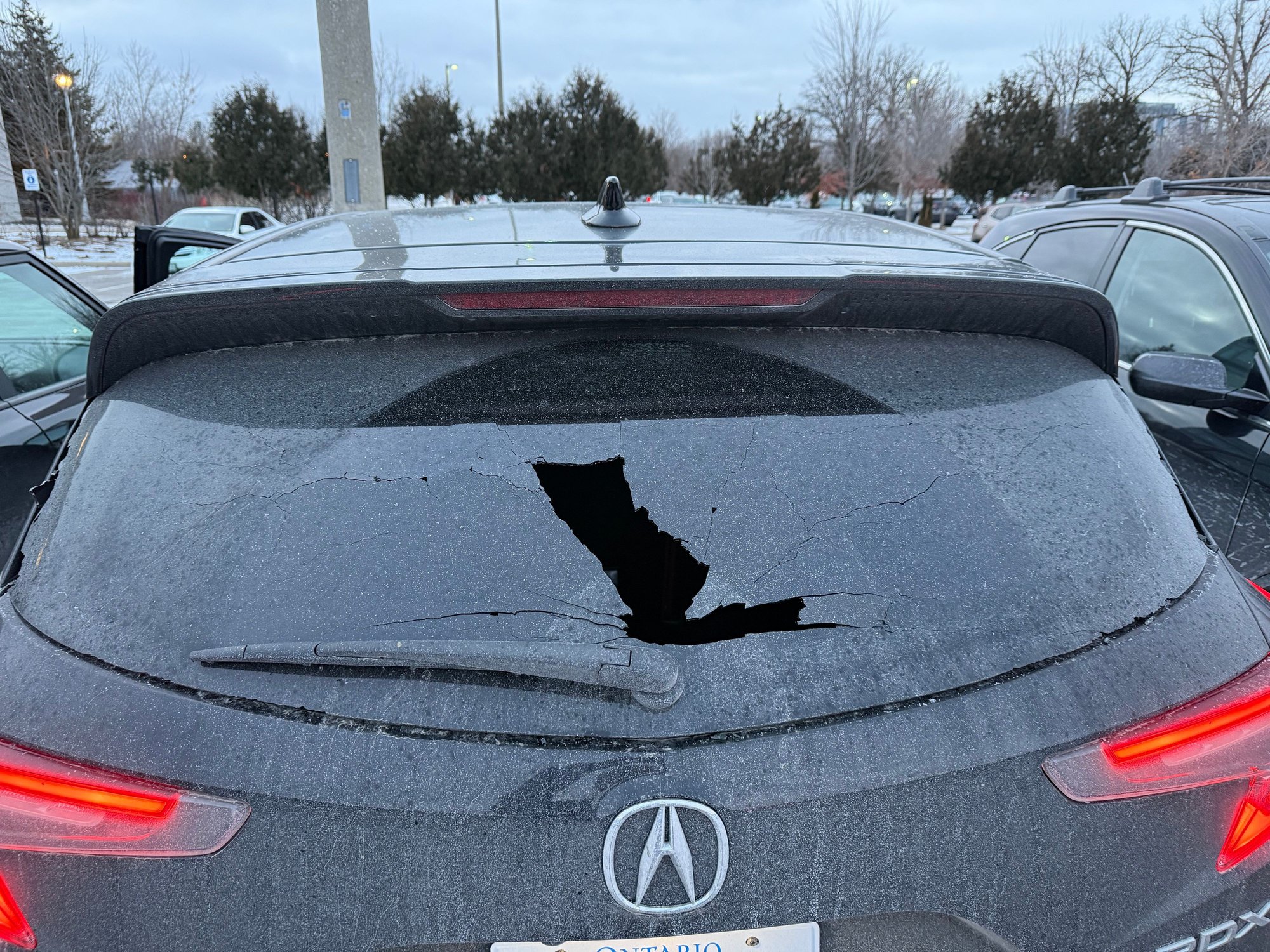

2019 RDX rear window shattering
Originally Posted by Jaidyn9
Anyone else ha e their rear window just shatter?
I got into my RDX after work, closed the door and my rear window shattered. Large hole. Was not hot nor cold out. I am in Ontario Canada
Anyone else have this issue or know of someone who has?
Woke up one morning to find this happened overnight while my car was parked in the garage...having a hard time with acura canada to fix

All these rear windshield implosions have the telltale hole that looks like the Batman logo from the Christopher Nolan movies!
How long ago did it happen? Do you mean they just haven't responded or they have said they won't cover it?
It took me 3 weeks to get a response from them (to the day) so expect it to take that long at least. If they are arguing they won't cover it what have they specifically said?
