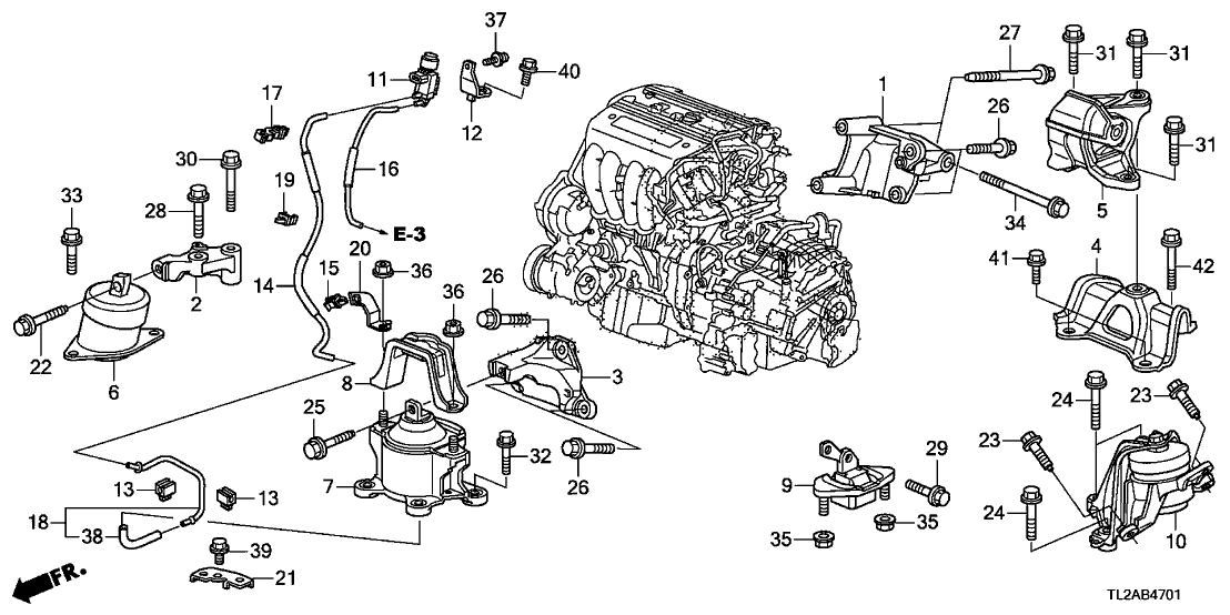

Motor mounts and vacuum control for the mounts needs to be looked at
2014 Acura TSX 4 Door TECH KA 5AT Engine Mounts (L4) Diagram
