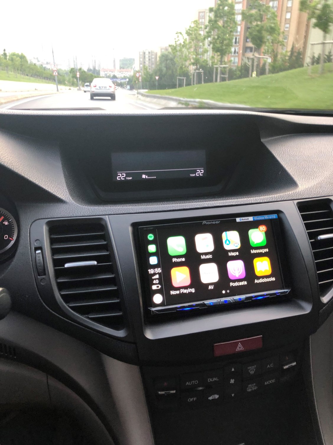

I have installed a New Pioneer AVH-Z9250BT head unit and taken the factory radio out ( i think i have the non tech package with premium audio..)

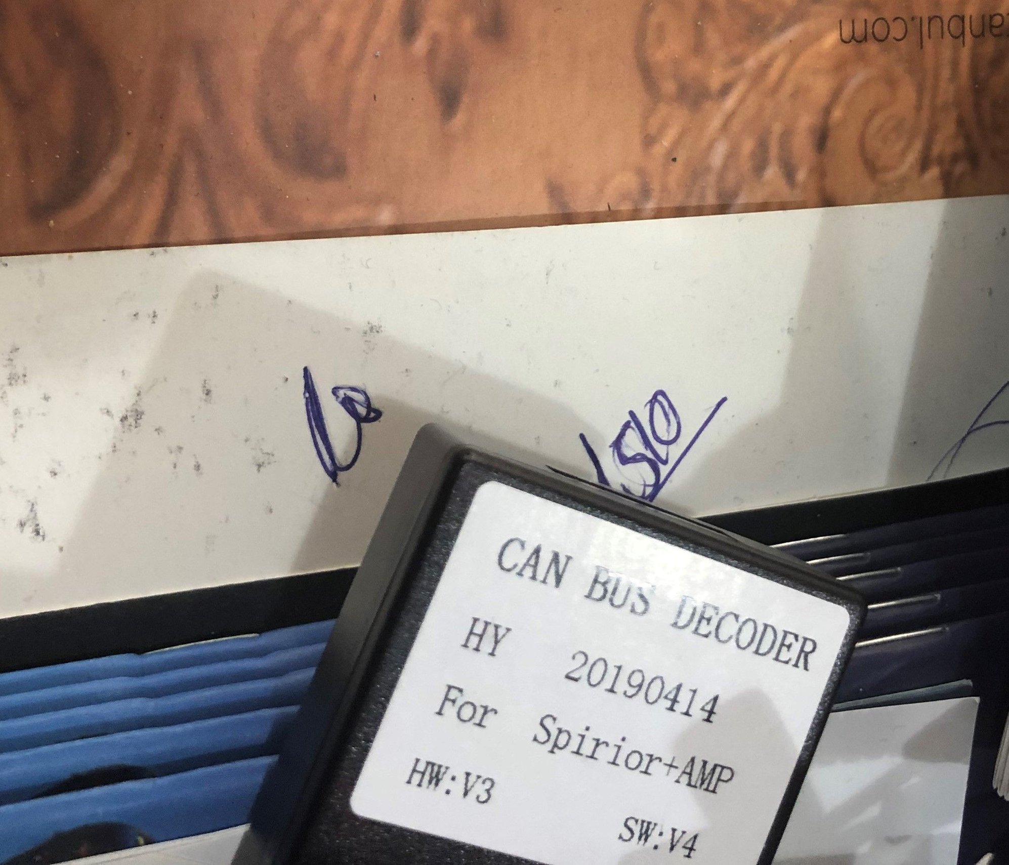

anyway the installer told me he would have everything ready to make it work and that the factory amp was good enough to give you nice clear sound with the stock speakers however for the factory amp to work he needed to install a CANbus decoder to activate the amp and steering wheel controls.

and asked if he can do a similar workaround with the PAC-ControlPro 5 (SWI-CP5)... he told me it is not possible with you head unit ... i beg to differ but i dont have the technical expertise or background to prove him other wise.... would the use of the can bus converter (pictured below) and the PAC unit together cause issues ? or is it possible to use the SWI-CP5 alone ... the reason why he wanted to use the CANBus converter is to activate the factory AMP (which in his opinion is a extremely good amp??)

That's incorrect, looking at the pics posted it's definitely a base.

My bad I thought he was referring to a center channel when he was referencing a 5th channel but now that I actually look at the pics I see it's a base model like mine. So I pulled out my factory amp day 1 and replaced it with aftermarket amplifier(s) so I can't speak with any experience about how to retain OEM amp functionality with an aftermarket HU but I did retain my factory stereo for awhile before ultimately pulling it and putting in a Kenwood DDX9903s. IF you're really considering replacing all of the audio components then you should definitely do that so you're not fussing with interfaces other than a steering wheel control. HU -> Amp -> speakers/sub -> done. The amp/DSP you've chosen is fine but you need to ask yourself how deep you want to go down this rabbit hole because if you're talking a good simple system with great sound then you can go with traditional amps (non-DSP) and use the robust audio features on your new Pioneer unit. Lastly, anything under approximately 1000 watts total power can be added safely without upgrading your alternator but upgrades are always recommended and performing the "Big 3" is a must.
