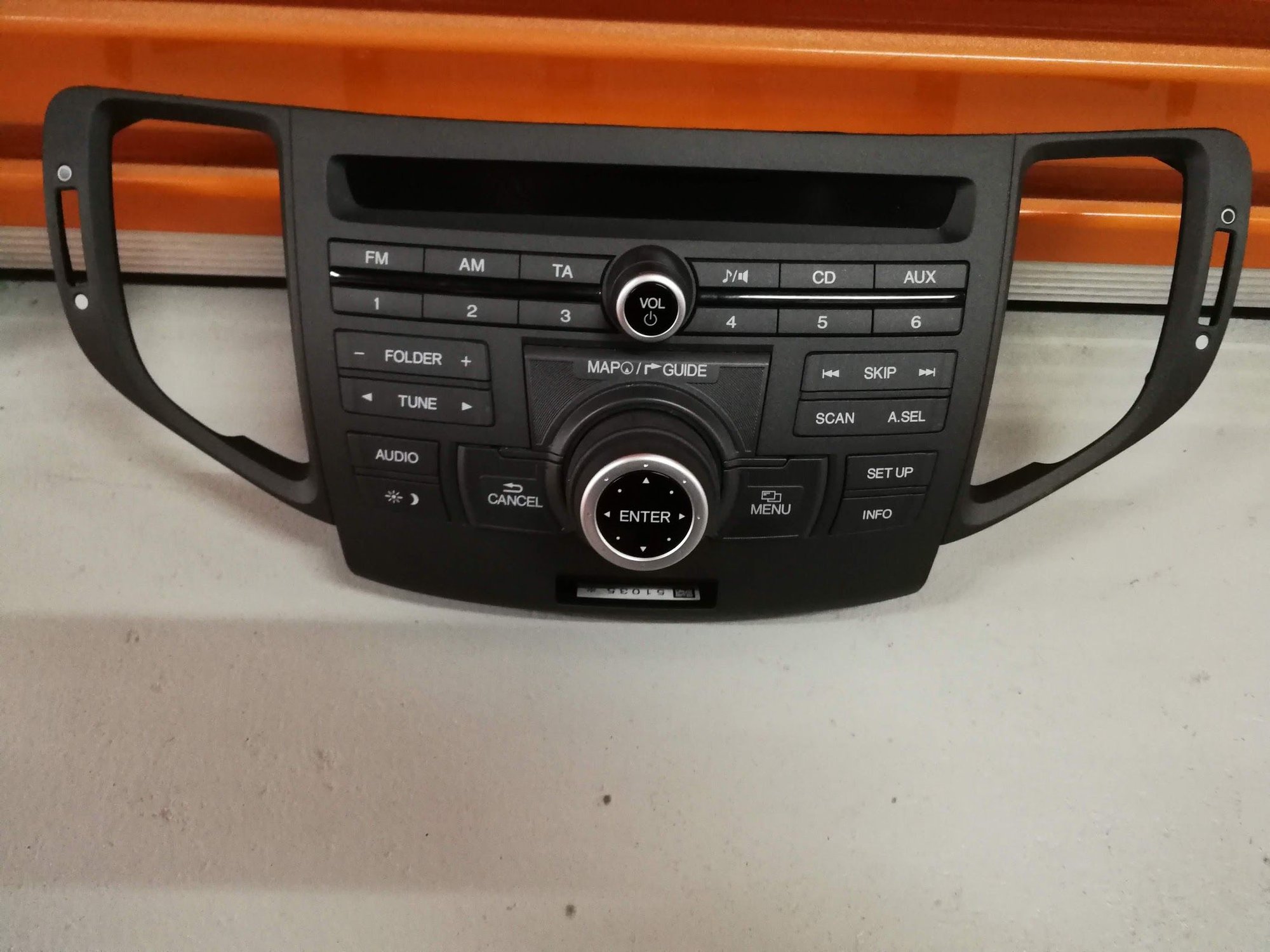

I will try and share some images of the finished product below, if that interests some. The end product is pretty similar to what you would get in a non Tech TSX model.

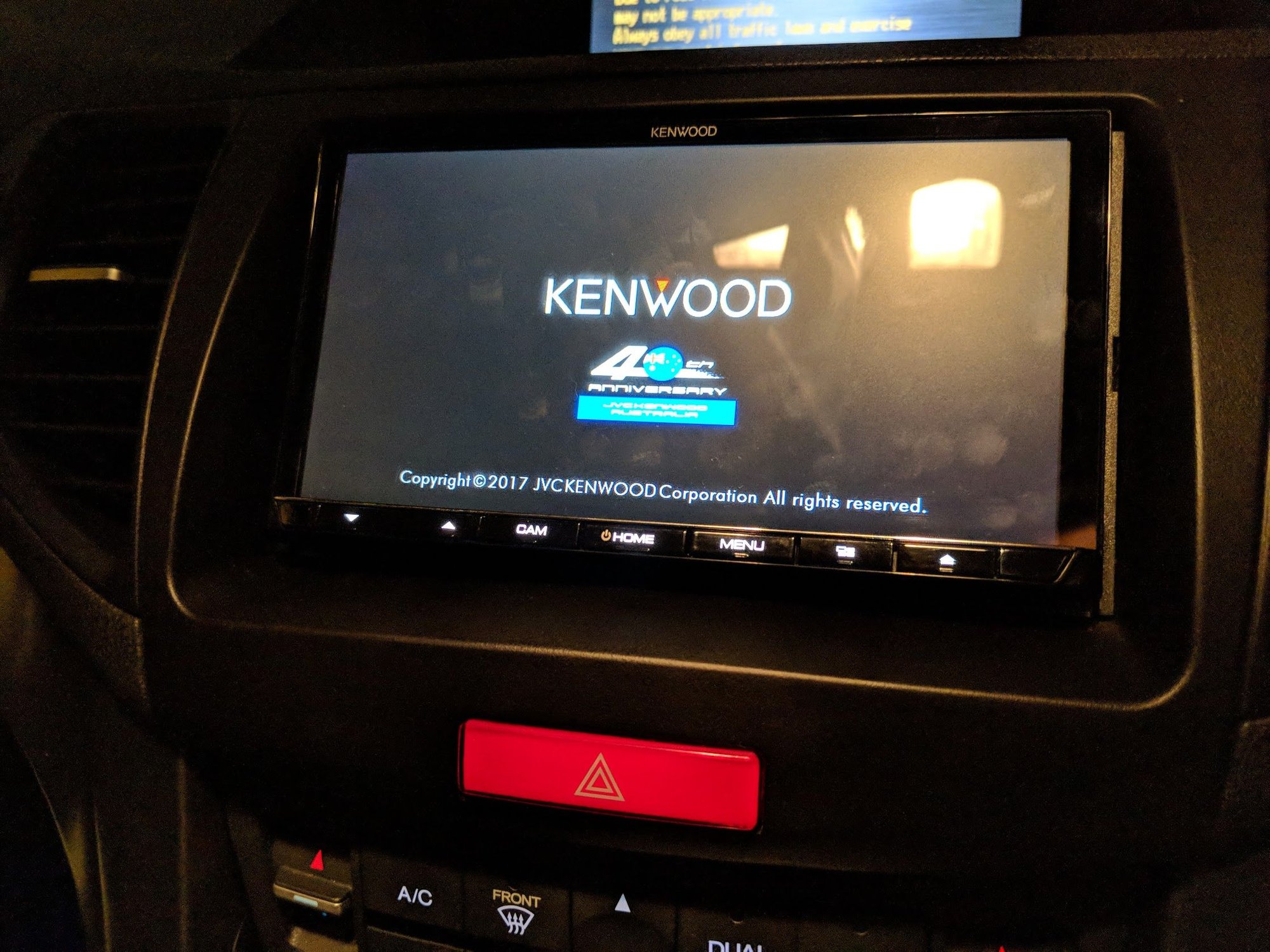

Before.

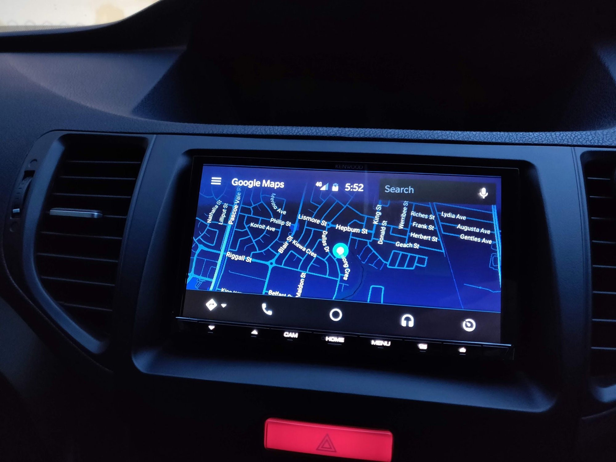

After installation. Here using my Android Auto.
Google maps
Phone dialer

Since I didnt remove the CD stacker, the top screen still comes on at engine start, and then switches off after 5 seconds or so. Plus the factory and aftermarket reverse cams work at the same. Meaning 2 pictures on 2 screens.
