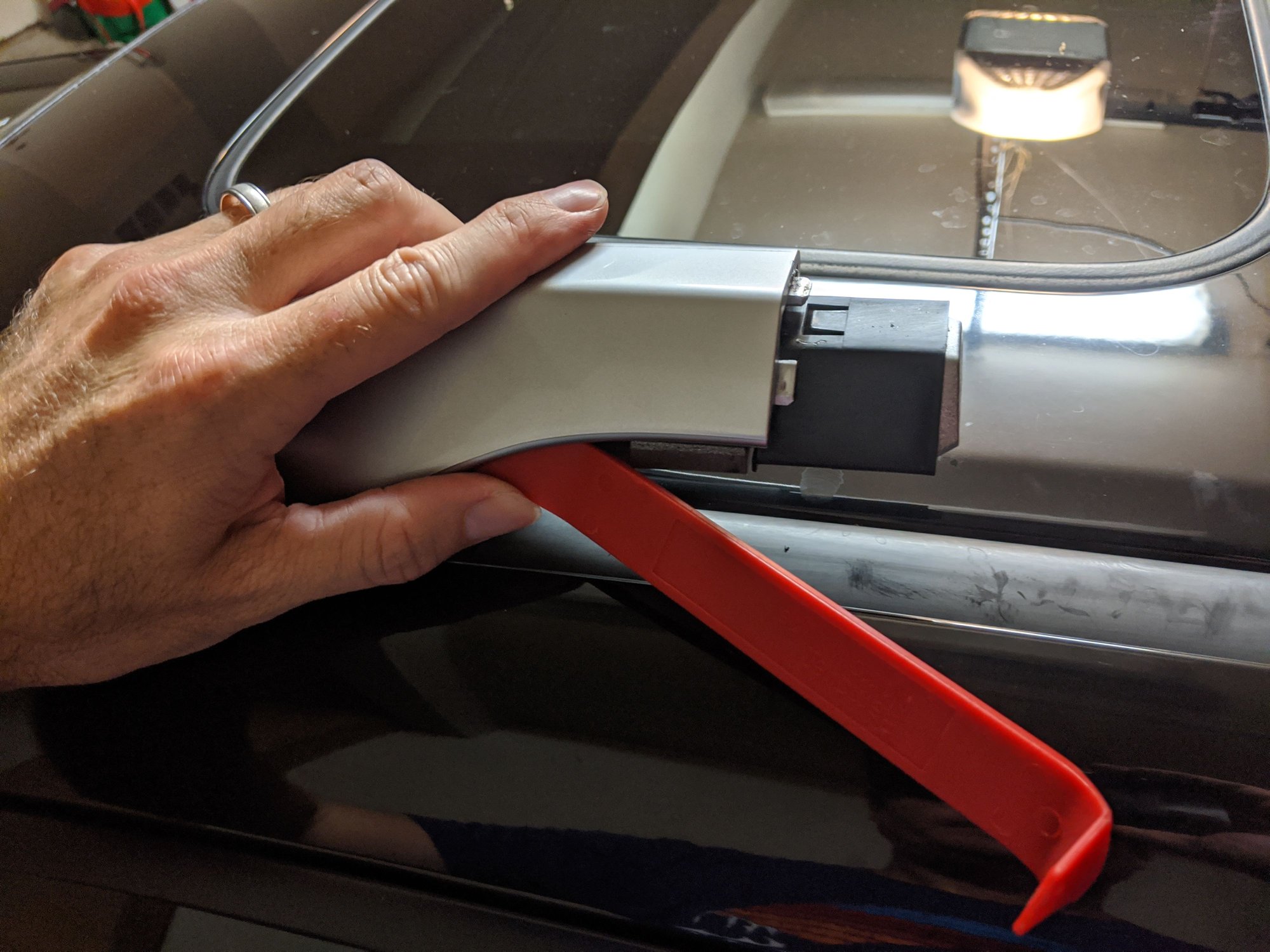

1) Start at the rear end cap (i.e. #30 or #36). The concept is that the piece is on a tab + L-slot snap. The bottom black piece bolted to the roof has the "L" slot. The top plastic end piece has the tabs. If you can just manage to wiggle it enough to slide rearward by about a half to 3/4 inch, then you can lift up and it's free. Problem is mine would NOT budge. I smacked it, wiggled it, pulled on it, pushed on it, called it names and nothing. Although the second photo is of the front end cap #28, the concept is the same. After breaking a couple, I learned the one actual retaining clip/snap in the "rearward" direction is on the very top of the rail (blue arrow below), in the crack between the Aluminum top rail and the plastic #30. Press firmly down with a small screwdriver (cover tip in painters tape) to try to depress that snap, while you again, smack it, wiggle it, pull on it, push on it, and call it names. A helper to push the clip while you do that would be huge. I was doing this at 1a.m. so no helpers.
L-slot in base. Use a small screwdriver to press down on top clip at seam between Aluminum top rail and plastic end cap (wrap in painters tape any spot on the roof rail pieces or adjacent painted surfaces where you're prying or using a trim tool). While a helper presses down on the clip with the screwdriver, you go to town on trying to slide the end cap off. In this photo you can see I've already broken the plastic snap, but the blue arrow indicates where I SHOULD have been pressing to release the clip.
End cap with tabs. Although the pic is the front end cap #28, the concept and tabs are the same on the rear piece.
2) If all that fails, use a trim removal tool or other plastic wedge to try to pry in between the black base piece and silver top piece (#30). Once you can wedge something in there, I was able to pop the L taps and lift it off. At this point the top snap referred to in step 1 had STILL not come loose, so I ended up breaking it while lifting #30 off.
The photo below is of piece #34, and it's the only one I manged to get off without breaking the top plastic snap that mates with the top clip.
3) After you've removed the rear end caps #30 and #36 take out the two bolts holding the rear mount to the roof. Now you can wiggle that black rear mount off the roof and off the end of the aluminum top rail.
4) In the center mounting point of the roof rack, you can pop the bottom black "U" piece off by prying with a trim tool on the inside between the metal and plastic. After that, remove the two side facing bolts behind the coverup.
5) wiggle the top Aluminum rail rearward until it slides out of the front mount endcap. Be VERY careful not to ding your roof with the rail when it comes loose. putting a towel on the roof or something to protect it is a good idea.
6) Repeat steps 1 and 2 again for the front end caps, except sliding the end cap frontward.
From there, follow best practices for pre-clean, tapeoff/prep, sanding, and painting. After 8-12 hours or so of curing, you can reassemble the top rails to the car in reverse order.
Reply 2
