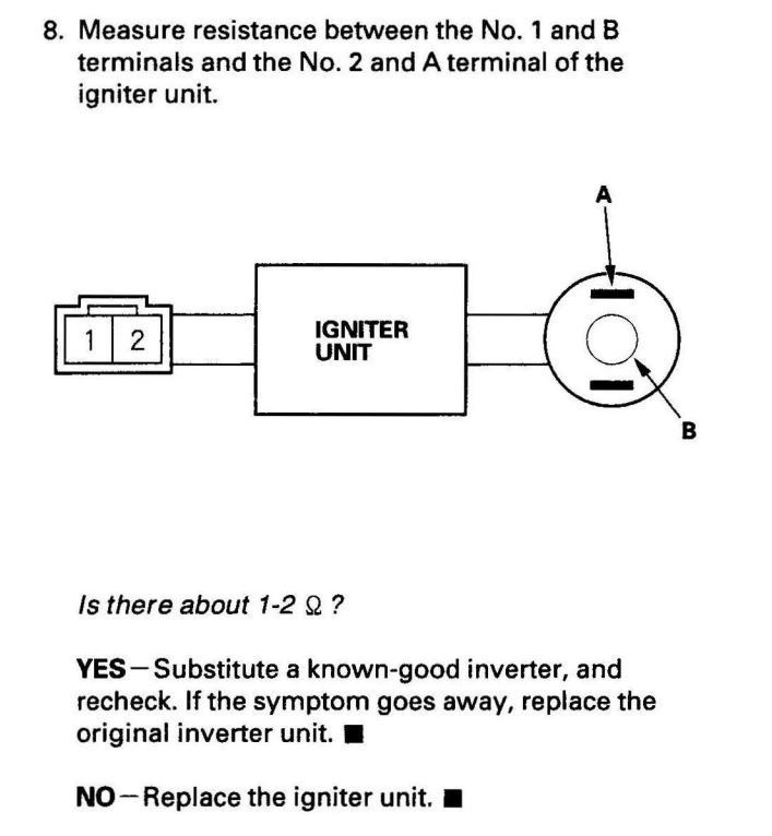

for completeness i went through the troubleshooting steps in the manual (page 22-165) and everything was fine except for continuity through the igniter unit:
So i guess that confirms i need to replace the whole assembly.
