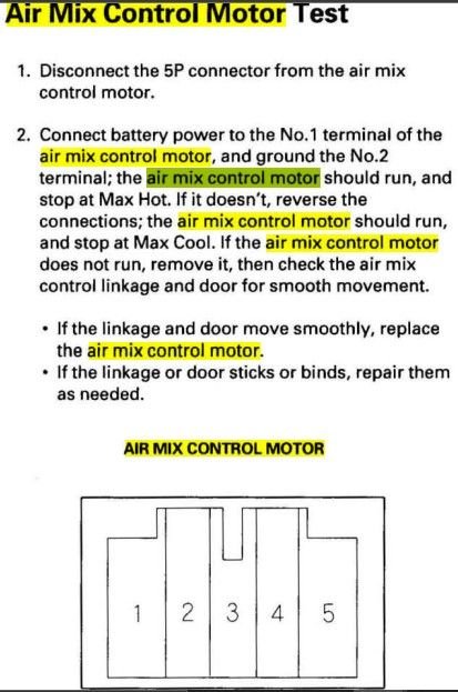

That looks like the air mix control motor assembly? Number 6 on the link below.
Heater Unit - 2003 Acura TL 4 Door TYPE-S (NAVI) KA 5AT (acurapartswarehouse.com)
Seems like something may be binding or the motor is kaput?
Below is what the Helms has on the subject if it is the air mix motor assembly:
