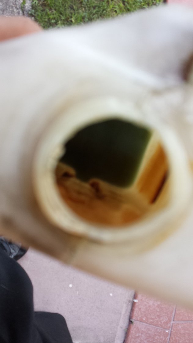

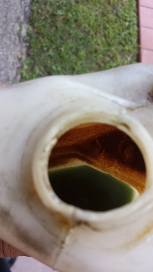

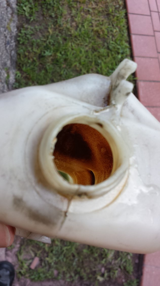

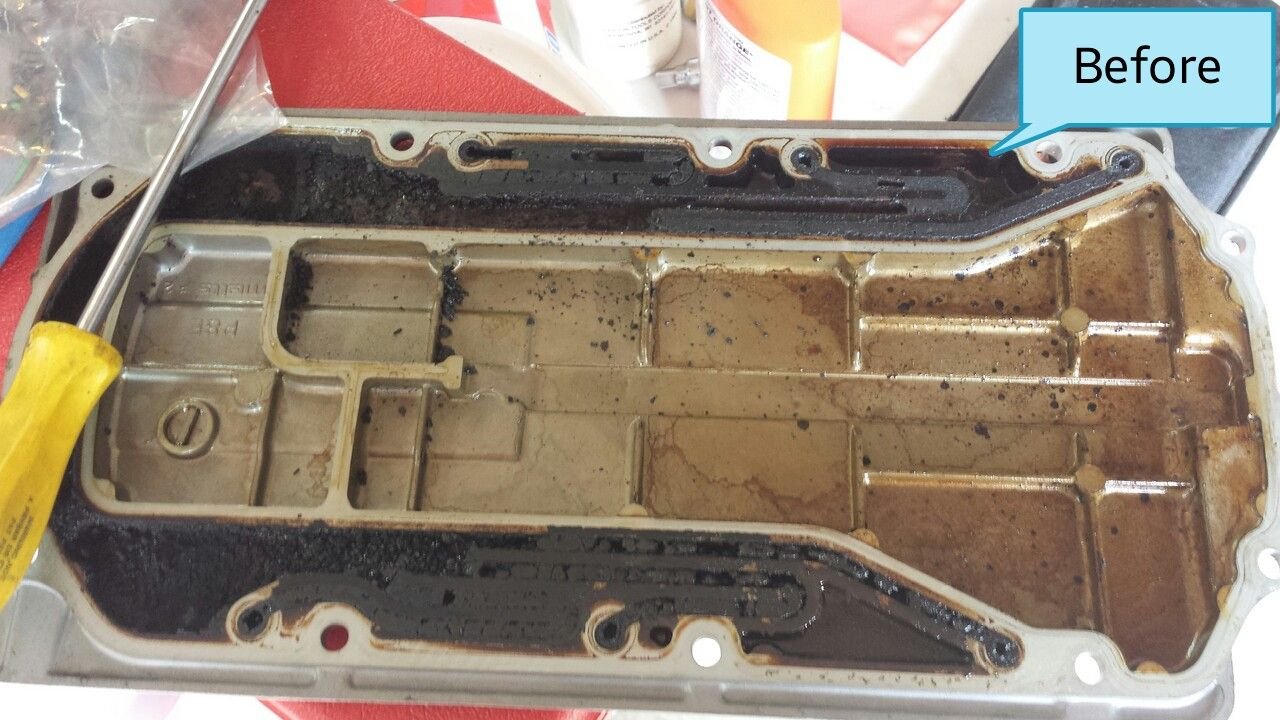

I removed my reservoir to bring the fluid level down to the cold mark (which I presume is the "Min" mark).
I took some photos for you guys to analyze. I'm thinking it's the rust that you guys were talking about. The coolant that I poured out that was near the bottom half of the reservoir had a bit of brown color to it.

Wink Coolant reservoir discolored.....
Was the coolant within the radiator discolored also like in the reservoir ?
I'm thinking it's possibly oil residue......perhaps indicating a leaky head gasket.

The fans don't work, the fans do work, now I'm confused. One thing at a time. When you have the better part of a day, use your funnel, make sure the cooling system is fully burped, watch the temp gauge while you do this, then shut it off, and walk away. Time is not critical, but give it an hour or so. Don't let the coolant get below a couple inches in the funnel as it cools. Now, have a helper crank the engine with the ignition or fuel disabled so it won't start. Have them keep the throttle wide open. You watch the funnel. If you get any bubbles in the funnel, you most likely have a blown head gasket. That's the best case scenario. It could be warped, cracked, or porous head and/or block. It doesn't matter in your case, as you've said you'll replace the engine anyway. If you have this problem you're not going to be able to diagnose the rest of the cooling system accurately. After the engine replacement keep a close eye on the temp gauge until you're sure the rest of the system is ok.
For your over-flow tank, use some toilet bowl cleaner mixed with water and some small nuts, bolts, b.b.s, sinkers. gravel, or whatever, and shake it around until it's clean. Use appropriate caution with the toilet bowl cleaner, as it's a strong acid.

the color in there suggest rad is beyond bad! and may have damage to wp as well

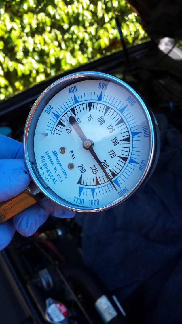

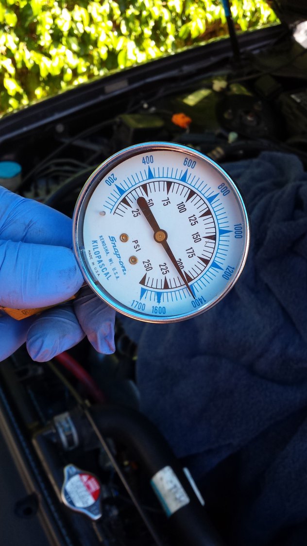

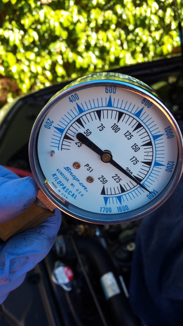

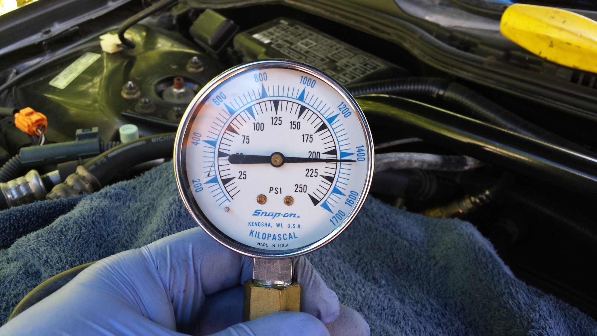

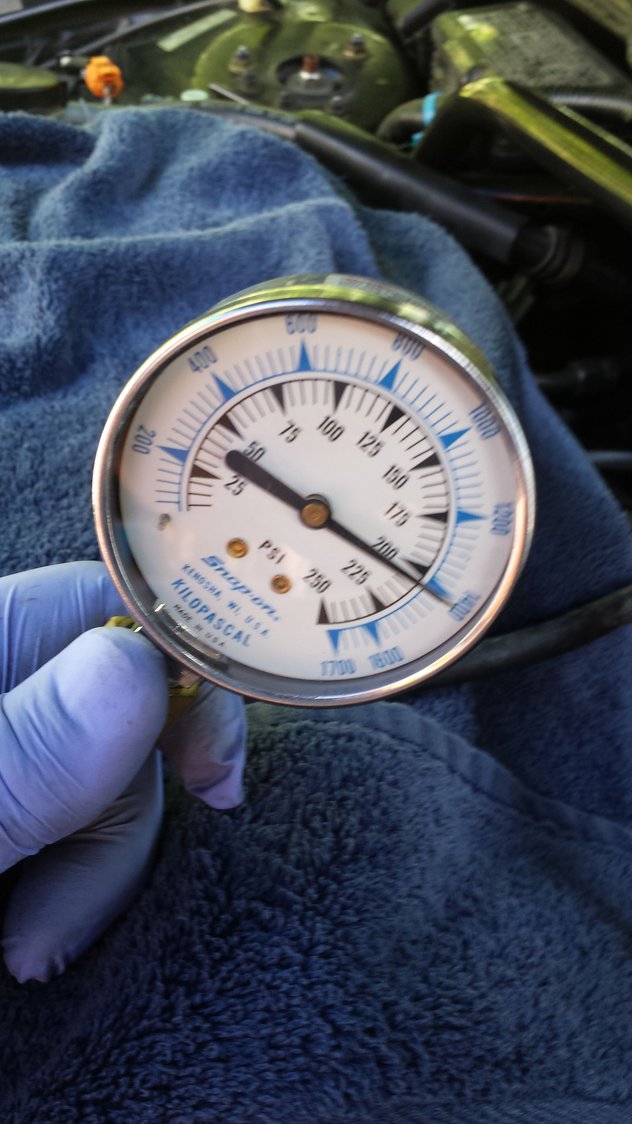

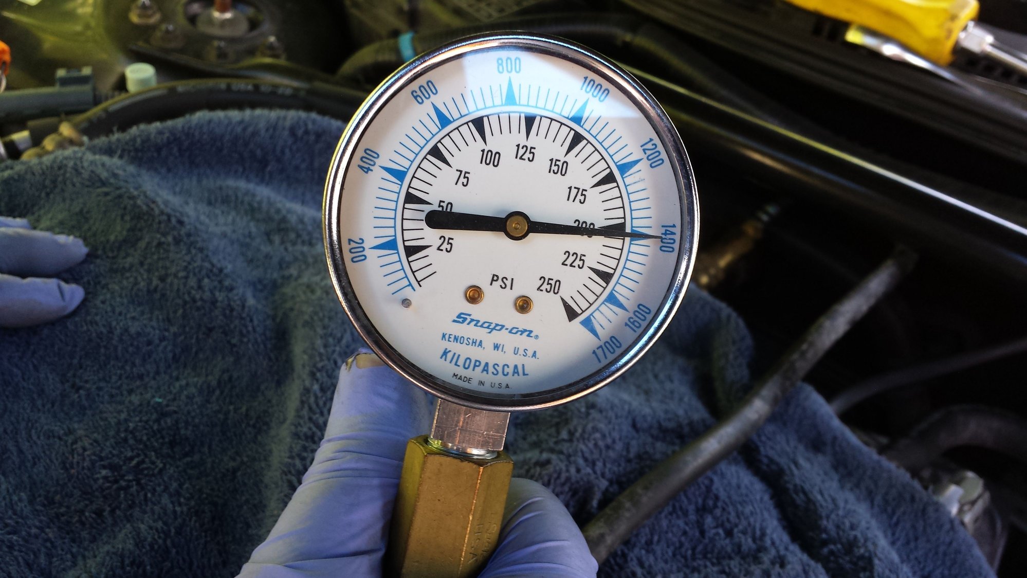

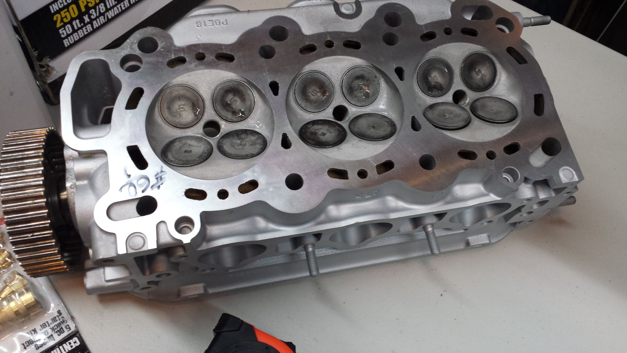

Here are the compression test results. My cousin suspects a BHG. We're working on removing the head as I type this.

My cousin saw this video and said "This sounds exactly like the problem you have. And I'll bet you that your problem is in the exact same spot that it was in the video."
Sure enough, after pulling out the new spark plugs, there was "water" (what he calls engine coolant) on the the spark plug of the ?cylinder? that had the BHG in the video.

Be sure to have the heads checked for warpage before reinstalling.

amart and others: It would be helpful to the many ziners trying to help you, -as you post new threads on what brand head gasket etc- that you mention the head was removed and found with blown out part in gasket, coolant found in that cylinder.
Mystery leak solved!! lets hope for good results with head flatness
AND as someone else mentioned in one thread- the BASE, or engine block side- needs to be ckd- with a metal straightedge- for,,,,, well,,,,, straightness! or flatness
If its beyond spec- the decision to replace engine returns
and you finally have a fun good running TL to enjoy for several years!

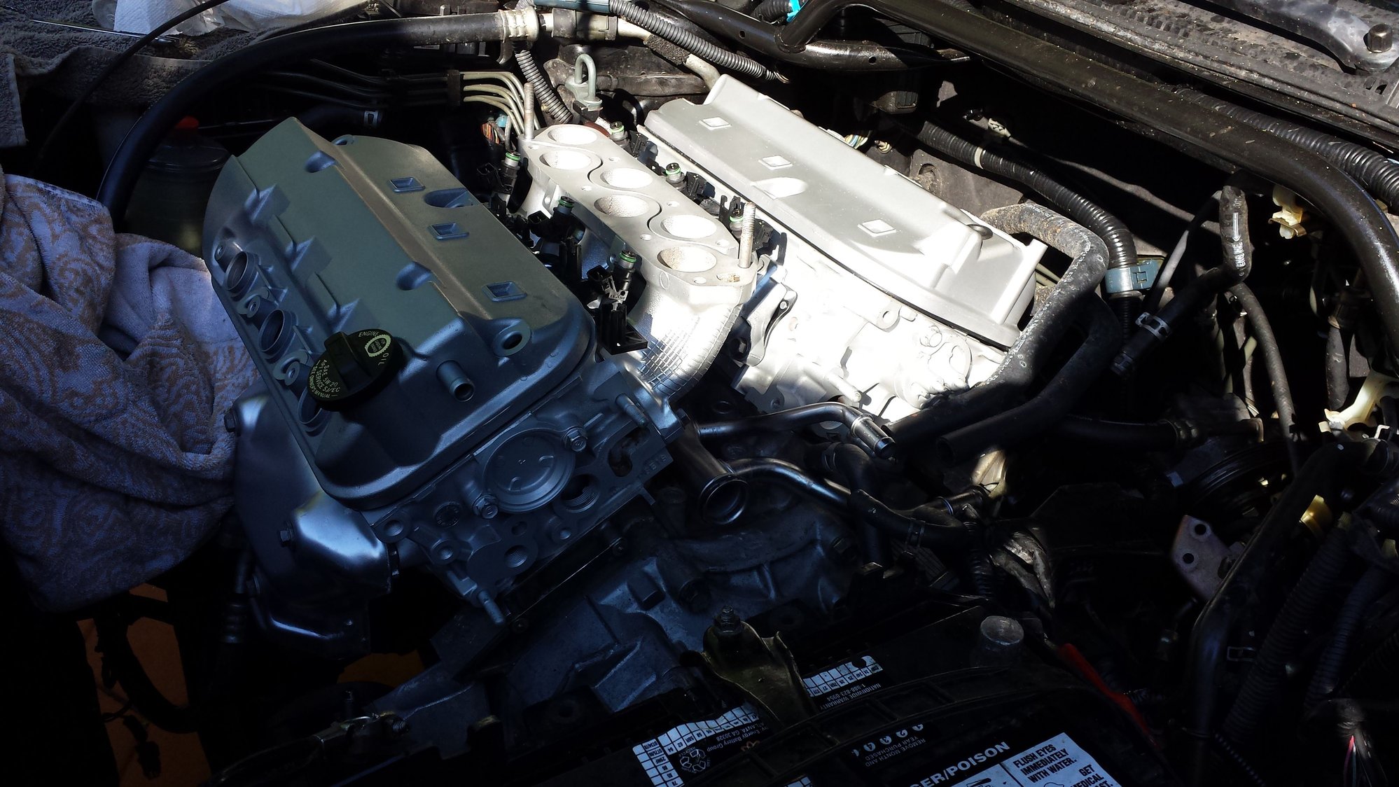

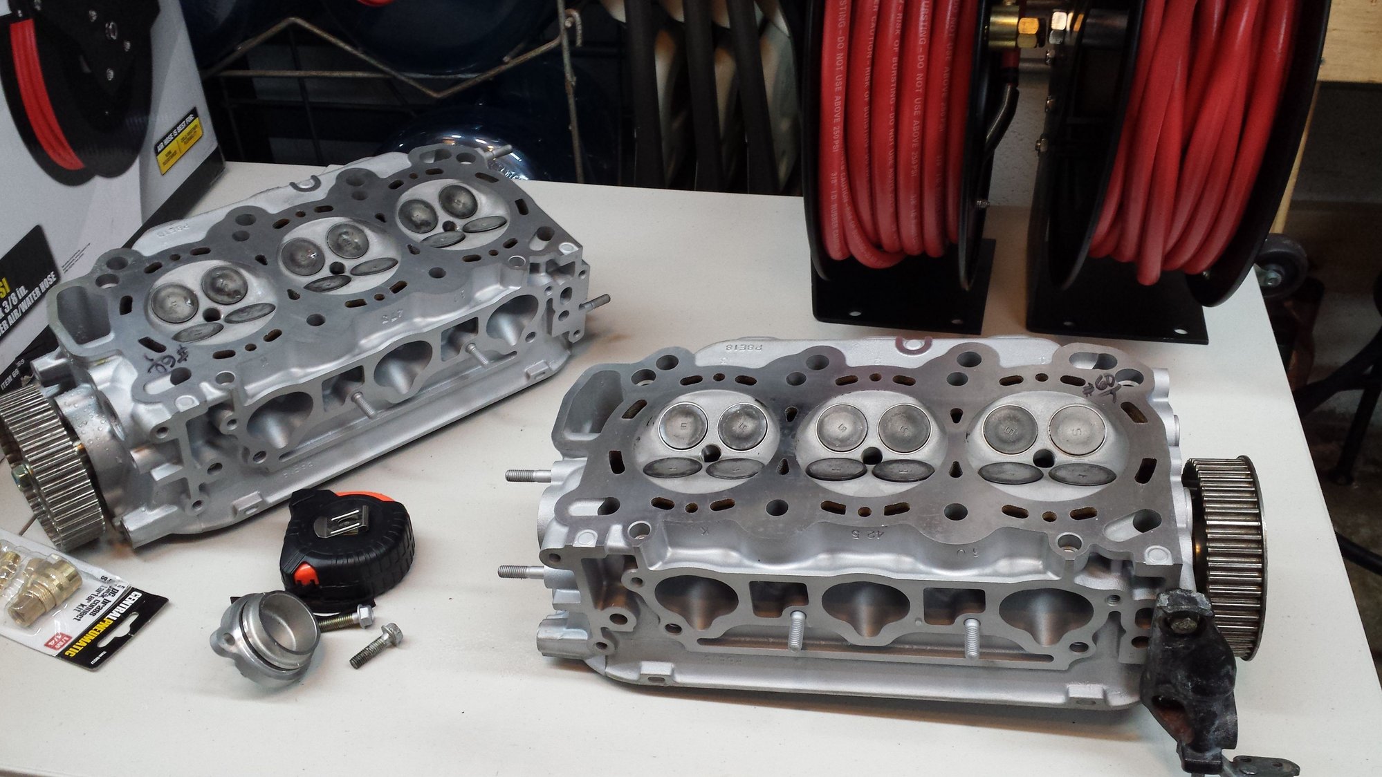

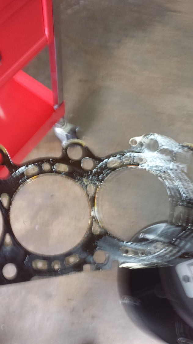

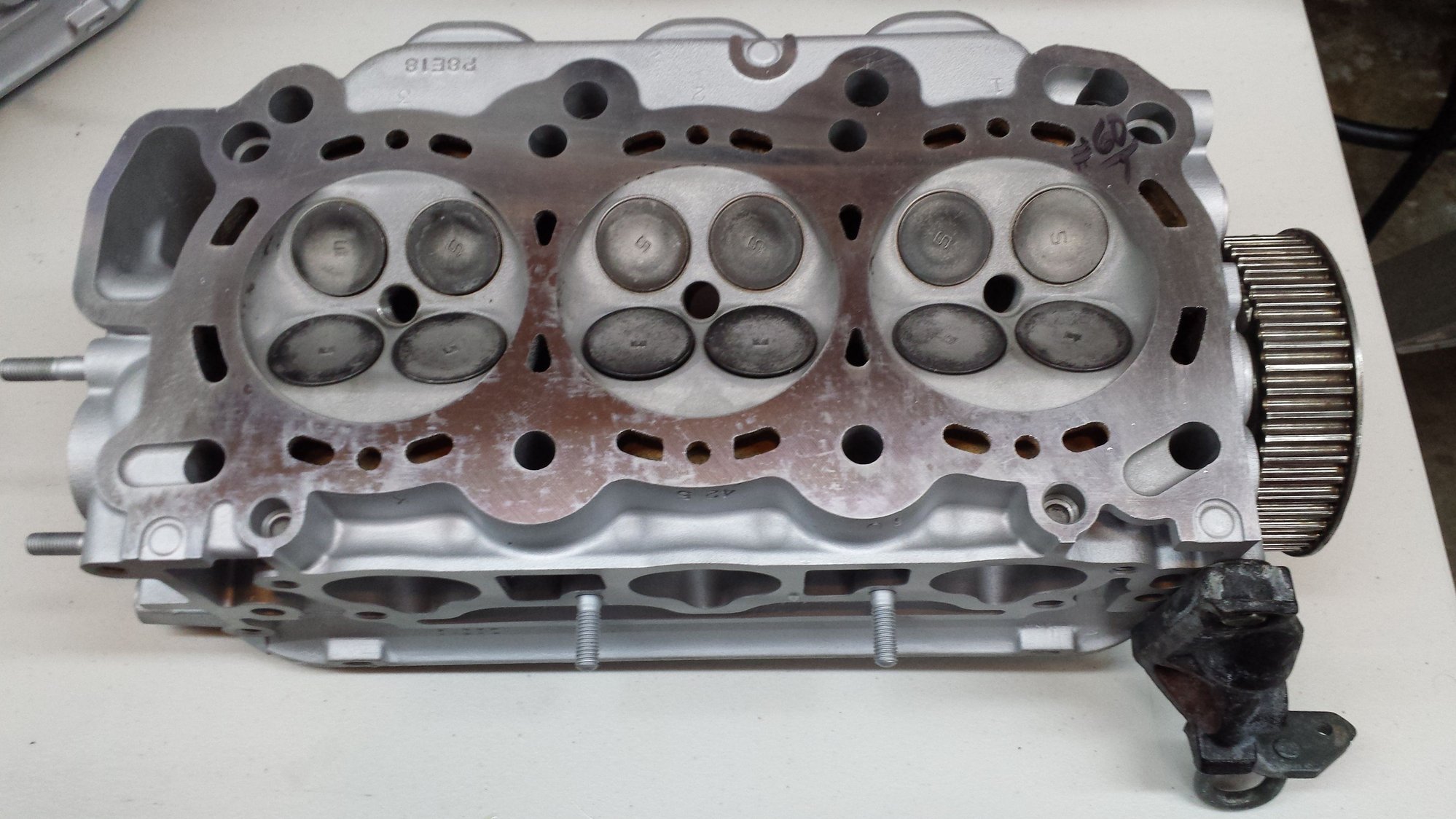

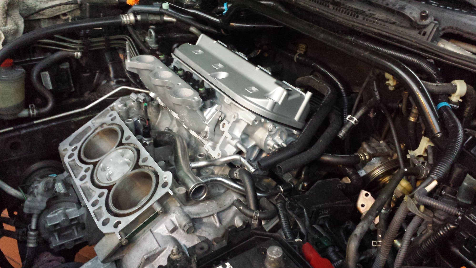

Update; this is as far as we got today and we foumd our second sign of a BHG.
Second symptom of a BHG:
Thanks for the advice guys, I'll mention it to him to check for a warped head and engine block side for straightness/flatness. Much appreciated!

its got 1 blown side for sure = head removed gasket damage found
2nd head- not yet done - not been back under hood since first one removed = from what I read
no testing of 1st heads flatness
Who wants to bet on damage to block AND heads with this saga!

vids don't like to play my computer but Im guessing those show a piston top that's very shiny from being literally- steam cleaned!
If the other pistons have flaky carbon on tops = you want to remove that with scraper and then seafoam after engine running again

Sorry for the lack of updates, guys. Been real busy and both my cousin's schedules and mines have been busy.
Here's what I have for you: the rear head gasket was bad as well (sorry for the photo being blurry).
Since both gaskets were bad, we decided to take both heads off. The heads came back from the machine shop yesterday.
We're just waiting for some hoses to arrive along with some other stuff before we begin to assemble the engine back together. While we wait for the last parts to arrive, we've been cleaning and sandblasting the other parts we took out and I've been helping him with a project regarding running pipes for his air compressor system where he'll be able to do pretty damn professional sandblasting and have two air hoses for his air tools so we can reduce switching between air tools and clean up faster afterwards.

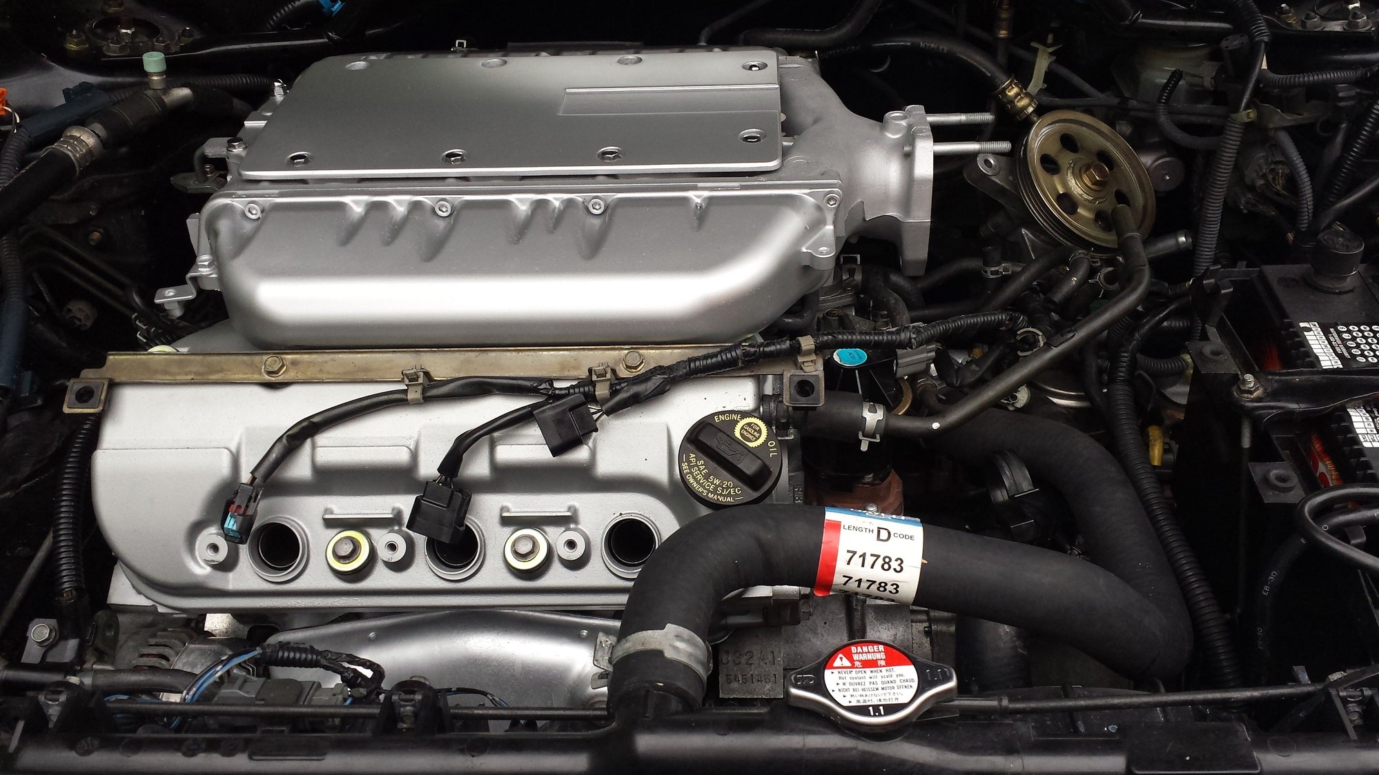

Anyway, the car is getting a major tuneup. Besides the 105k service, it's getting the drive belts done, we're putting in remanufactured fuel injectors since the old ones were bound to go bad eventually, it's also getting the brakes and rotors done, all motor mounts, transmission mounts, new air filter, as well as the fluids sans transmission fluid.
That's it for now, I'll try and keep you guys updated, but definitely expect to hear from me when it's all said and done.

Where either of the heads warped out of spec? Did replacing the head gaskets fix the problem?
Old Nov 24, 2014 | 05:16 PM
  #107
01tl4tl's Avatar
Posts: 33,535
Likes: 1,142
based on the pics those were successfully resurfaced and ready for action
In anther thread the owner of this car said they have been waiting on some small parts and doing extra work to it while things are accessible
Should be a nice ride when done,,person doing install is free labor/relative and they do some work as they can. Pics soon of another happy ziner Im sure!
He got this TL with a suspected blown head gasket and drove it until ~confirmed~
The heads were redone and the head gaskets were bad. Redoing the heads and putting im the new head gaskets fixed the problem.

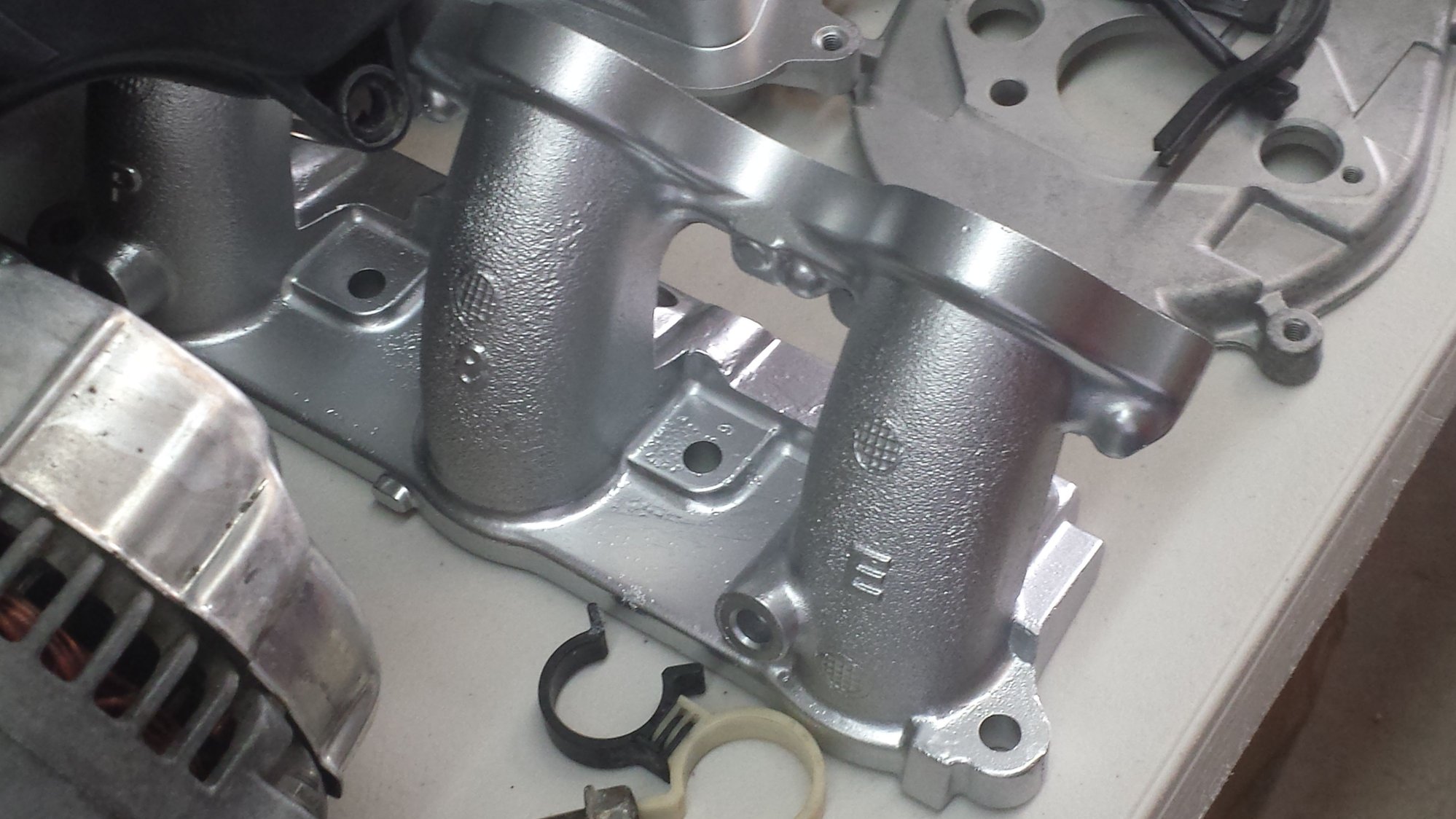

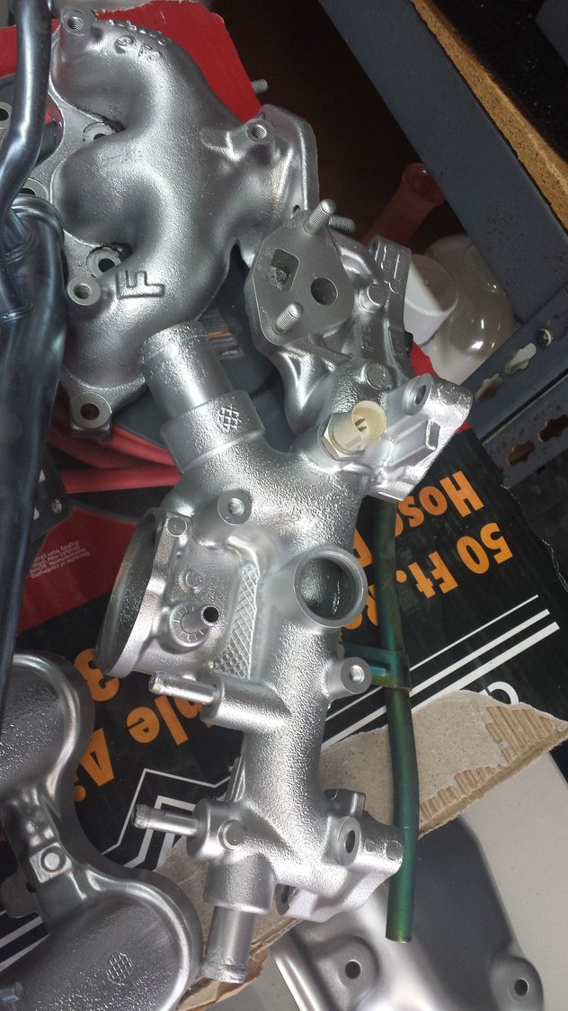

So I got my car back a few days ago and I finally got a chance to sit down and write down a list of everything that got replaced. Before anything, I just want to say that these cars are f****** incredible. My cousin was talking crap about my car the entire time, but when he took it for a test drive and floored it, he was impressed by how well these cars run and how it was able to "chirp second".
With that said, here's the list of parts that got replaced:
- Both Heads redone at a machine shop
- Every gasket and o-ring leading up to the removal of the heads.
- Head Bolts (goes without saying)
- Thermo Switch on front cylinder head
- Knock Sensor and Knock Sensor Wire Connector
- Camshaft Position Sensor
- Crankshaft Position Sensor
- Air Temp Sensor
- Oil Pump Seal
- Spool Valve Filter
- Thermostat Housing
- Connecting Pipe
- Upper & Lower Radiator hoses, Heater Core hoses going to the firewall, ATF Warmer hoses

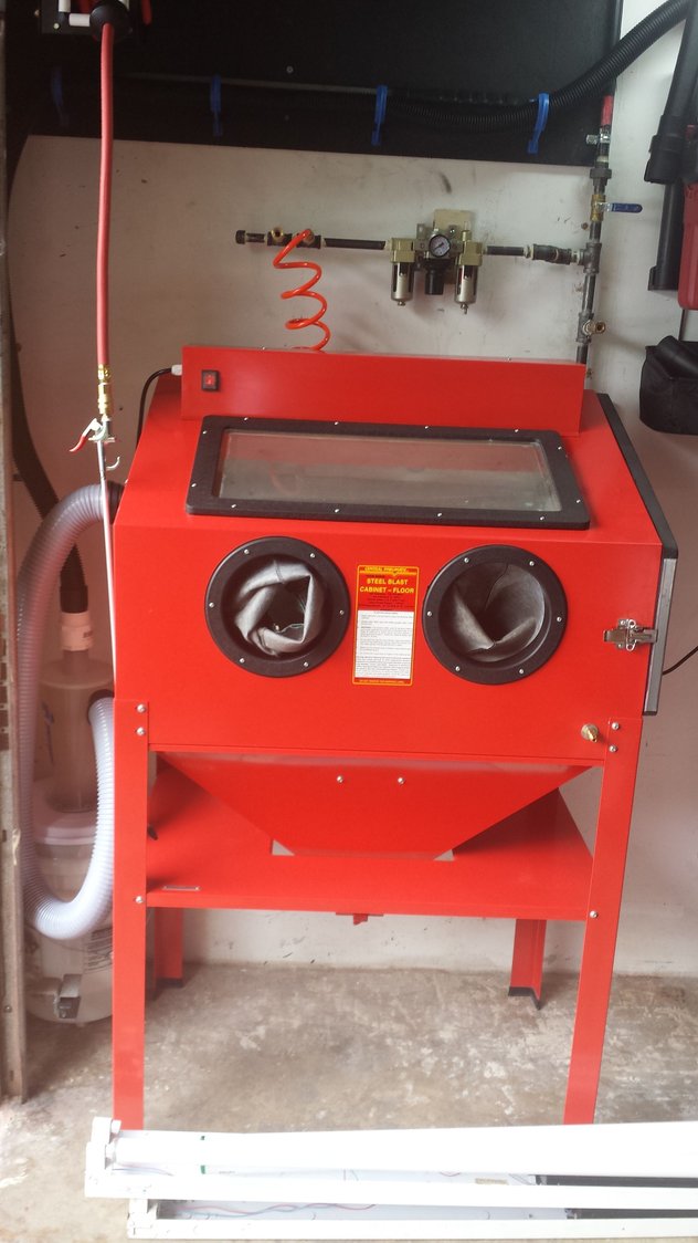

- 99% of engine parts that were removed got glassbead blasted and were repainted
Tuneup:
- Fuel Injectors including Front & Rear Air Passage Holder
- Drive belt kit
- Timing belt kit including Water Pump, Tensioner, and Auto Adjuster Collar
- All ignition coils and spark plugs replaced (this was the fix for my CEL)
- Mobil 1 Oil and filter + other fluids
- Air filter
- Motor Mounts and Transmission Mounts
- RainX Wipers and Fluid
Some stuff that went bad when the car started up the first time:
- Power steering pump
- Idle air control valve
- EGR Valve
Cosmetic:
- Painted Windshield Wiper arms
- Like-new steering wheel
The magic of glassbead blasting.
Like new steering wheel; can't tell it's used.

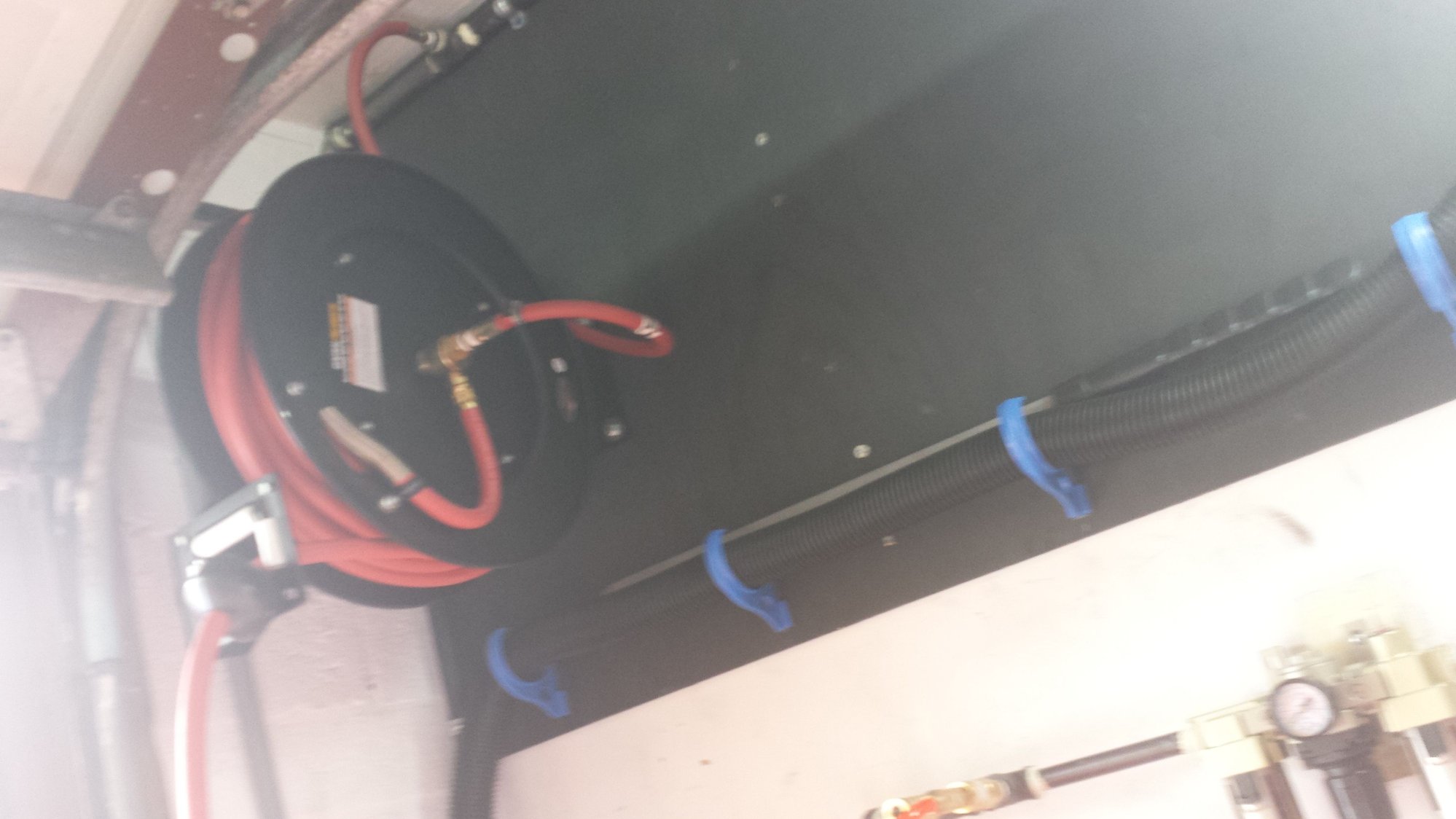

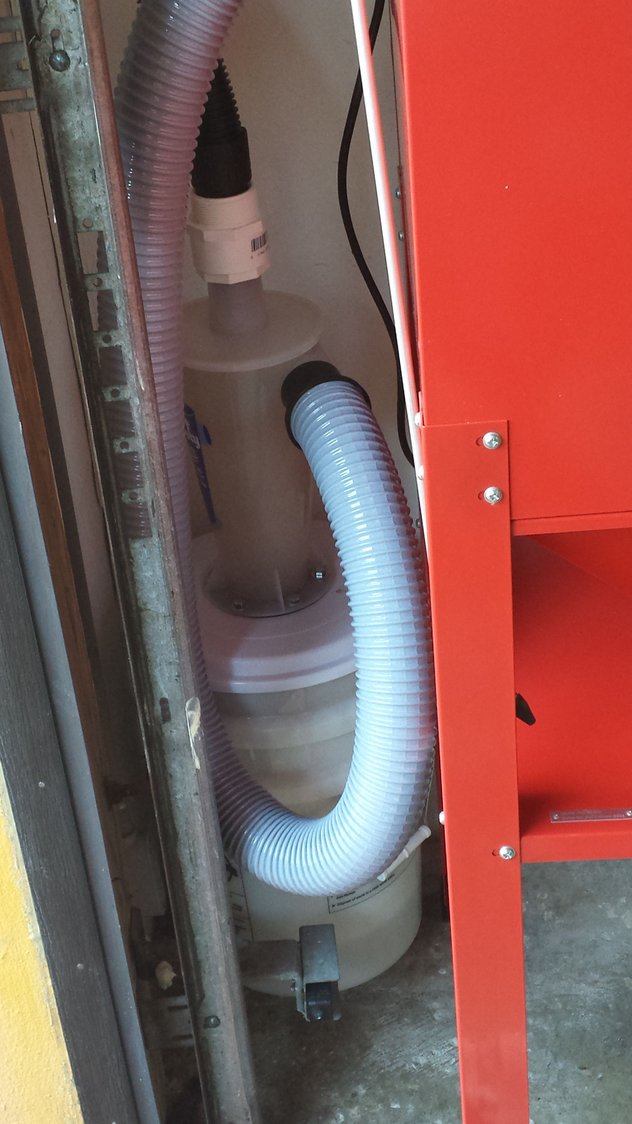

Here's the Air Distribution System project that we worked on while waiting for parts to be delivered and for the heads to be redone.

Yup, the air distribution system took the longest. Like 3 weeks. A big part of it is just waiting for parts to arrive.
