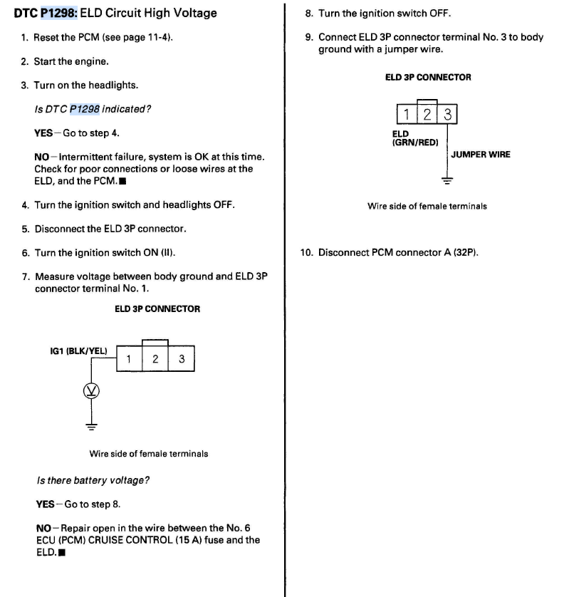

I have the same issue. Unfortunately, I haven't found a solution. Today, it gave me a P1298 code but not sure what it means. It stated something about replacing the Injector Driver Module (IDM), but can't find any video on how to do it.

Below is the page for the error code and some links to threads with this problem. You will need to start checking voltages. Check Battery voltage nonrunning, then running. Non Runnning should be about 12.6v DC, Running about 13.7 to 14.2 VDC. Check Fuse box (engine compartment). I haven't looked at them but there are several videos concerning this error code, you can google it.
