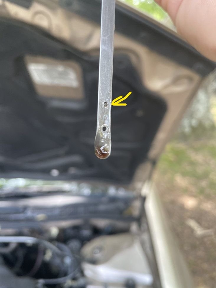

So after a good 30minutes of driving then park and engine off...this was my transmission dipstick.
Is it low or good?
Thanks for help

It appears to be at the upper mark?
With that said, the helms states, at operating temp. engine off, the car on a level surface, remove ATF dipstick and wipe, insert again.
Remove dipstick, the ATF level should be between the upper mark and lower mark.
I run my CL-S auto at the upper mark, no problems so far.
When I purchased it, the 'hot' ATF was well above the upper mark. Obviously, way overfilled. Removed the excess by inserting appropriate sized clear tubing attached to a syringe at the dipstick tube and gradually brought it down to spec.

See how there is a larger collection at the bottom and above that its barely wet. Thats my dilemma. Is the barely visible liquid valid or is the fluid level the bottom amount.

That's why it is important to wipe the dipstick, reinsert, then read the level.
The larger collection of ATF at the bottom is due to gravity.
The upper most indicating level of 'normal operating temperature' ATF, on the cleanly wiped stick, is the current level of ATF in your trans.
Adjust, as mentioned above, accordingly as you see fit.

Yeah wiped clean and checked twice. Quickly. Really no time for gravity.
Im going to add 1/3 quart and see if the bottom moves up.
If the fluid isnt low then maybe its my failed o2 sensor causing the occasional issue shifting from 1st to 2nd. Some days it never happens then others it will happen one time after initial start.

Just to clarify, when I look at your picture above I see the ATF level at the yellow arrow.
If you agree with that, then adding 1/3 quart will put you over the upper line.
If you don't agree, if possible, show where you think the level is on the picture to clarify.

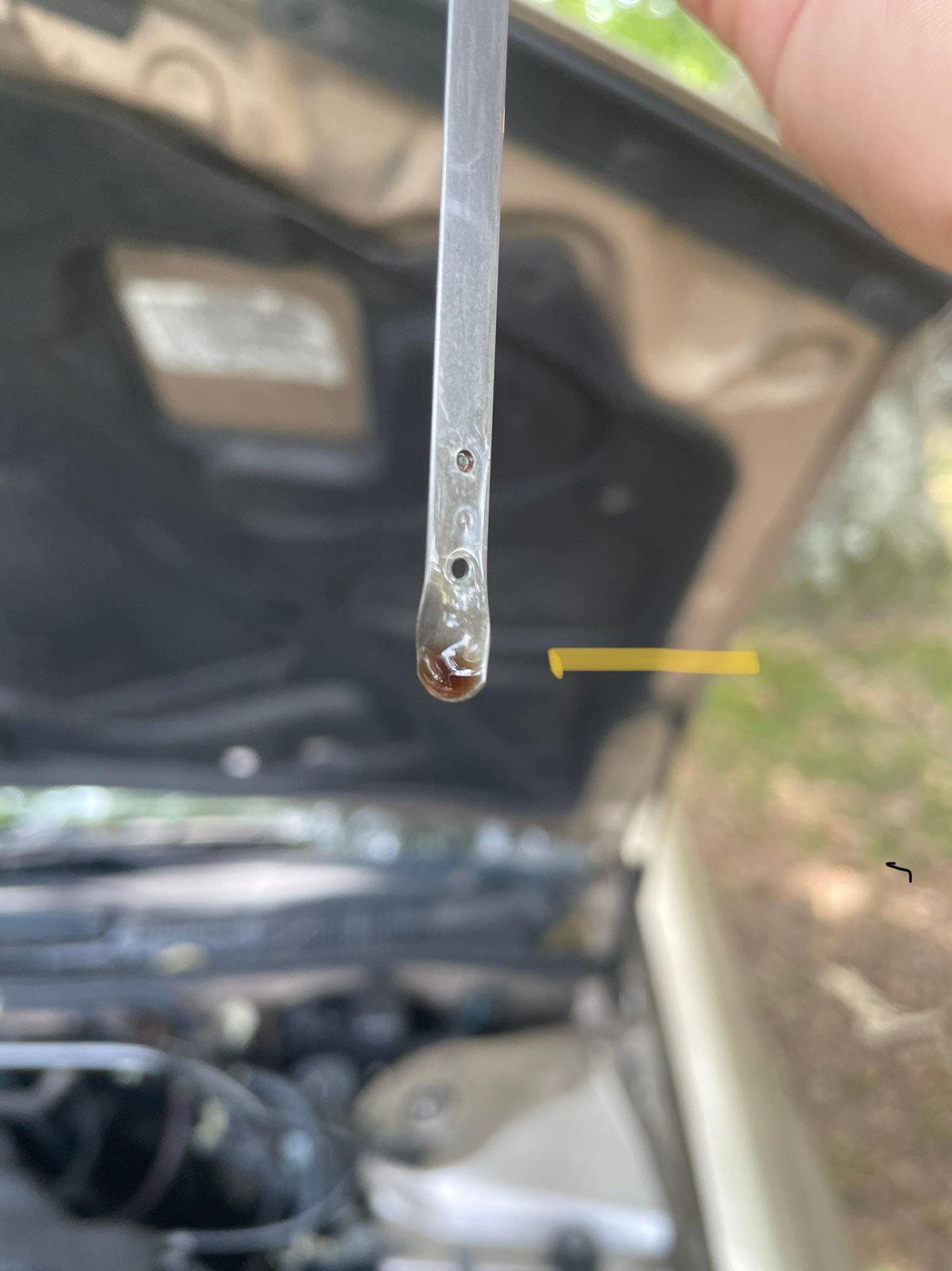

It may be here

i agree that the bigger blob is from gravity.
if it was indeed low, it wouldnt show up on the upper dot.
instead of holding the stick vertically ...you would need to immediately pull it out and hold it horizontally.

Transmission fluid is not a high viscosity oil that will cling in a thick manner. The drop at the bottom is normal and from gravity, the fluid will flow quickly. you can see the fluid in the upper hole of the stick. The transmission fluid is full. As mentioned hold the stick horizontally to help prevent fluid from dripping off.

Originally Posted by zeta
If possible, post a picture of the ATF dipstick level after adding that 1/3 quart.
Interested in seeing the result.
So you were right levels are good. Now I just need to figure why sometimes it doesnt want to shift to 2nd for a few seconds. Can go days with it shifting perfect.
