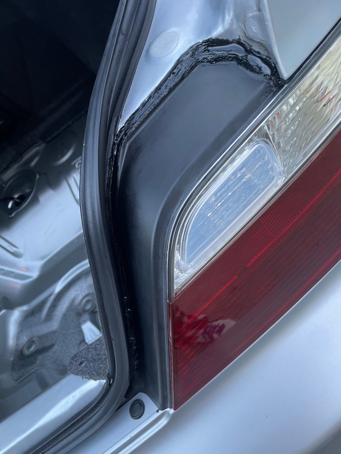

I ended up getting a bottle of black flex shot, seemed good and easy to use. planning on doing the procedure tomorrow so I will try to snap some pictures on what i've been talking about to show the process as well as how i diagnosed it. the casing is black so the caulk shouldn't stick out like a sore thumb.

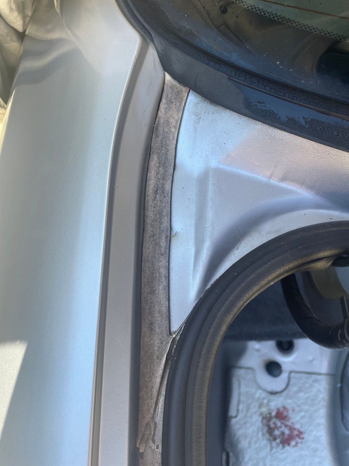

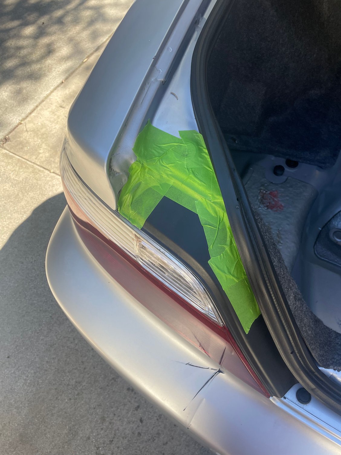

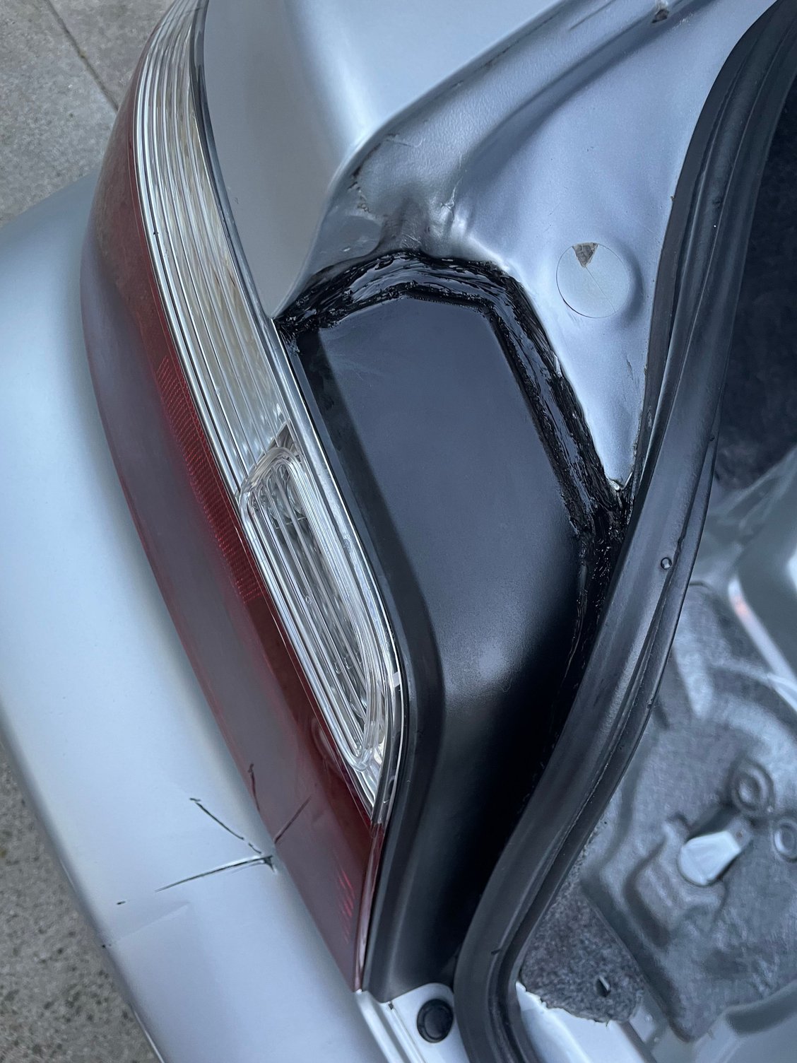

this is the the picture of the tape I had over the gap making the leak stop

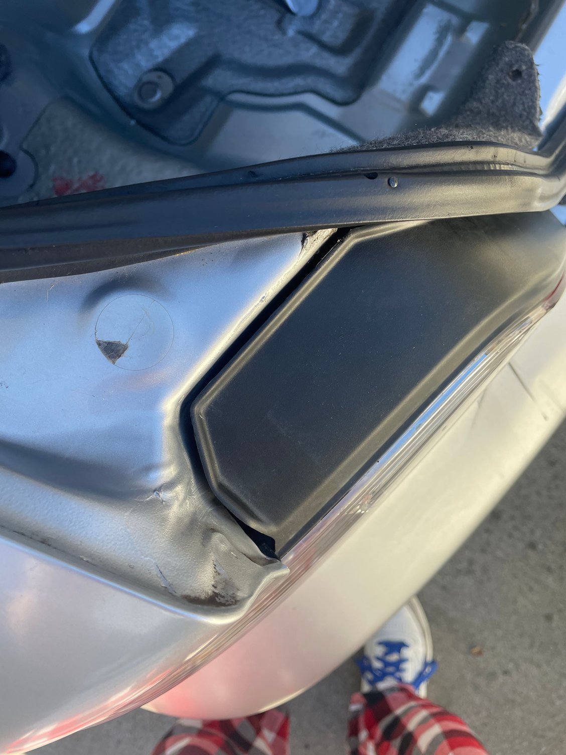

this is the picture of the gap itself which is where the water has been entering
this is a picture of another spot that has been known to leak on these cars, thought it was this at first but after taping it up my leak continued (this was before I taped over the gap between casing and frame) these tend to get old and cracked, gonna lay a line of silicone over them tomorrow just to prevent any future issues

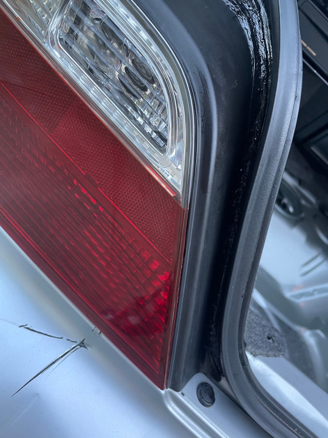

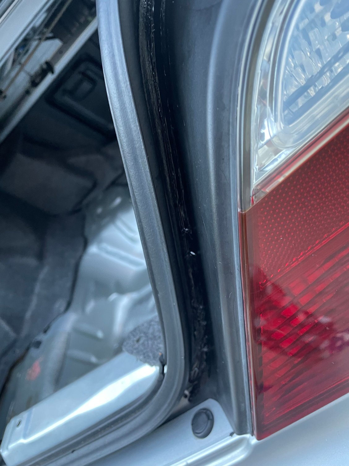

this is a picture after I finished the job (definitely not an expert this was my first time using this stuff)

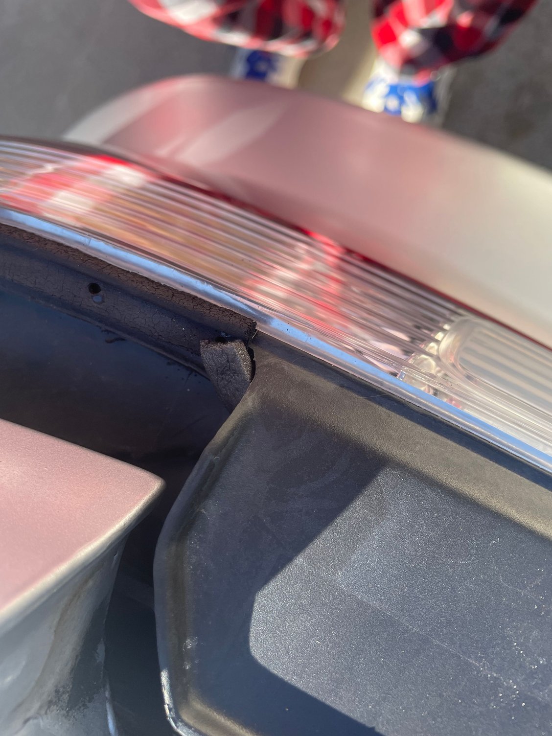

letting it cure right now (the trunk is able to be closed while I wait) side note, there gap in the corner was a little too large so I put a little piece of foam tape on each side to give something for the caulk to rest on instead of falling down into the tail light itself.

I did take both of them off, the gasket was slightly deteriorating and there was stuff in it as well as water, I took some compressed air to it to get most of the gunk out of there. I also replaced every single bulb in my tail light the day of sealing them up to ensure if or when I do need to remove them, it won’t be for a while. coincidentally all my bulbs burned out back to back within a 3day span so the timing was nice. gasket or not, I believe that the gap between the casing and frame is a huge flaw that regardless of replacing the gasket would still allow water to get In whether it’s in the electrical side or into the trunk, not to mention oem ones are currently on back order with no eta. I would rather no water enter in the first place, so this is the steps I took. first car wash down trunk is drier than the Sahara.

first car wash down (and I sprayed plenty of water over the trunk and window) and no leaks. you can see especially with the soapy water how it just flows straight down the trunk channels and out over the tail lights.
