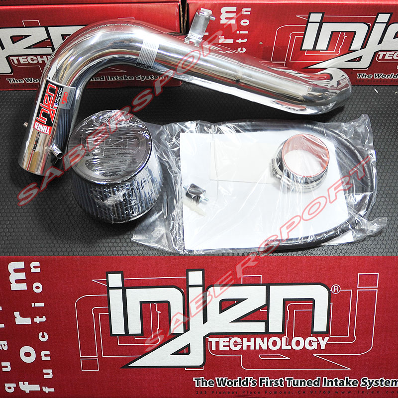

If you go For Injen you will get this:
If you go for AEM:
See how both have the Correct Tube Lenght to fit the VSA Throttle Body! Both will fit without any mods....
Dont Panic if you Search for a CAI system and the Pic doesnt Seem to Fit into your TL-S (Since Longer Tube) most Brands use Random images for their Items.
If you go for AEM:

Yup Injen 1481 is the Right Part for the TL-S, tough wrong pic again 1481P is a 1 Solid Piece Design not a Hybrid One
This is what your Really getting with 1481p:
Congrats on the Decision, Enjoy it!
