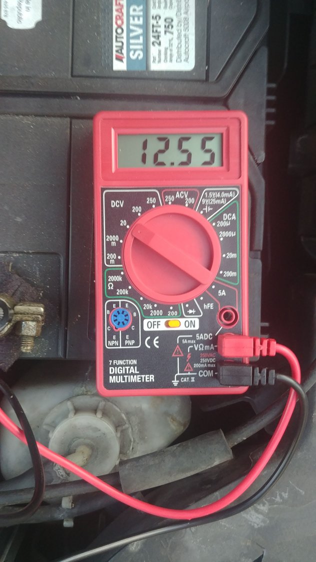

Alright I got my multimeter out and tested both the battery alone is pulling 12.55 and with the car running I am pulling 14.43
I reset the cars Computer and drove it to Autozone because I didn't reset it after replacing the plugs Only the Check Engine Light was on. (AutoZone is about 6 miles) and the only code they could pull was P1399 Missfire in any cylinder.
of course halfway home on the return trip The VSA and /!\ light came on again...
Car off
Car running

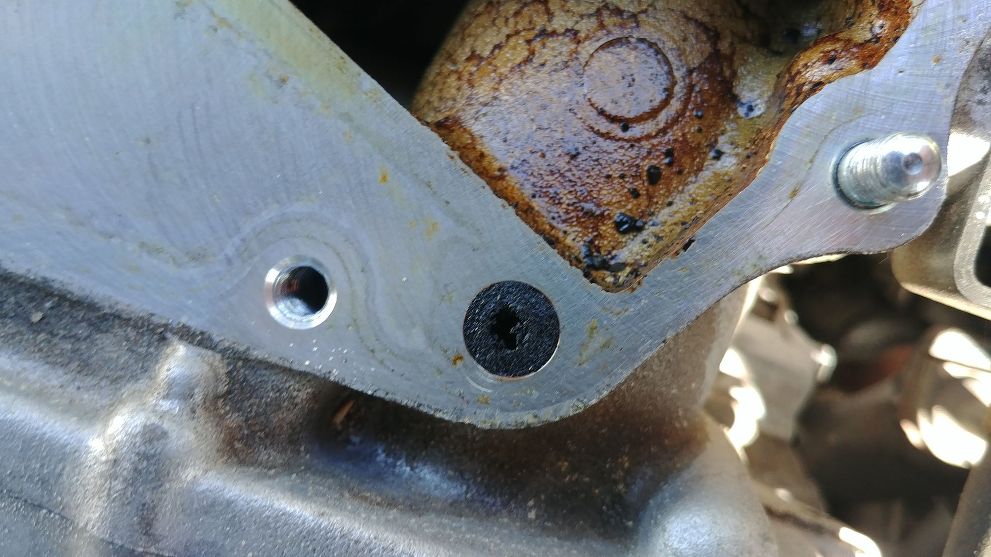

Okay I tested the grounds, borrowed the battery from my Corolla for testing purposes that I know is good and has the right CCA, and cleaned out the intake manifold thing that seemed to have a lot of carbon buildup. The only other thing I can really think of is possibly bad injectors? But that's a lot of them to just randomly go bad over night..
Can you guys think of anything else to check before I just take it to a mechanic?
