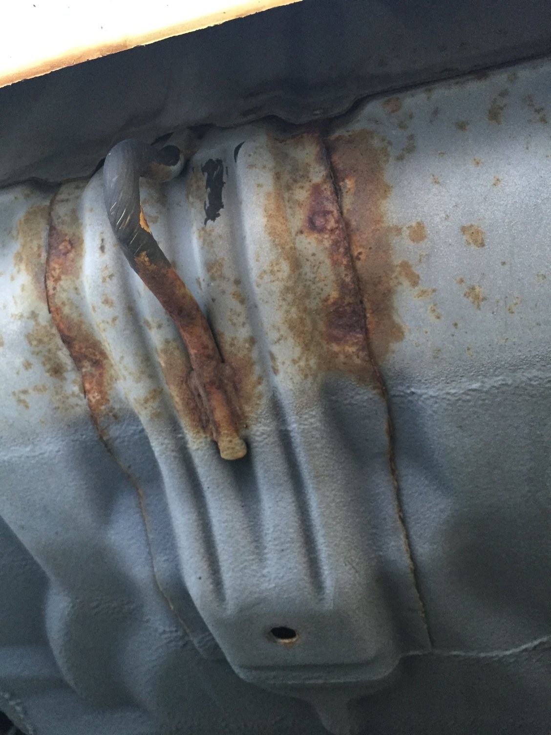

Here is a picture of my tow hook. Do I place the jack directly under the hook or do I follow that weld joint down a little bit.

OoO the square weld thingy is letting you know that thats the jack point! use the square weld.
Old Aug 22, 2016 | 11:56 AM
Posts: 48,312
i don't think so Justin.. not in this case,
I thought the same when i saw that little hole in my 6th gen accord. I jacked it up and lo and behold, my trunk/spare wheel area collapse upward
Use the tow hook!!
Old Aug 22, 2016 | 11:59 AM
okay, just to be safe, use the tow hook.
Old Aug 22, 2016 | 12:22 PM
Chojun's Avatar
Joined: Sep 2014
Posts: 743
Likes: 94
Yup I've raised my TL on (ON) that hook. There are YouTube videos that can confirm it's safe to place your jack on that hook to lift it, in case you want a 2nd/3rd/7th opinion Also the service manual specifies that hook as a jack point for floor jacks.

Put the jack *directly* on the tow hook. The rest of that bracket will cave in the trunk.

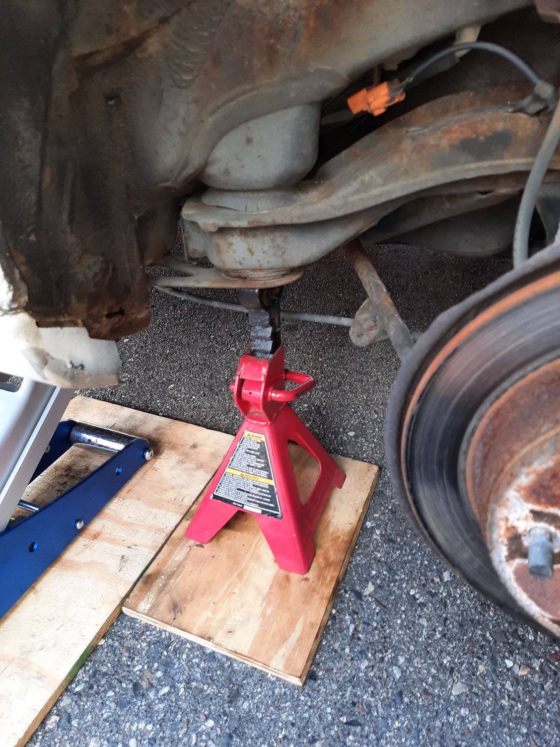

So, I had to leave car at jack stand alone and move floor jack to front. Changed front and rear tire. Is that point ok? Basically, that subframe bolt sits at top of jack stand.
250
