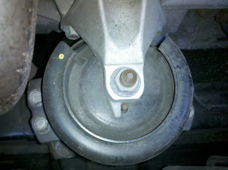

My front engine mount still looks pretty good:
I can't really see the rear mount.

could be!
as long as you seafoam the gas thats good--
just do a shot thru the TB to clean the air plate and pivot hinge
need to look at the mounts from under the car for oil leak trail, or look at ground under it for a few drops of very strange oil- like none I had felt or seen before
