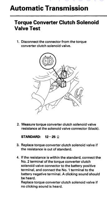

Here's the test procedure for the solenoid itself. You should rule that out. While you're in there, carefully check the wires, connectors and I usually spray some contact cleaner whenever I split a connector I haven't opened in a while.
If you haven't done so already, do a 3x3 drain/fill, clean the screens on the valve bodies and change the trans filter. Don't forget to wipe all of the metal filings off the drain plug. While I haven't had a code or flashy D5 pop up, I've been dealing with a sluggish 3-4 shift. The 3x3, new filter seemed to help a lot.
