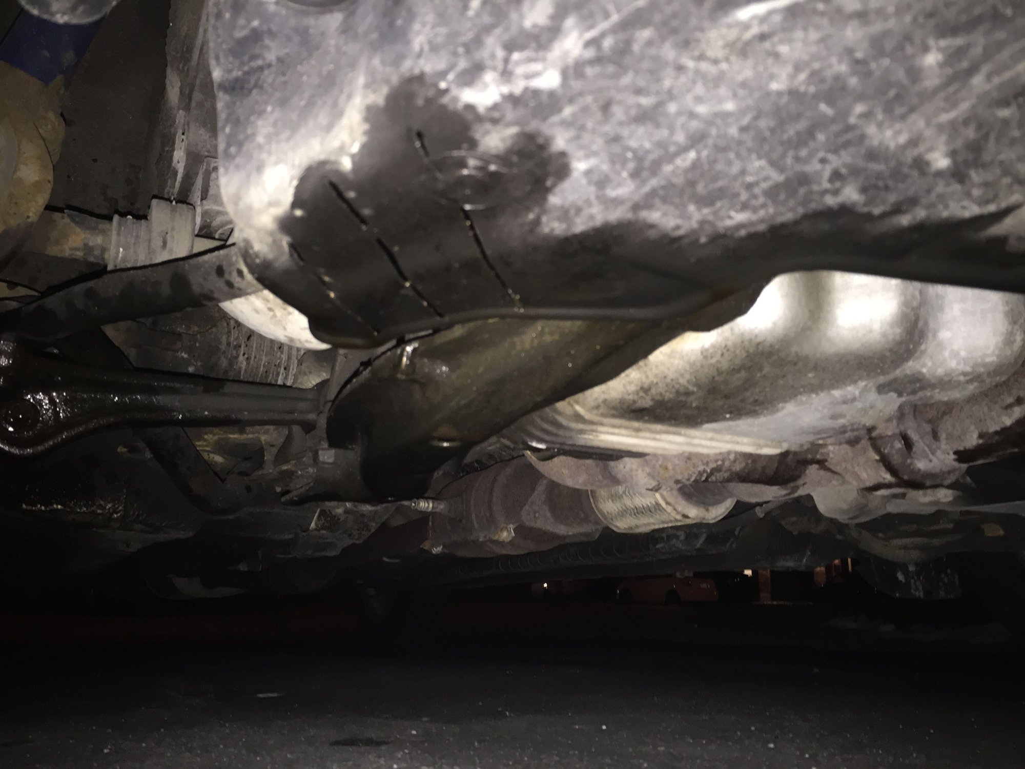

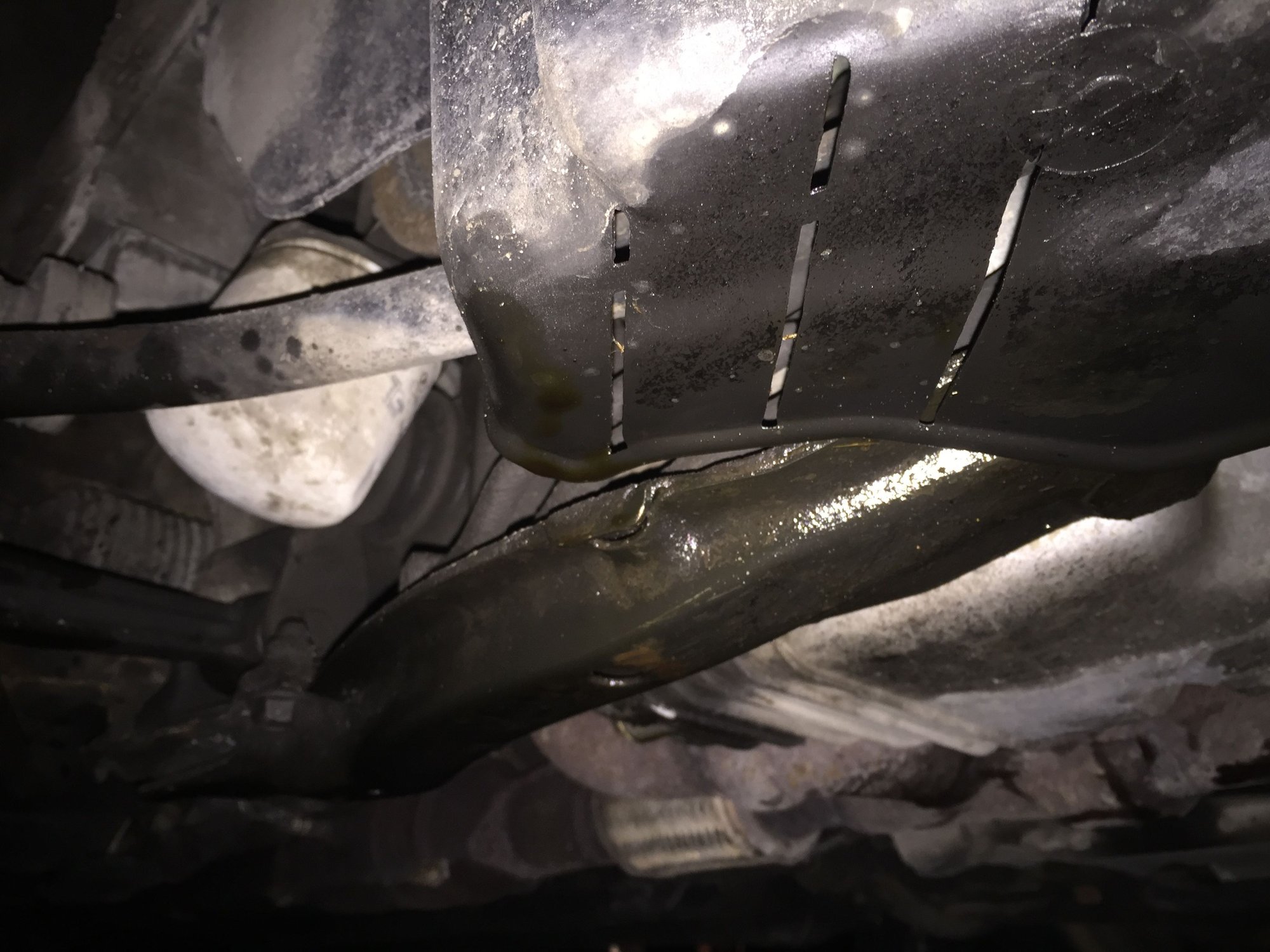

Hey everyone just noticed some drops on the ground comming from the front right passenger side ... not sure what the problem could be ... can someone give me some advice could it be the oil pan or something Else !?! Here are some pics ... thanks

There are 2 power steering steel lines which run along the top of the sub-frame, they feed into rubber hoses right where the splash shield is. It may or may not be your problem.
Check the power steering fluid reservoir level.

yea looks like power steering fluid.

Yup, power steering fluid it is !! just checked the level and it's below half thanks guys I'm glad it's not engine oil gonna take to the garage this week ... anyone know if this is a costly fix ?! Thanks for you're help !!

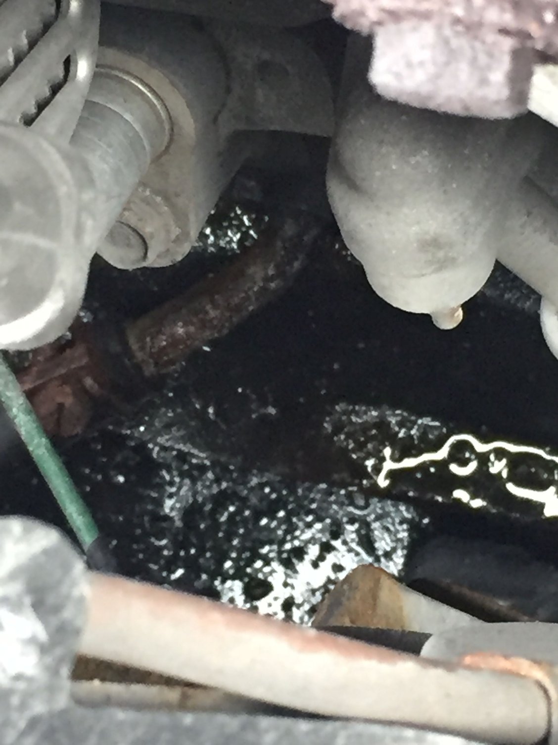

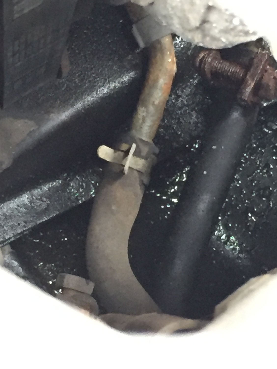

More pics ...
I managed to take more pics of the leak ... on the pics you can notice that there is one hose where it's leaking ..the one with the rusted clamp I cleaned all the oil from that spot drove it around and noticed a new drop that looks like it came out of where the hose is with the clamp ... is this the high pressure hose .. looks like it's leaking from around the hose .. what if I tighten the clamp a little more can this help ?!? Thanks !!
Old Nov 28, 2016 | 10:15 AM
Posts: 48,312
I'd suggest just replacing that hose altogether but I'm concerned the rust has eaten away at the metal portion.
Get a new hose, but some worm clamps and hope it fixes it
OEM Acura TL SEDAN 2001 P.S. HOSES - PIPES parts
pictures are bad but i THINK it's 17 on the diagram?

My problem turned out to be the low pressure power steering hose, its the one that has that rusted clamp on the pics I posted , My mecanic switched it with new hose and all has been good since almost 2 weeks and no more leaks !!
