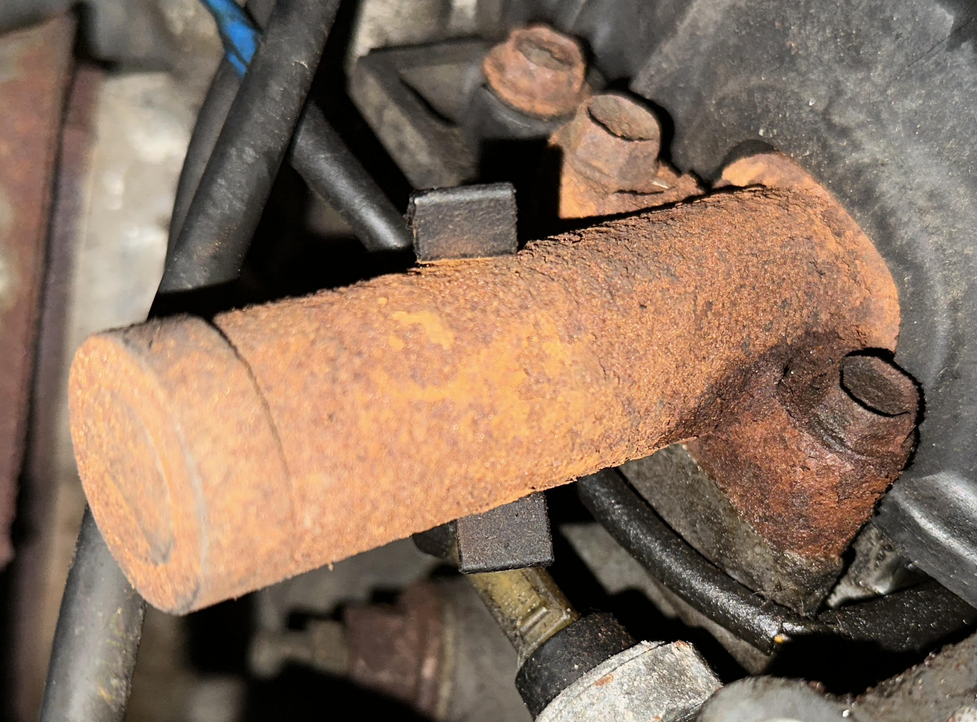

Me thinking the noise is: broken manifold gasket bolt.

Hi Dom, I'm a little confused...I see this old thread from you with the same video and the issue was resolved by the mechanic as a bad cat. has the issue indeed returned?
https://acurazine.com/forums/2g-tl-1.../#post16939816
I suppose this could be a cracked exhaust manifold. You should be able to remove the cover from the front manifold and inspect it easily; back may be a bit tricky. but at least you know where to look/hear for sound.
If you end up seeing some attempted repair I would take it back to the mechanic who said they fixed the problem as a "bad cat"

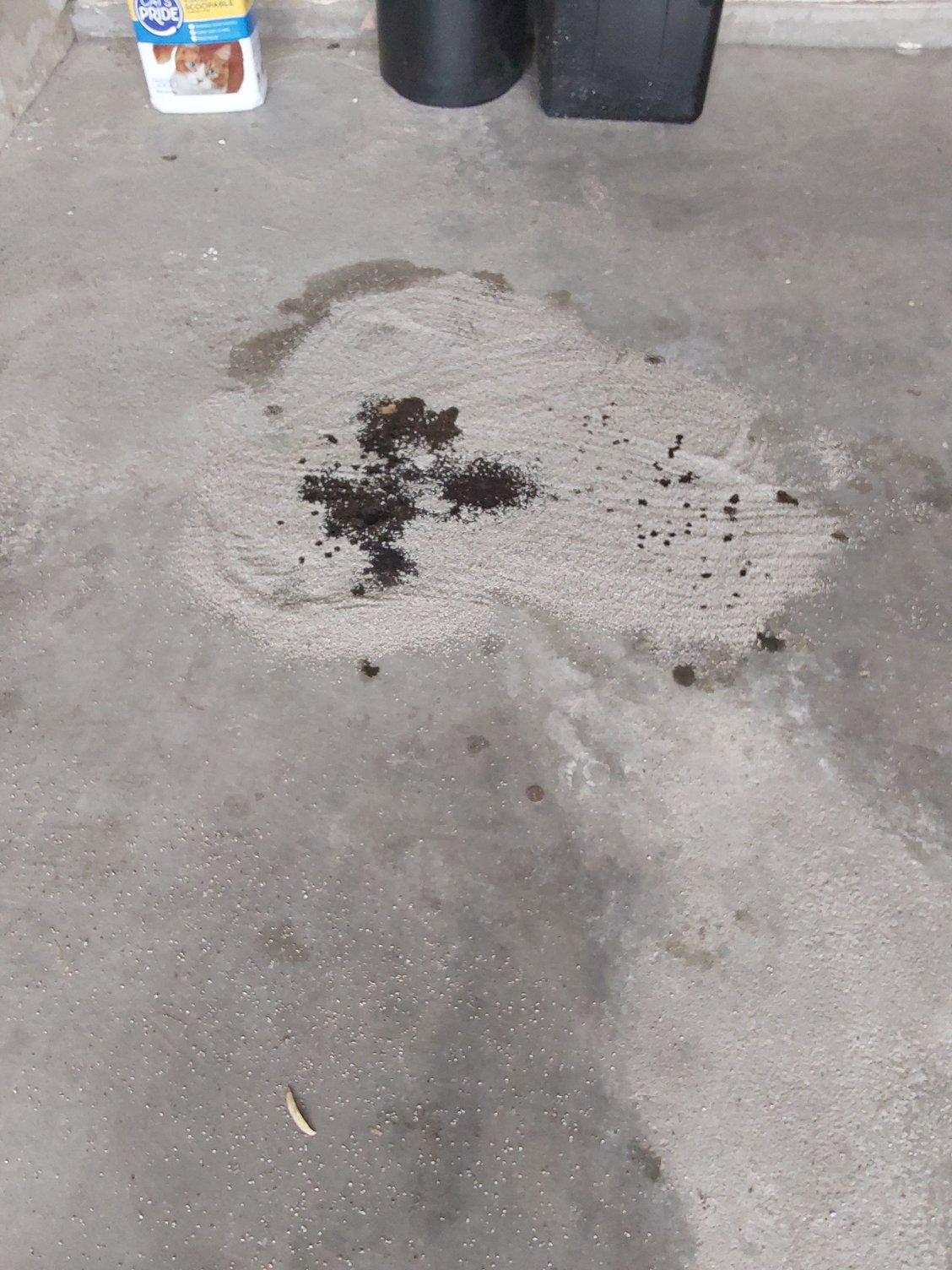

I pull the car into garage.
me thinks the drops on right side are from oil pump seal.
left side is rear main seal. And probably tranny case housing. (Left side smelled like tranny)

It's like - I can fix oil leaks when timing job is due (probably in 2026).
I can fix the rear main leak and transmission case when/if the transmission needs a rebuild.
just not sure it's worth it.......

Despite the mess on garage floor, oil is full on stick, so is transmission fluid. Hmmmmm......
