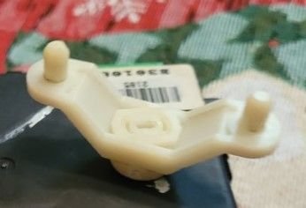

My AC won't change from defrost to any other vent. Is what I'm holding on my hand the mode door actuator or is this the blend door actuator? I can't find a video to help me fix my issue. Thank you

This specific white component in your picture looks more like the same component on #5 (red arrow) than on #6 below; therefore, #5 Motor Assembly, Mode; 79140-S0K-A01 is in your hand.
Image search both part numbers to easily confirm.
