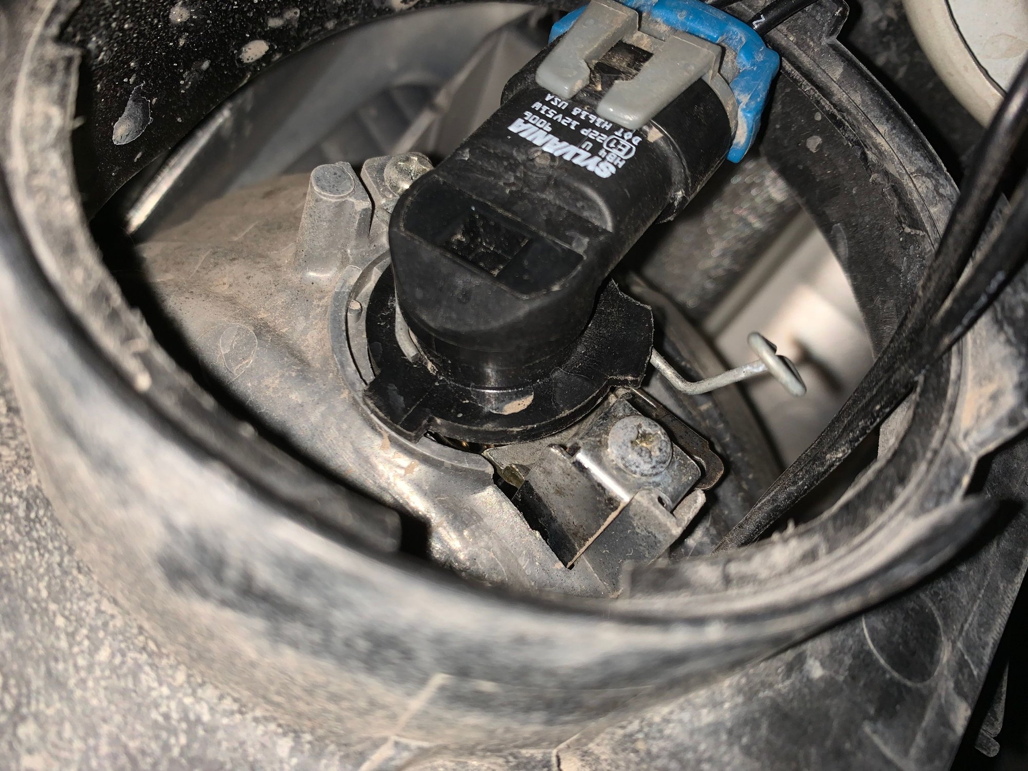

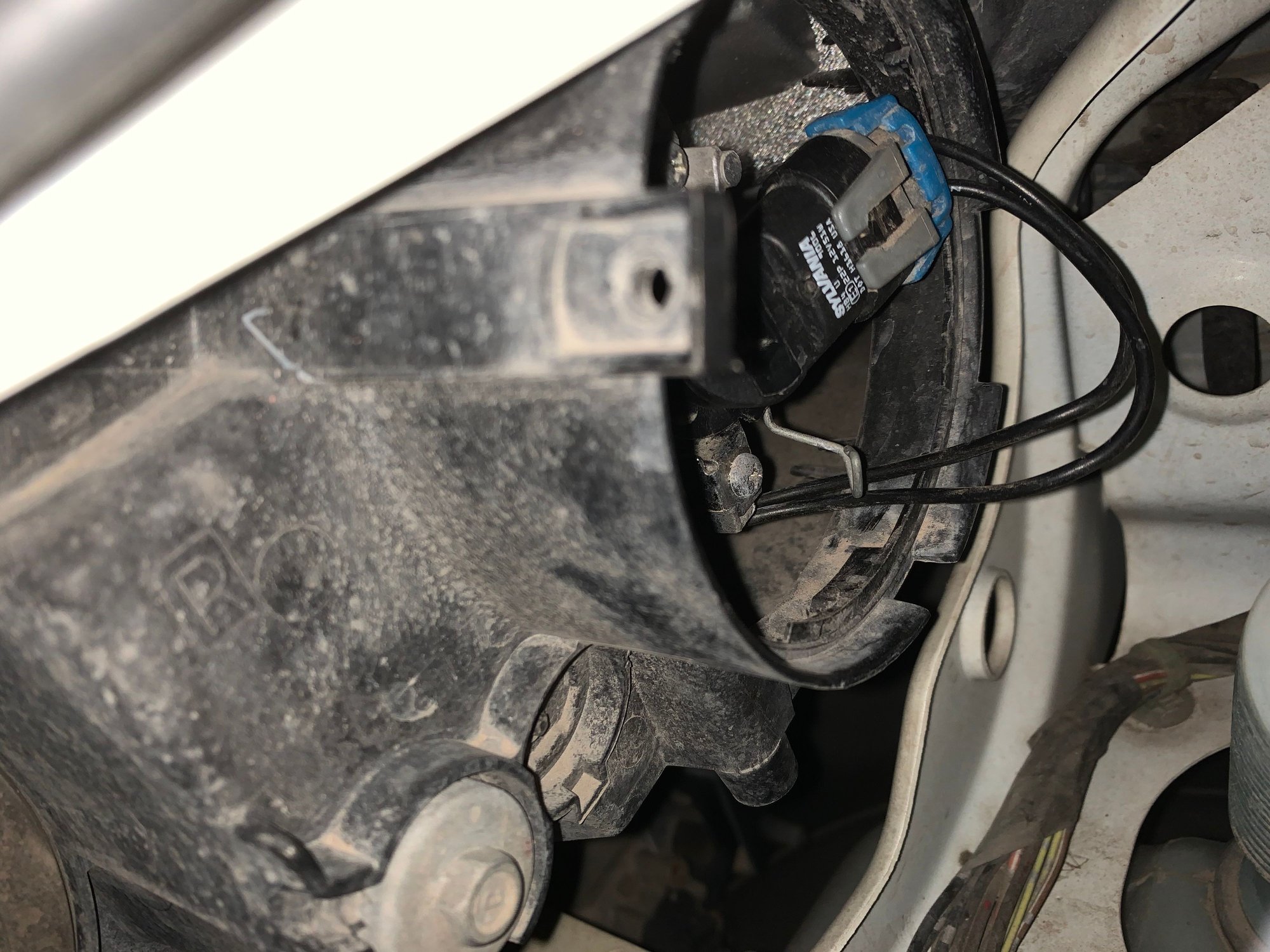

Recently acquired a 2002 tl base. I went to order some better headlight bulbs because they are terrible right now. Everywhere I looked showed they are hid low beam. Mine were clearly halogen so I looked and low beam has a 9006 bulb installed kinda rigged in factory headlight housing. I didn’t see where they had spliced this connector either, all looks factory. It’s dark so haven’t pulled headlights to verify if ballasts are even there. But couldn’t find any information on a hid to halogen swap and no idea why you would want to. Is the connector to oem ballasts similar enough to a 9006 bulb that it’d work?

thats cuz your previous owner was cheap and didnt want to buy hid bulbs or ballast...

At this point I would suggest visiting a bone yard and pulling headlight housings and the wiring harnesses, ballasts and everything and putting your car back to stock.

Yea I wasn’t impressed. 9006 bulb is just sitting there with factory clip half holding it. Does anyone know what the connector looks like that plugs into factory ballast is main question? If it’s not a two wire and similar to a 9006 bulb then somebody has done some custom wiring splices somewhere hidden. I just didn’t have time last night to pull bumper and headlights to inspect further.

Well looked into it further. The 9006 connector is spliced in I found and no ballasts. What morons. I will go aftermarket with them.

I ordered a hid kit from ddm and received it tonight. I installed passenger side and works as it should. What a difference. For anyone curious, the ballast input is in fact a 9006 female connector so whoever downgraded lights actually did me a favor in the long run as it was all plug and play. Thanks for the help.
