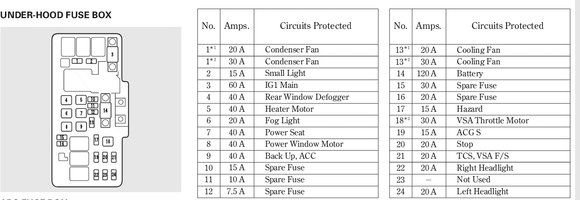

So I am looking at the manual while im at work. I read the fuse panel several times. I cannot find one that fits my problem
Do you know what is it called?

When asking a question about a car, please include the year and model.
Jeff's car Under-Hood Fuse Box... #20.
Other 2g TL is Under Hood-Fuse Box... #47.

Hey everyone, i check my underhood fuse box #20 STOP and it was still a good fuse. Anything else i can check?
