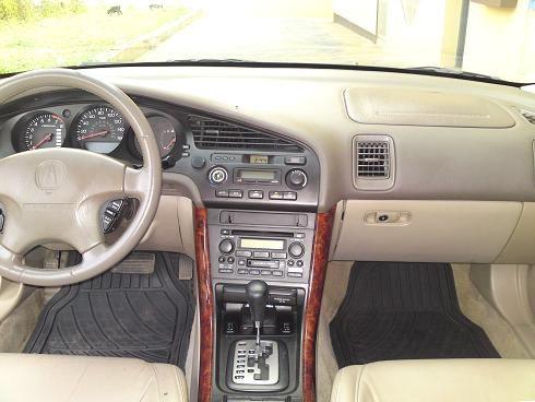

Well there is no OEM Navi "Kit". The Navi models have a different dash cover to accomodate the Navi head which also has the HVAC controls integrated. You could find all of the components on eBay but map updates stopped in 2013.
Here's are a few recent threads on this.
https://acurazine.com/forums/second-...loring-985705/
https://acurazine.com/forums/second-...o-swap-986461/
Non Navi Dash
Navi Dash
