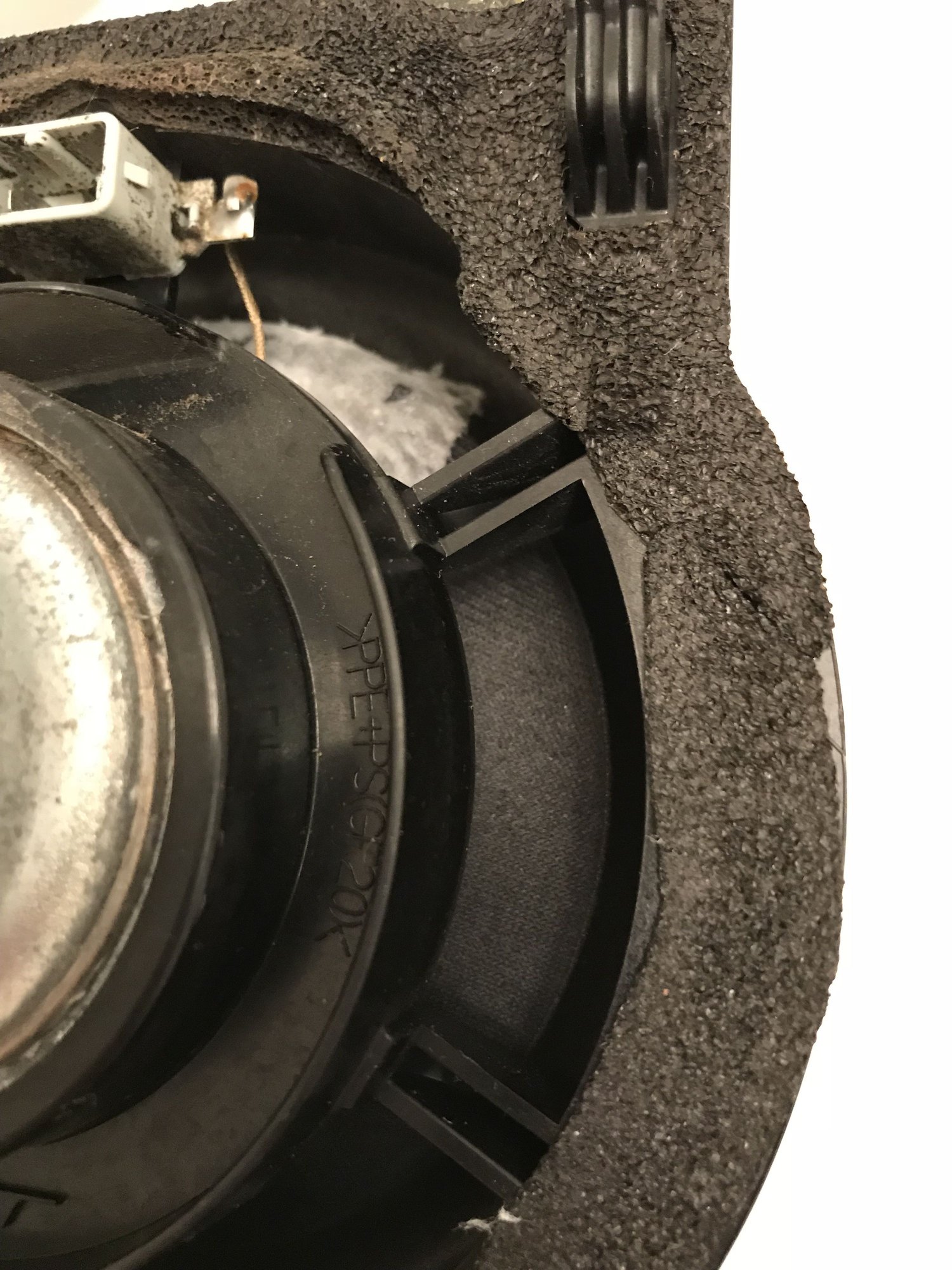

When I first thought my left tweeter was damaged, turns out the speaker is blown. And boy is it, there's a piece missing!
So I found this video:
Here's my result so far:
I still have to paint it, then test it.
However, I also did get my hands on a speaker from an 05, im not sure why its not working, but the material on it is all intact, no tears no wear.
I do intend to test the repairs I made to see if it's a viable solution, and will report back. But does anyone know if its possible to swap that material onto my speaker?
I'm looking at it, and it seems glued. Unless I may be missing something that someone who tried that may know if we can swap the fabric part?

It's a couple hundred bucks for a new one. These it seems are only made for Acura. they are 2ohms and similar size from other brands are all 4 ohms; lower sound.
It looks bad, but the feel is good. The nail-polish soaking the thin layer of paper does turn it all into one sheet. After painting it should look better.
But if I can somehow swap that part from the other speaker it'd be great!

Wow toilet paper/nail polish repaired speakers!! There should be plenty of 2 ohm mid bass options out there. Anything but that though.

Anything but the toilet paper fix. 2 ohm is fine or you can go 4 ohm with a higher sensitivity rating and get similar results. In my opinion, factory amps can't handle 2 ohm for too long and that's why there are so many posts about failed capacitors on here. Too much heat and a poor design with no real cooling is a doomed endeavor from the get go.
