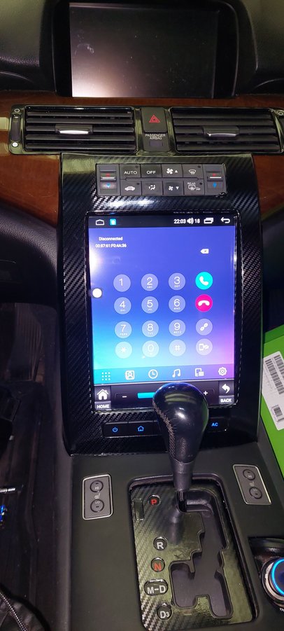

Well, it has arrived...pictures at bottom.
First impressions are that it looks like a tablet in a well made custom frame. Has a few buttons on bottom and what looks like a built in mic(bottom left hole, not sure about that, hopefully bypassable for a better setup of a visor mic).
Has a slot for the physical climate controls and I have a 2010 model of those on the way so I can still run it manually if necessary. Comes with plenty of clearly marked wiring harnesses, but the big scary part is no actual manual.
I've talked to them about this and there's definitely a language barrier. They tried to be helpful by sending pictures of wiring hookup that I didn't ask for, but still no manual seems to be available.
I'm hedging on hooking it up because, being new to Acuras, I'm a bit worried about the radio/nav code issues, especially with a blank nav screen. Couldn't hear the player spinning, although it did open and close, so I got lucky and found a junkyard unit from an 06.

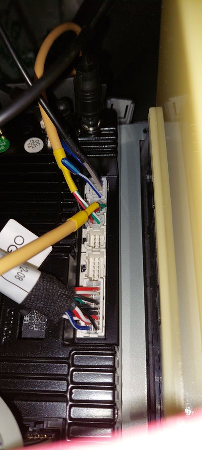

For those watching this, I got the nav screen back up and running...a chafed wire in the harness had me thinking it was an issue but it's good now...got the head unit in, and just finished wrapping it with the carbon fiber. Working on the shifter plate now.
​​​​​The unit seems to come with all the harnesses you need to reinstall and I've been given assurances from their customer service that it will work with nav codes and the factory upper display as well as climate controls. Their manual is a little outdated and is very sparse(13 pages), but we will see how it goes when its in the car, likely tomorrow or sometime this coming week.

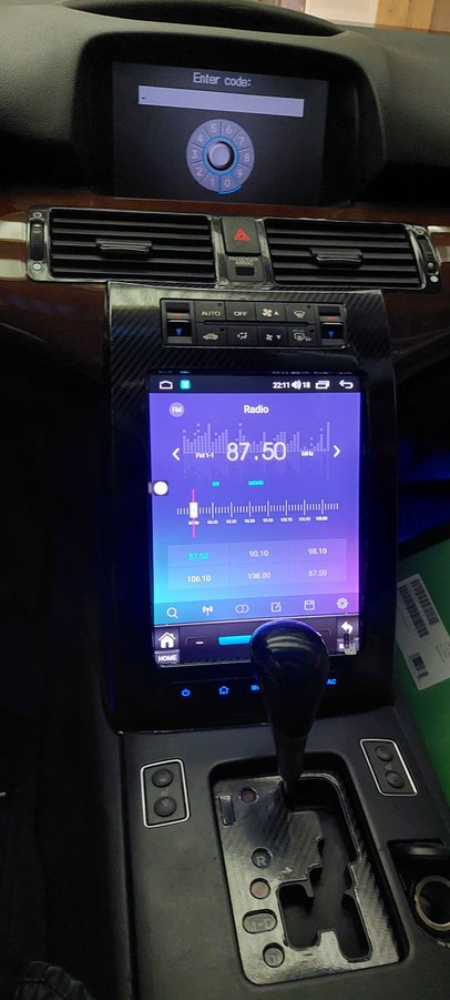

Got it installed but a few issues...most obvious of which is that the touch screen isn't yet working...probably a glitch...sent a message to their customer service on that.

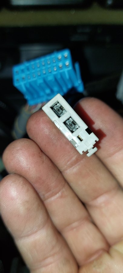

Included the issue that the antenna connector for their unit is a 3 pin connector vs the 5 pin connector on the car (see pics).
Also, on the unit there are two plugs in center that didn't have harnesses, which I suspect go to the white plug that didn't have a mate (see pic). I suspect they forgot a harness which makes sense given the other glitches.
I didn't have my new backup camera wire handy so I just soft mounted the shifter surround...their unit snaps right in without hardware, so hopefully it won't be super difficult to snap out to finish the wiring.
Picture bomb at bottom:

Sadly, it looks like "not an ashtray" made way for a bigger screen, not that I ever stored anything but lint there anyway. The unit comes down and then mates right up to the front of the shifter surround.
Update on the touchscreen issue, it's a glitch...their customer service said I can fix it in the settings with a USB mouse, and that they'll provide a video to do so. The center two plugs are for factory testing only.
The antenna issue they'll get with technical on on Monday, and from the gist I got they may send an updated harness...
Liking the design. Liking the support, although it hadn't seemed to be there initially, all around, pretty good. Hopefully I can change the backgrounds and make it look even better.

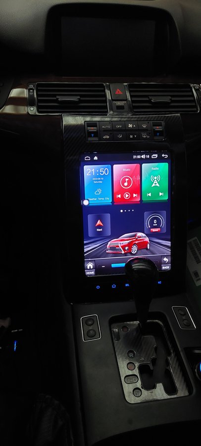

Also how bright is the unit at night ? Does it go nicely dim with the headlights on ??

I see one of your pictures says "Enter Code" with a wheel of numbers on the screen ... what is this ? Code for what ?
That code is for the factory nav screen. Haven't been able to figure out that input with the aftermarket head unit. Apparently I'm missing a harness, which they say will be sent...hopefully not on the slow boat. I cycled through most of the menus, and they're pretty sparse. Seems they're sending me an update file which upgrades to Android 12 and installs the climate control interface.
I can tell they're trying to support, but language is an issue and it seems like they would have worked the bugs out of it BEFORE putting it on the market. Manual is all but useless and is clearly for an older model.
Not trying to knock it though....it does seem like there is progress on this though. Have a backup cam all but installed...just need to hook up to the right backup light positive wire...according to the manual it's a brown wire.(see pic).

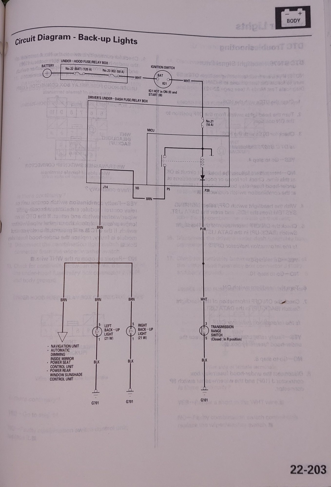

The stock wiring to the tail lights in the trunk is really flimsy looking, so I decided to wait until I could grab a wire tap instead of trying to splice.
I routed the wire down through the driver's side trunk arm. To get it from the trunk to the backseat, I just routed it through the u channel that braces the center of the seat.
I wanted to run straight through the center console, but the padding was so thick that I kept getting stuck in it, so instead I just pushed it under the driver's side trim plastic.to bring it forward.
Used a frame cam, drilled a hole dead center behind the plate which I used spacers to push out enough for the wire to wrap over, and then ran the wiring through a grommet which I then sealed with silicone.

Alrighty...update is that I was missing a harness, which they'll be sending immediately. Other than that, not much that's fit for print.

Ok, update to the update and good news if you don't have sound.
I smelled a rat with AOSTR trying to sell me on the optical thingamawhatsit, so I went down to see a friend who works at a local sound shop here...he confirmed that the part they tried to sell me was nonsense because the Acura RL has analog connections. According to him, the issue is the factory amp not being triggered to come on. He said that if you jump the white number one pin on the factory harness to the red wire on the harness, it will trigger the amp to turn on and you should have sound.
At this juncture, I would highly recommend that nobody buy from these companies because the juice isn't worth the squeeze. I'm not sure how I'm going to fix the digitizer issue, aside from a full refund and reinstall the factory head unit, but he also said that integrating the head unit with the nav screen and the top display are likely to be a pipe dream.
Picture of the connections from my friend.
