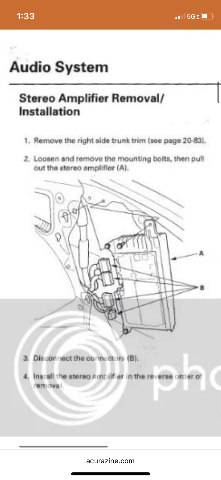

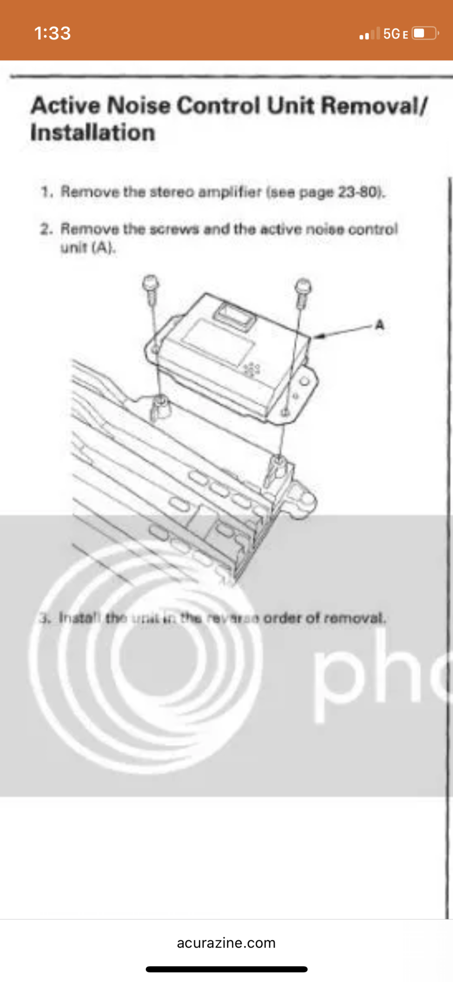

I just recently got an 05 RL and I’m hearing a buzzing noise from the passenger side of the car. I did some research and found that it was the ANC module and I need to unplug it. Does anybody know where I can locate it? I know it is on the passenger side in the trunk, but I don’t know what I should be looking for to unplug. I have seen diagrams of it but if some could just tell me where it is that would be very helpful.

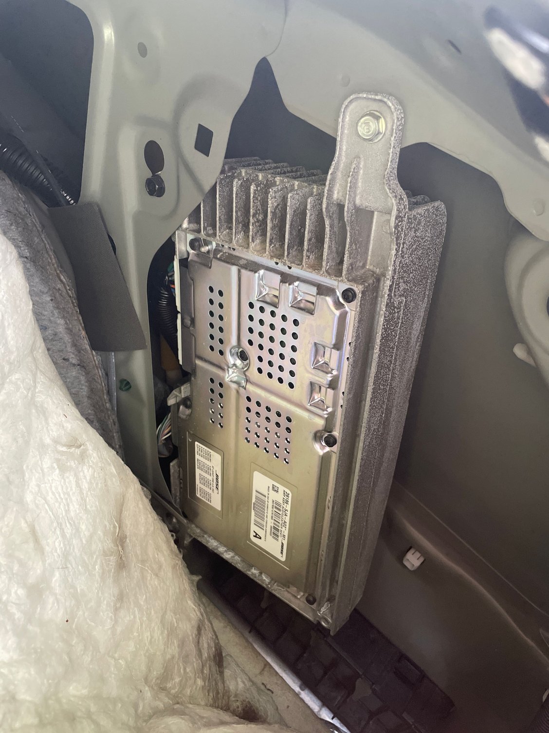

I
I know that it is somewhere around here if anyone can let me know where I can find it, that would be very helpful

Thank you. I was able to find these

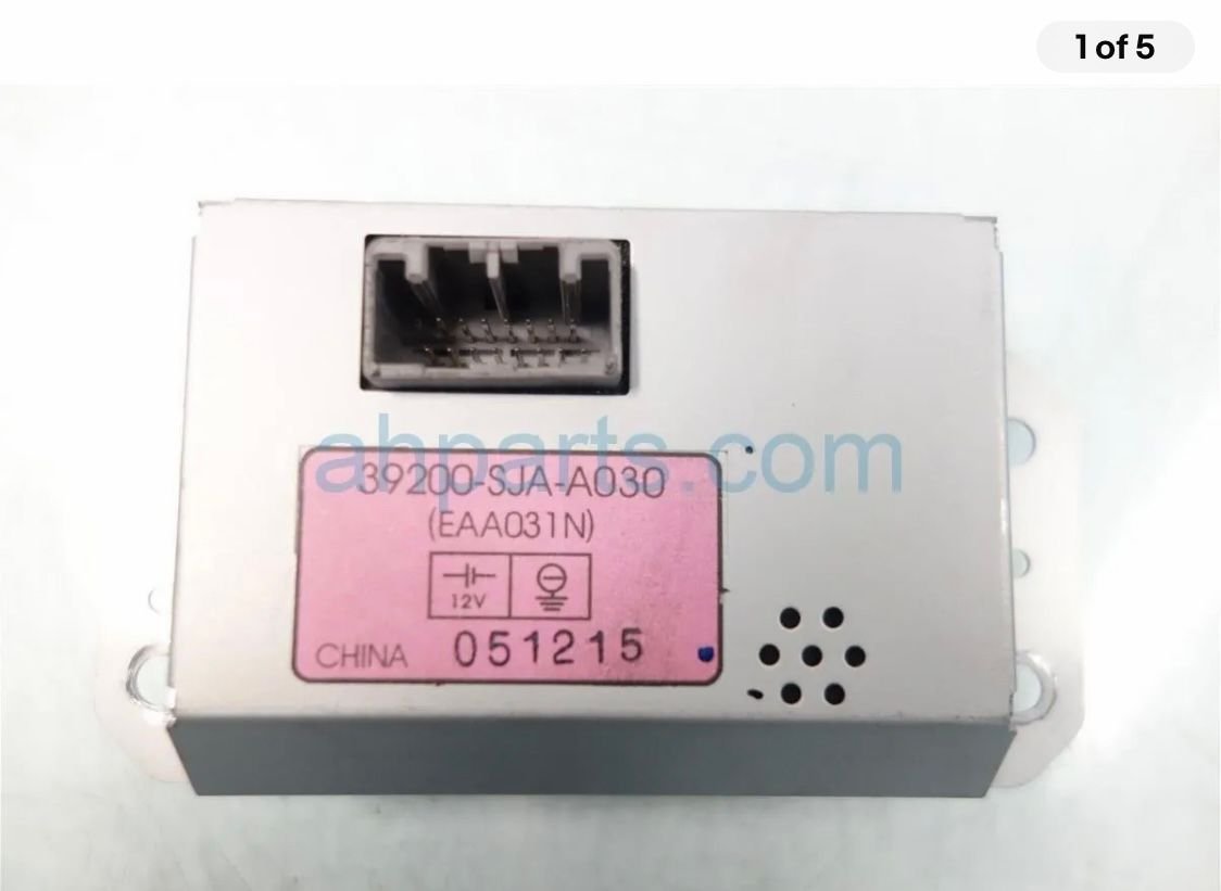

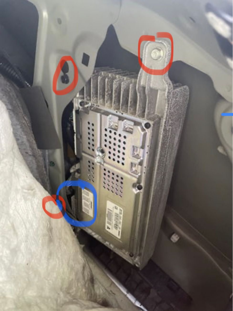

so I was able to do it but didn’t stop to think to take new pictures, but I can explain with the pictures below. You first will need to remove the 3 bolts which are circled in red below. They take a 10 millimeter socket wrench. Then i circled in red about where you should find the module you need to unplug. It is connected to the amplifier and should look like the other attached image. You just need to unplug the wiring harness to the module on the side of the amplifier then re-assemble. Be careful of the fiberglass insulation from under the trunk liner, I was being dumb and rested both elbows on. After all was said and done, I now have no annoying buzzing noise
