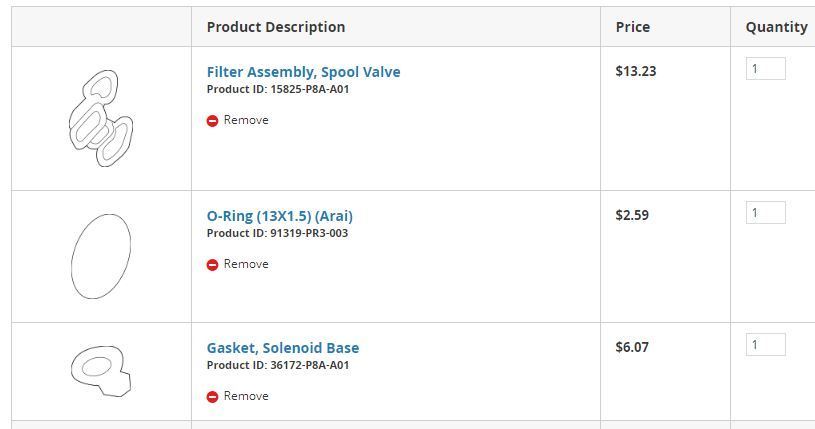

15825-P8A-A01 Filter Assembly, Spool Valve
36172-P8A-A01 Gasket, Solenoid Base
91319-PR3-003 O-Ring (13X1.5) (Arai)
How to replace it. Should be easy. Put car on front jack stands when you are doing an oil change. Remove passenger wheel. It is close to the oil filter! I will do this at my next oil change and will take some photos!

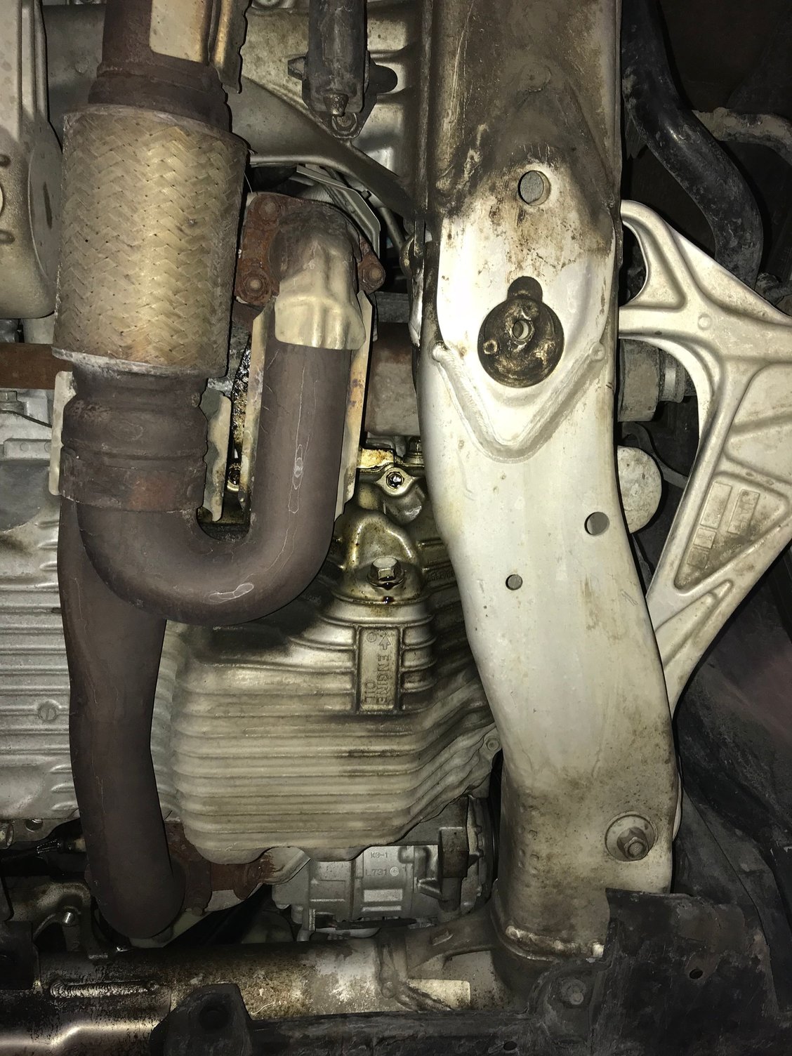

My drip tho is more from a bolt on the top of the oil pan a few inches above the drain plug, not towards the passenger side of engine where the vtech solenoids are.
I am wondering is it a good idea to remove the bolt, and re-screw it on with a silicone ring to block the leak, or is it better to leave it and let it sweat oil out?

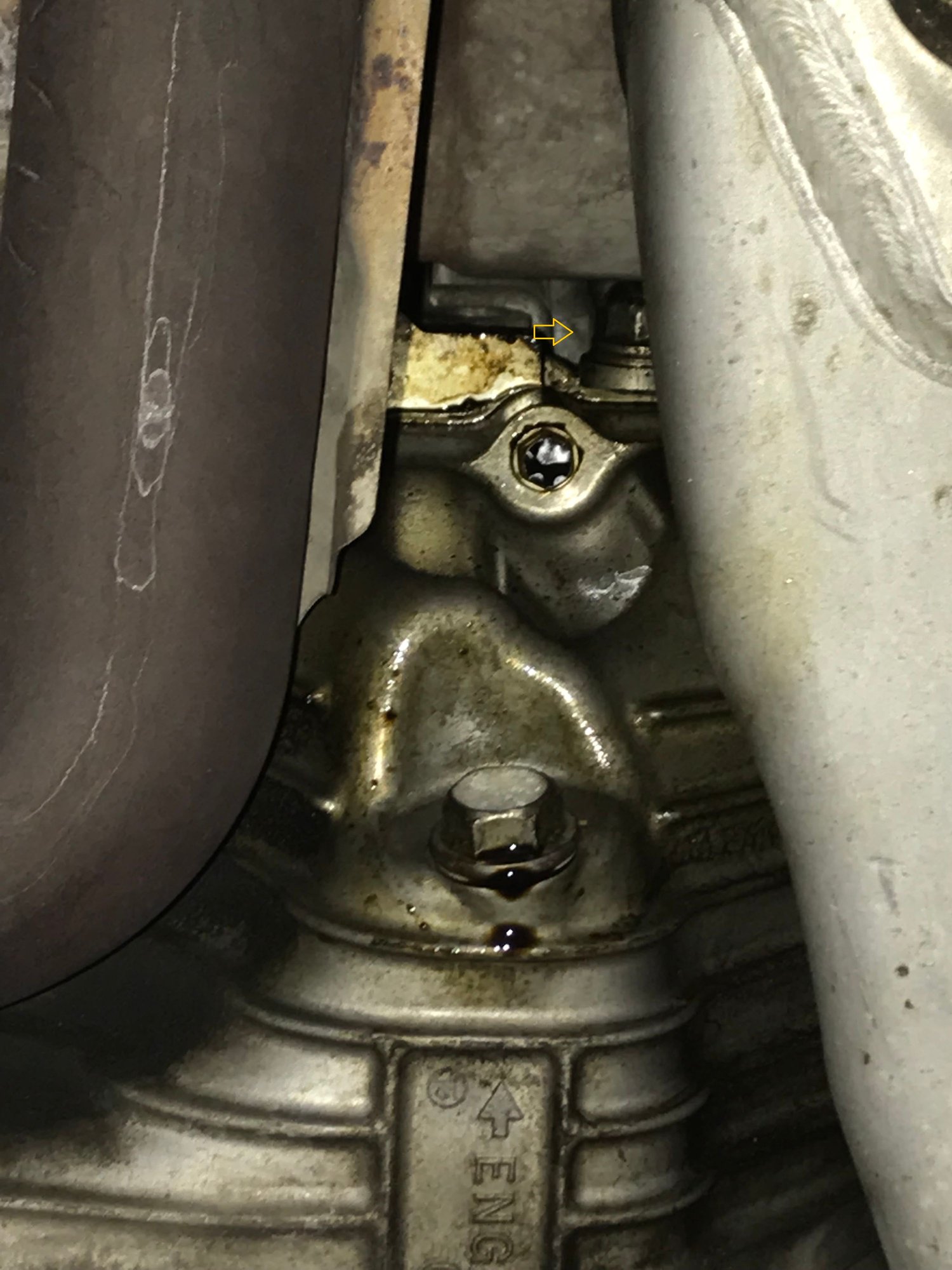

Got it. Well, I am going to install the vtec solenoid gaskets at the next oil change. I'd assume it would take about an hour or less for the job. For you, maybe you could take the bolt out and wrap some plumber teflon tape around the bolt and bolt it back on? Can you take a picture to show us where the bolt is? I am a visual person.

The drain plug has a cpl drops on it, but leak is from above it. Orange arrow
