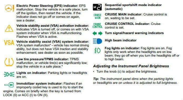

Originally Posted by schen72
I don't understand why the guy in the video is trying to accomplish? Is his VSA light on because there is actually something wrong with his VSA system? If so, why would you want to turn off the light? If there isn't anything wrong with his VSA system, maybe he just turned if off (which illuminates the light in the gauge).
no no I don't think he's just turning off a light.
The Triangle is VSA activation indicator. and the VSA light is: VSA system indicator. When the triangle is on, means VSA isn't even active. Which triggers later a VSA light as well once you start driving over a certain speed. So if triangle is on, means VSA is not active.
This happens if you clear codes apparently, in a normal scanner, like 'clear all codes', it somehow also erases the neutral position memorization. Or if you actually replace the VSA control unit, etc.
Remember Vehicle Stability Assist works together with ABS and SHAWD depending if you're accelerating or braking. It's the more advanced alternative to TCS in TLs. So that computer firmware needs to know where to start from, to "stabilize" the car... . See what I mean?
That starting point, is called "neutral position". so the guy in the video placed the car on a flat surface, and did "neutral position" memorization. So that the system can save that 'neutral' point, and work on stabilizing the car after that.
Once that is done, the triangle goes away, means VSA is active. And when you drive, its now working, and the VSA light doesn't come on anymore.
What I wanna know is, like he showed on his scanner, the 'neutral position memorization' option is there, does the torque pro, or similar apps, have that same menu, and that option.
BlueDriver does not.
Old Jan 8, 2019 | 07:13 PM
RL09's Avatar
FkNo!TheyRdstroyinEvrting
Joined: Jan 2016
Posts: 3,040
Likes: 237
