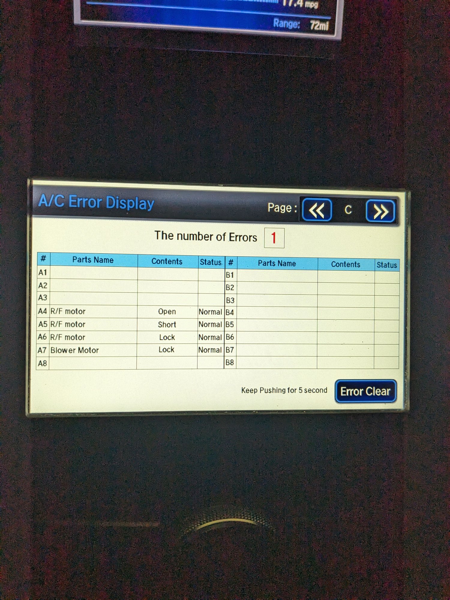

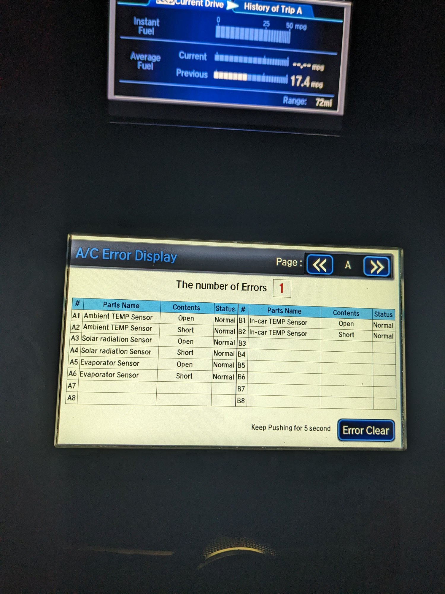

At first, when I picked up car from car shop, manual mode selection did not work. I found a guide how to run self diagnostic and it did show MODE MOTOR LOCK ERROR - see attached images below
Later, I do not know how - but the ERROR was resolved somehow on its own after few hours walking around the car with both keys)
