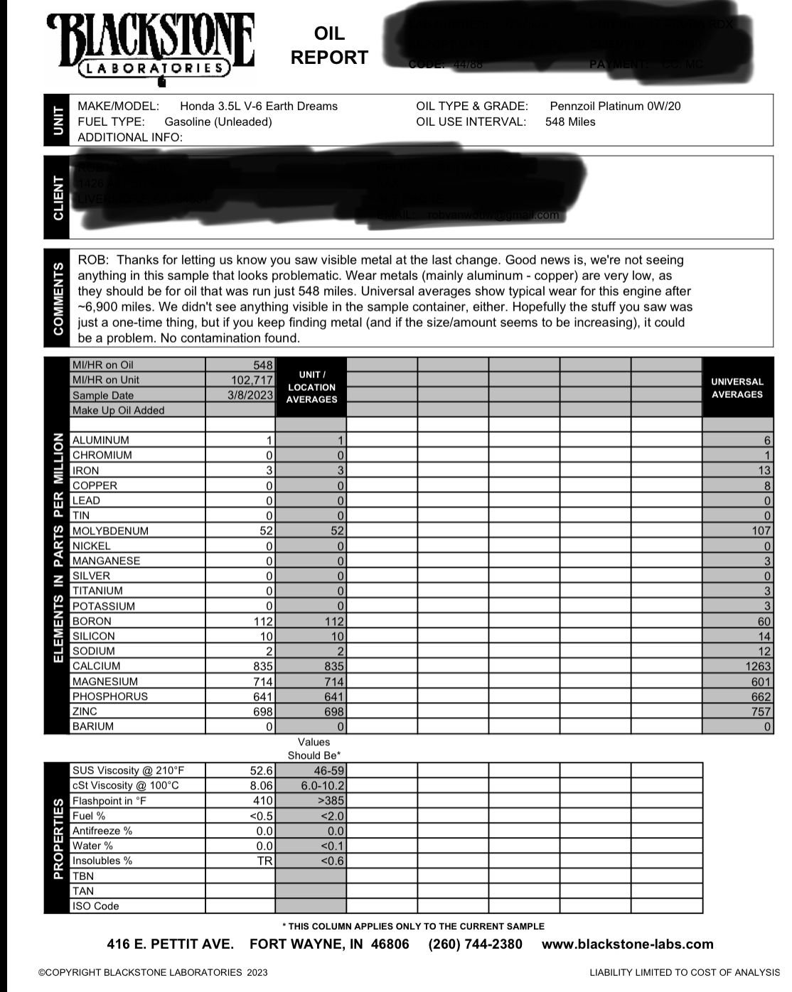

Send a oil analysis sample to https://www.blackstone-labs.com after 550 miles before the warranty ran out. Took the sample half way the oil drain per instructions. The report did not show signs of accelerated wear. See attached photo. And decided not to pursue the engine tear down to find the possible source. The dealer cost was 5k and wouldn’t be covered under warranty.
I will do another sample at the next oil change.

Why don't you also cut open an oil filter and take a look at the pleats inside.. Its odd that blackstone detected nothing you would think that they would measure some levels of metal wear after 500 miles. Worst comes to worst put in some highmilage 5w or a 10w oil and keep driving??

I did have the dealership cut open the oil filter after I purchased the tool for them. Oddly no particles in inside the filter but some black sludge. We did compared it with a 9k used oil filter and that was clean.
I am going to send out another sample to black stone when I have some more miles accumulated.

The fact that nothing was picked up during your last oil analysis is a good thing. I woudl keep tracking it for now. Are you having any other issues?

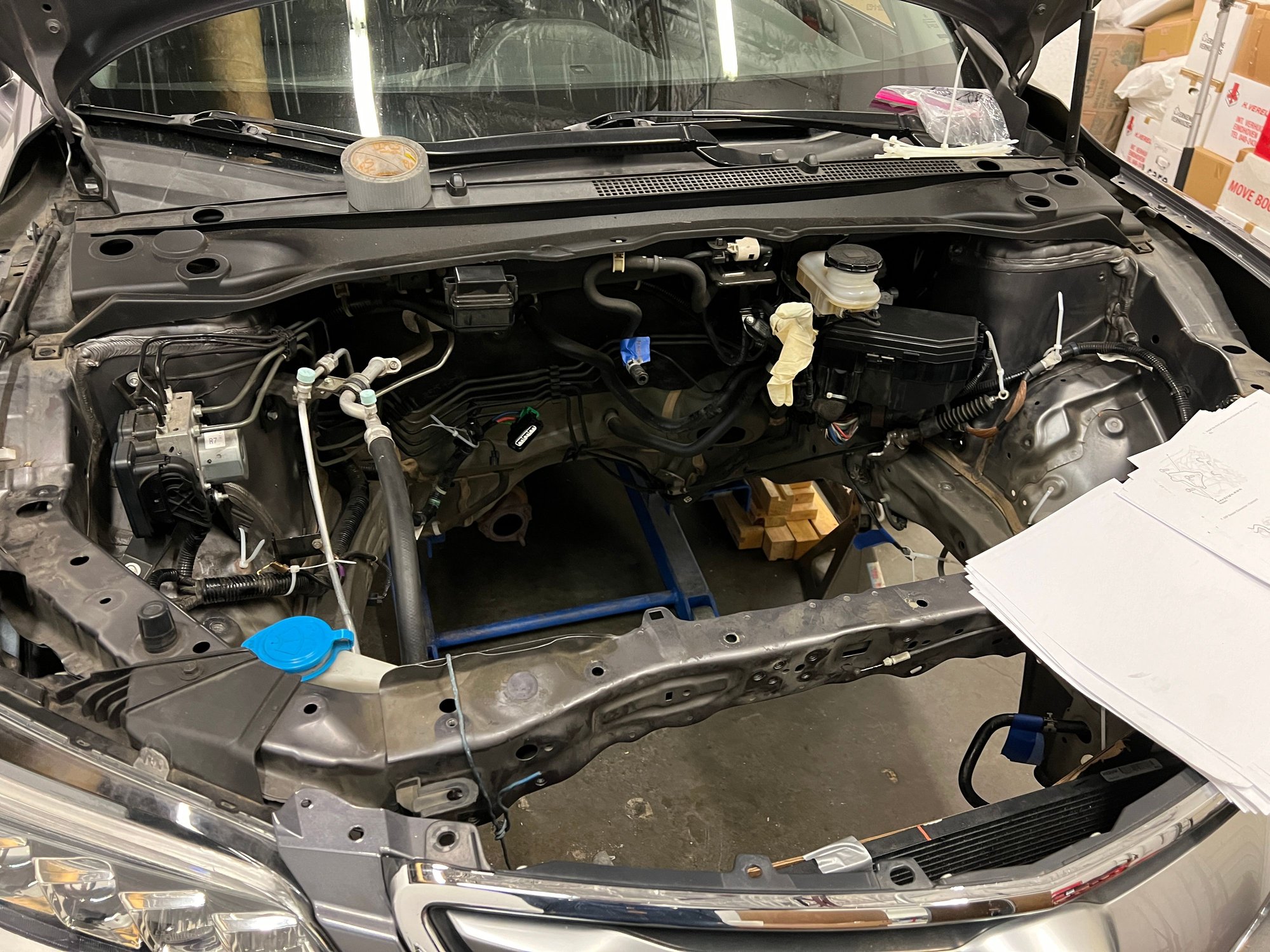

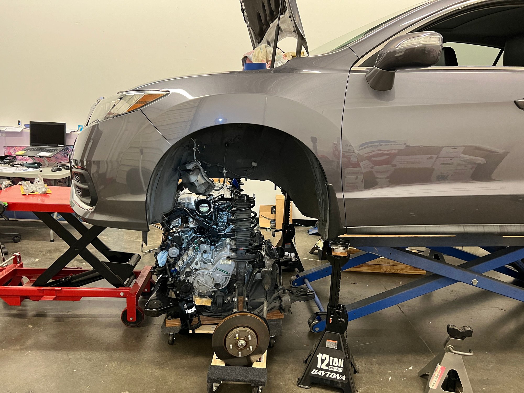

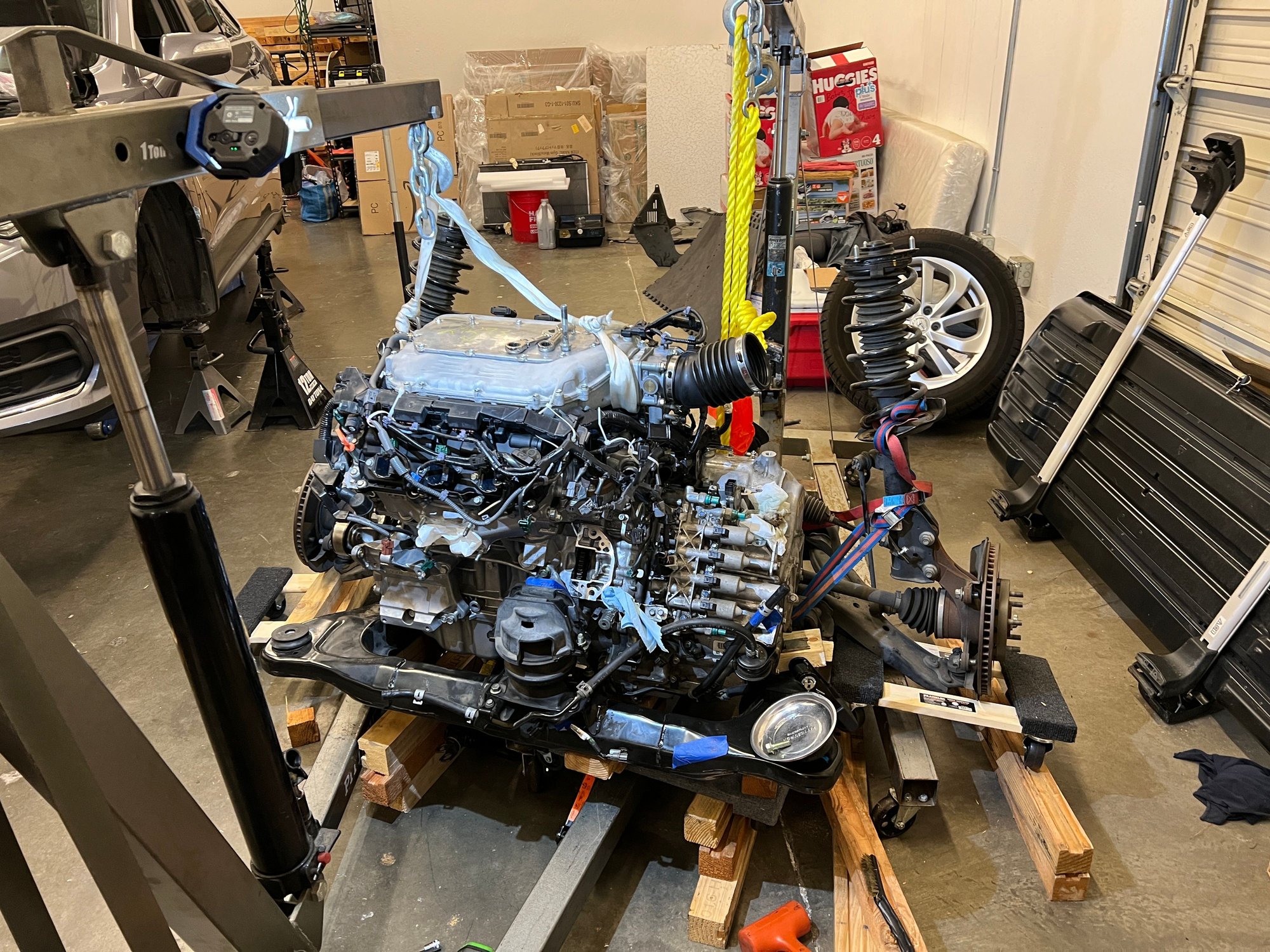

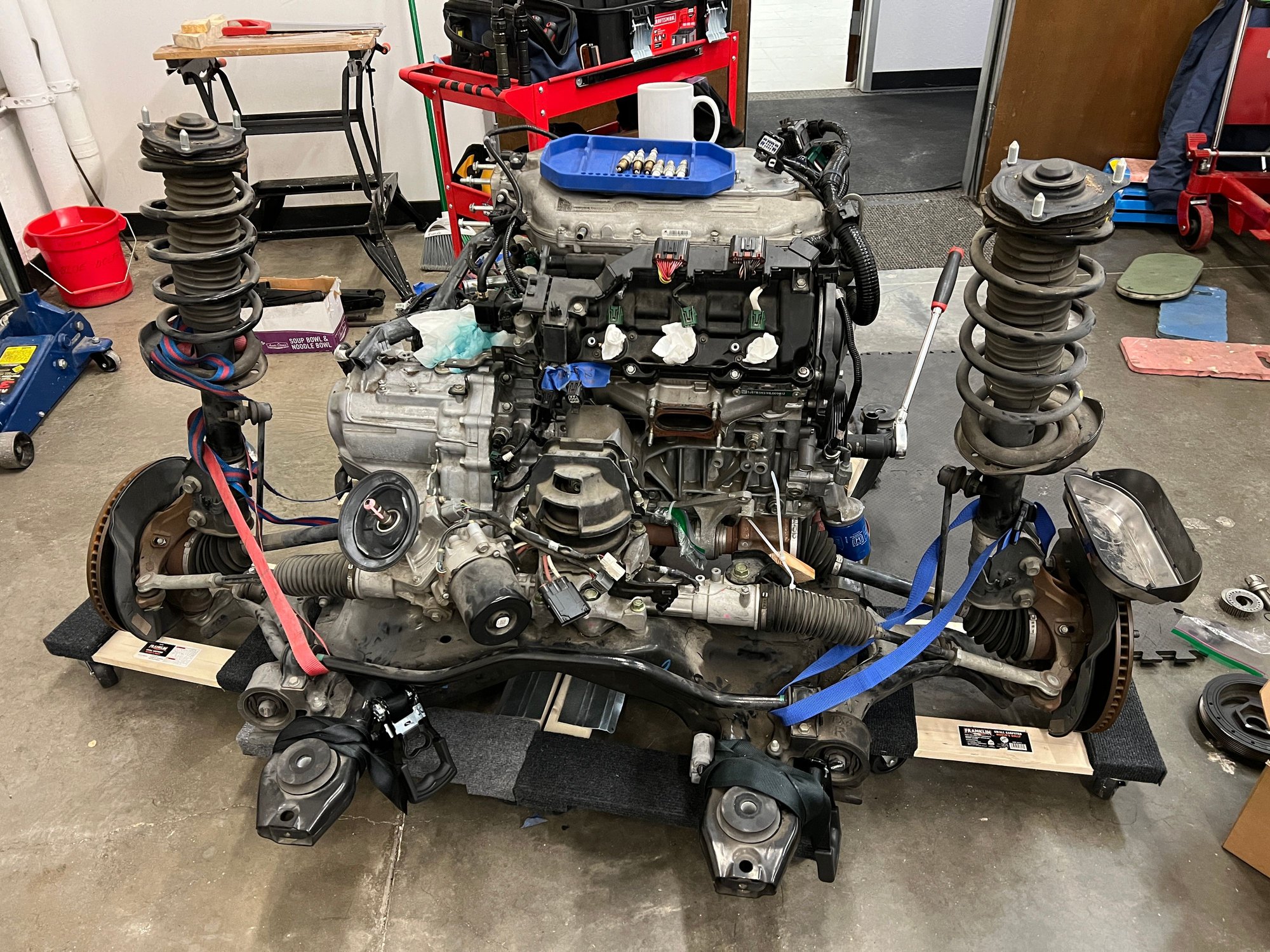

Problem solved. Found a 52k miles replacement engine from a rear ended 2016 RDX for $650. Bought a used mid rise scissor lift, engine hoist, engine stand and large jack stands. A Steering wheel lock, subframe alignment pin and exhaust gaskets. Downloaded the replacement procedure from the Honda and took time from work to do the engine swap. I opted for dropping the subframe with engine and transmission, like shown in the youtube video linked in this forum. The advantage is the front wheel suspension with the drive axles can stay in place with the transmission. Also putting back the replacement engine was fairly quick with the subframe as a reference. Also the best option using an scissor lift. Attached some pictures of the swap. The car is back together, idle relearn done, CKP pattern relearn completed and steering reset. Transmission refilled and checked the fluid level. Nothing broken and everything is back in place.
I am planning on opening up the old engine to take a look at the main bearings. Planning on parting out the engine
Engine and transmission dropped
Removing the good parts from the old engine
Empty engine bay
Ready to remove the old engine
