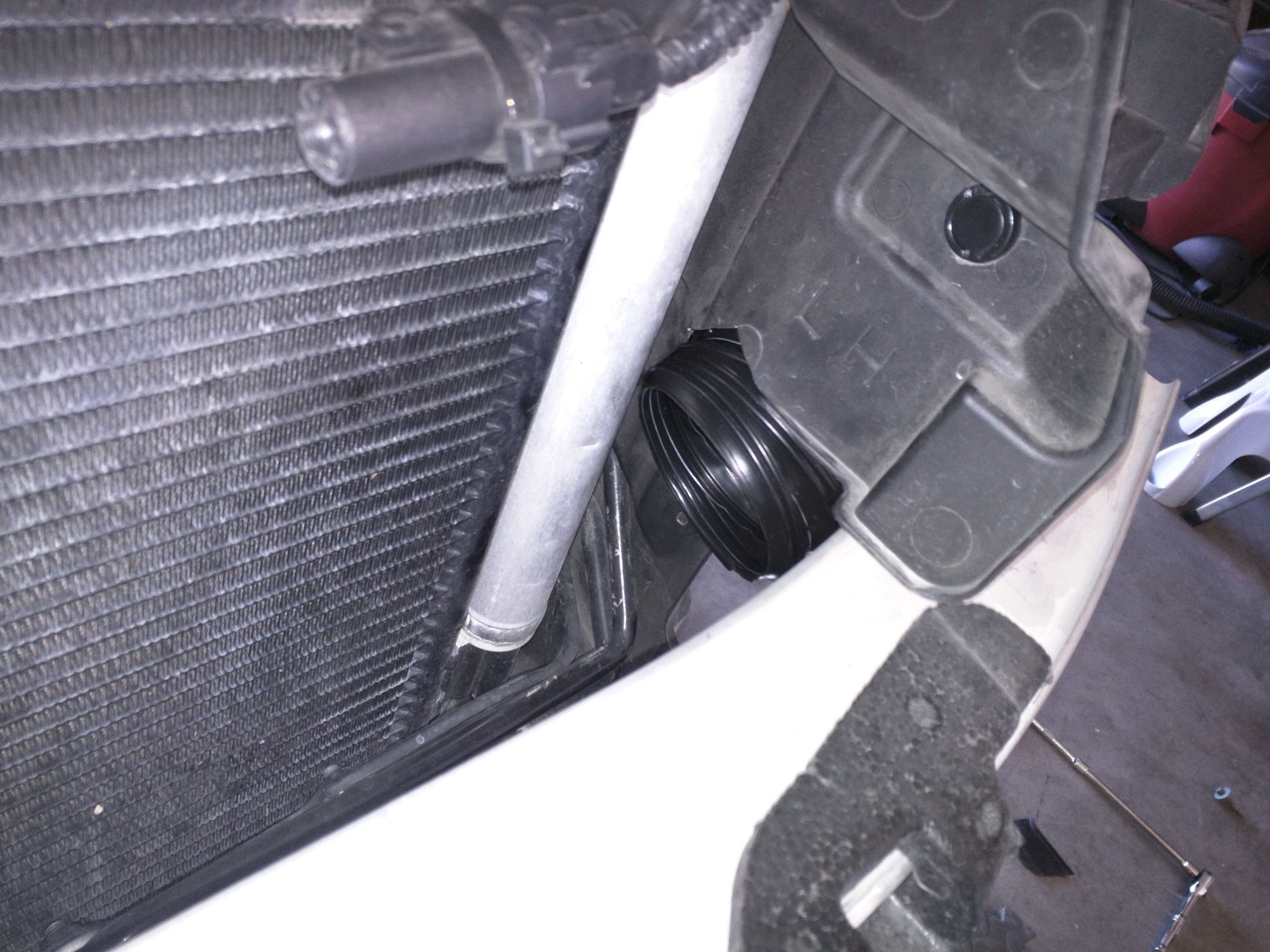

Damn it, I just looked at it good, needs bumper removal to get to it, half of it is showing so if I were to remove it I would need to route a flexible hose to the front to get cold air, then it would be obvious the resonator was removed, seems like a PITA to do. I would love to see a cutout of the resonator to see how the air flows.
Anyone messed with it before?

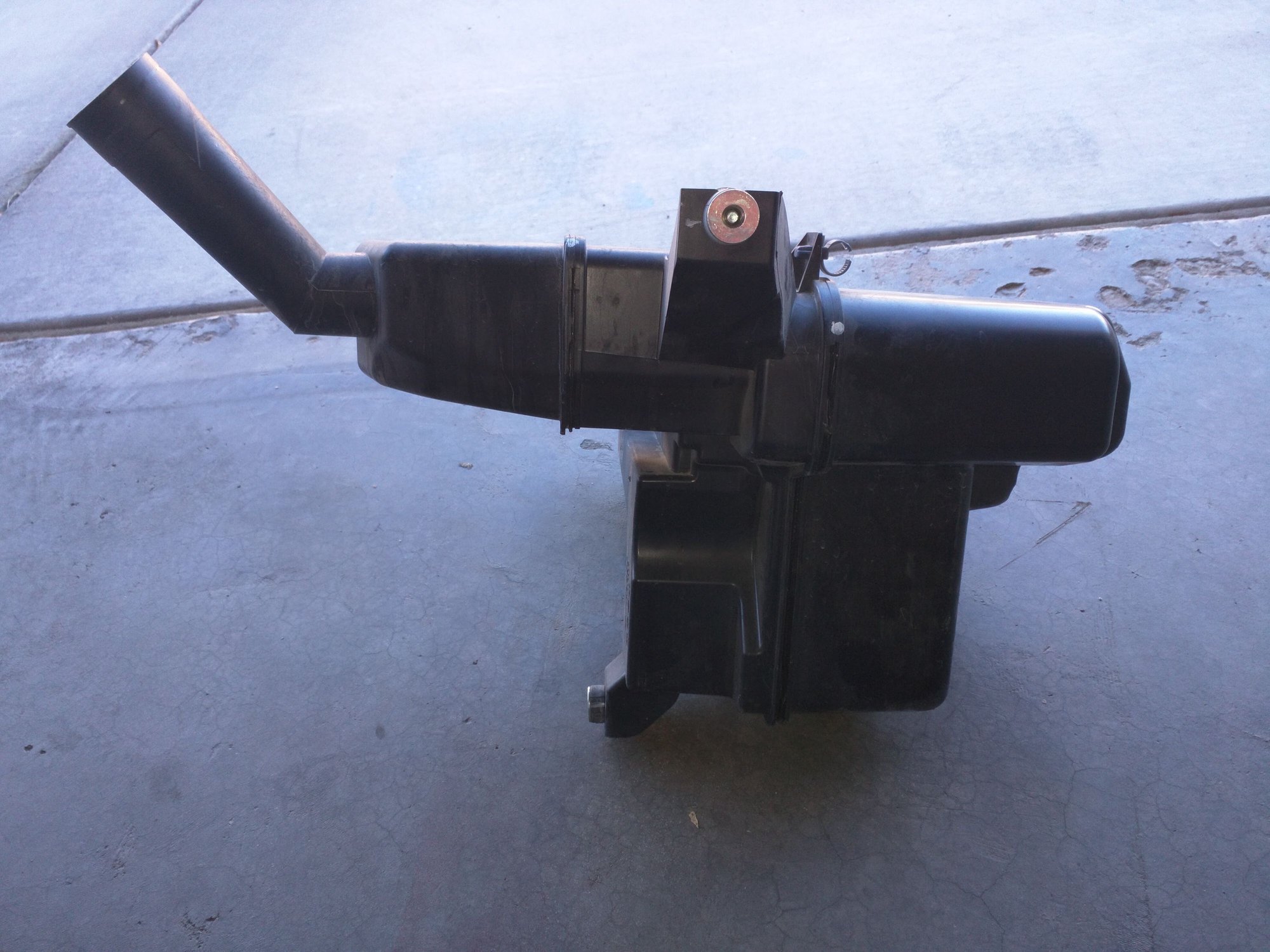

I removed the intake resonator, a must-do.
I did it, and to my surprise there was no intake hole in the resonator, it's just a huge plug, that's all the resonator is, WTF!
Took 2 hours to do, put a 3" flexible pipe there (bought it from Pepboys), needs a 3" clamp, and buy fender clips before you start (Amazon has them for cheap, search for Acura fender clips)
Now it moves more effortlessly, noise is pretty much the same, I haven't had the chance to go WOT, I'll try it on the freeway.
Tomorrow, I'll cut out the front piece of the resonator to see how it is inside and also to show an option for those who want to keep it looking stock when you open the hood.

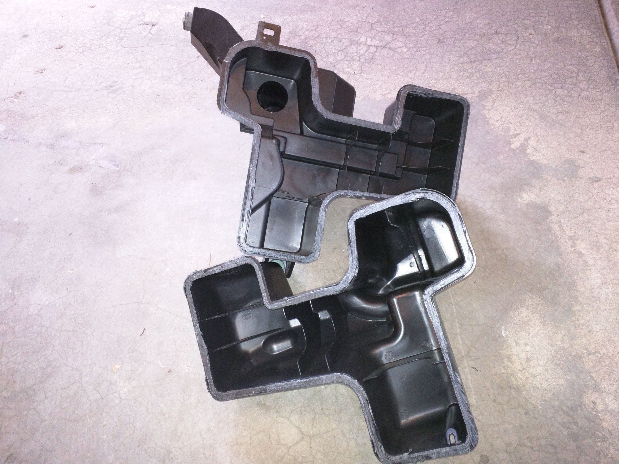

Here it is, cut in half, waste a waste of design and space, if at least there was a hole in the front, air would get in, but it's just a huge box.
And if you want to keep it stock looking, you can cut the front part off, all the attachment points are still there, or just drill a 3" hole at the bottom of the front part of the resonator while still on the car, that way you'll get air in without having to take if off.

I'm not sure you understand what a resonator does.
It's purpose is to be a dead-ended box. All it does is change the tone, or "resonance", of the system. So by removing it, all you should really do is change the note of the engine. Any additional airflow is probably negligible and not much benefit as the system is choked elsewhere (most likely at the filter).
But good work!
