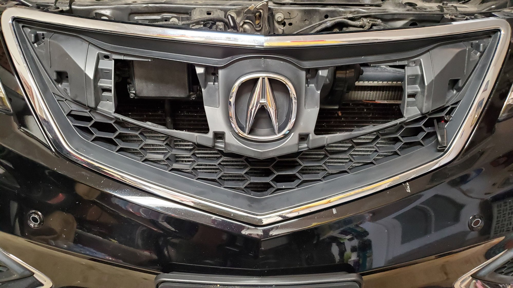

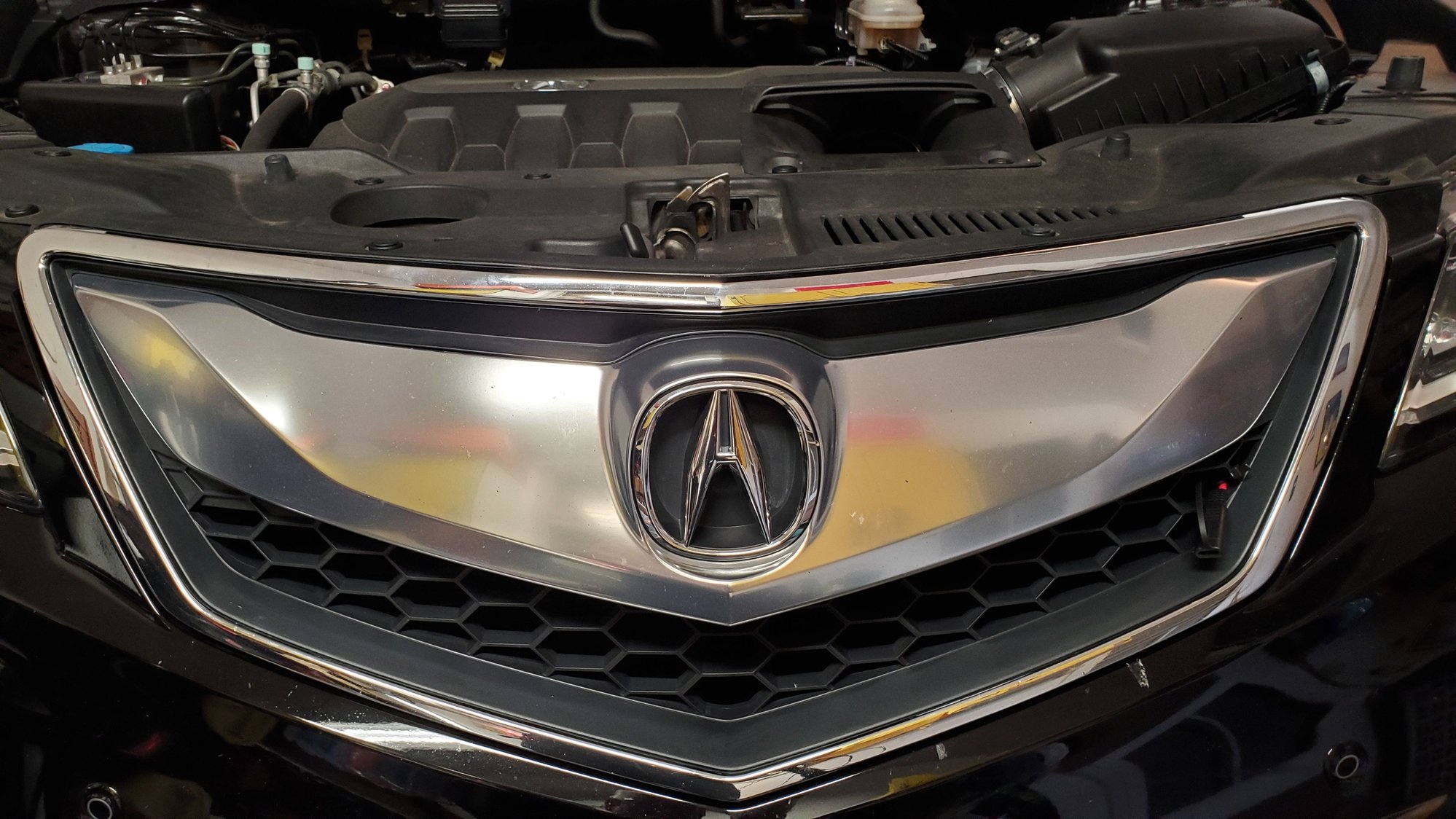

I haven't done a complete write up on it but I can give you a generalized procedure on how I did it. Did it about three weeks ago. Step one: remove the two fasteners that hold the air intake inlet and push the air intake back out of the way. The fasteners can be removed easily with a flat bladed screw driver. They are a plastic piece inside of a plastic washer. Pry up gently on the plastic center piece. Step two: remove the plastic cover that is under the hood and just above the beak. It surrounds the hood latch and a radiator cap, etc. It's held on by eight fasteners. Step three: remove the bolt from the left horn, disconnect the horn and remove it. Step four: there may be a small brace that needs to be removed in the area of the radar gizmo also, memory is a bit foggy there. Step five: Now you have to remove a bunch of small phillips-head screws and two clips, all from the backside of the beak. The screws are very small, I'd use a magnetized screw driver so that you don't drop them into the engine bay. The clips (they are a part of the beak) can be released by pinching them together and pulling the beak forward. The Acura emblem is not a part of the beak. Step six: pull the beak out, if it doesn't come out easily check for more screws/clips to be removed.

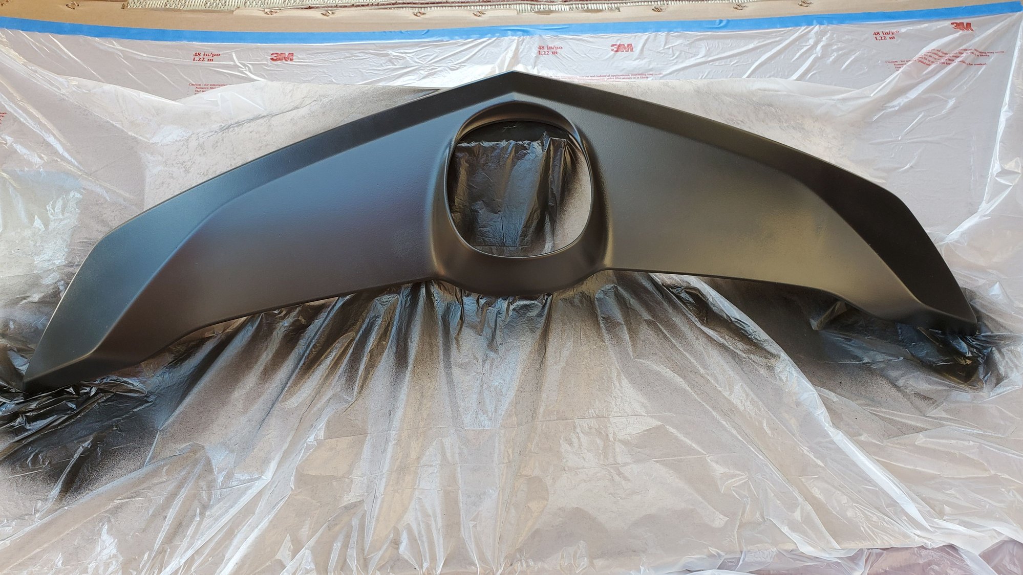

First pic is before, second is with the beak removed and the final one is of the beak out of the grill. Hope this helps a bit, I'm writing this by memory as I didn't keep notes while doing it.

Thanks for the beak removal guide! Now that yours has been painted and on the road for a couple of months how is it holding up and what did you use for paint? I'm still on the fence whether to use a rattle can or take the beak to an auto body shop to have it sprayed.
Cheers!
Old Sep 7, 2020 | 08:17 AM
looks like it was done with plastidip.
plastidip isnt as impervious as an automotive paint and clear. meaning; it will get dinged up faster.
I also believe that the chrome material used on the beak wont allow automotive paint to adhere to the surface....
a better option is to vinyl wrap the beak. which is a win win!!!! would be a lot cheaper than painting it.

Originally Posted by Gadgetjq
Hi WSW,
Cheers!
You're welcome! I've put about 1650 miles on the car since coating the beak 2 1/2 months ago. I used Plasti Dip in spray cans (I got mine from AutoZone). 4-5 coats of flat black and 3-4 coats of Plasti Dip glossifier. I am surprised at how well it has held up. It felt a bit sticky even after it had cured so I was concerned about bugs, etc sticking to it. However, that doesn't seem to be a problem. In actuality, stuff sticks to it less than it does to the body of the car.
I run the car through a brushless car wash whenever it gets dirty and that seems to clean the beak. It is kept garaged all of the time. There is no peeling, flaking or fading of the coating, it looks the same as when it was first coated. One great advantage to the Plasti Dip is that if I don't like it, or it gets damaged or I want to change color, etc. it is easily peeled off. That's my experience with it. I can say that I am pleased with it although I was a bit hesitant and skeptical before actually doing it.
