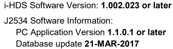

I need to update my A/T software for my 2014 ACURA RDX Base AWD. The current version I have is [37806-R8A-A530] I need to update it to [37806-R8A-A540] or later. Dealer wants $150 diagnostic up front for this 15 min job because "I can't tell them what service I need, they will tell me what service I need"
Where can I find reliable source of access for i-HDS and J2534 Software with versions later than:
This is regarding the procedure on SB17-017.

Hi, if you can get a adapter for hds you can access the software on techinfo.honda.com. It's about $45 for one day and you have the newest version from the hds.

Thanks! I have an MVCI. Does this $45 subscription contain both the I-HDS and the J2534 software? Or are they actually one software?

It's the complete software package with honda download manager. iHDS, HDS, J2534 rewrite. All you need.
