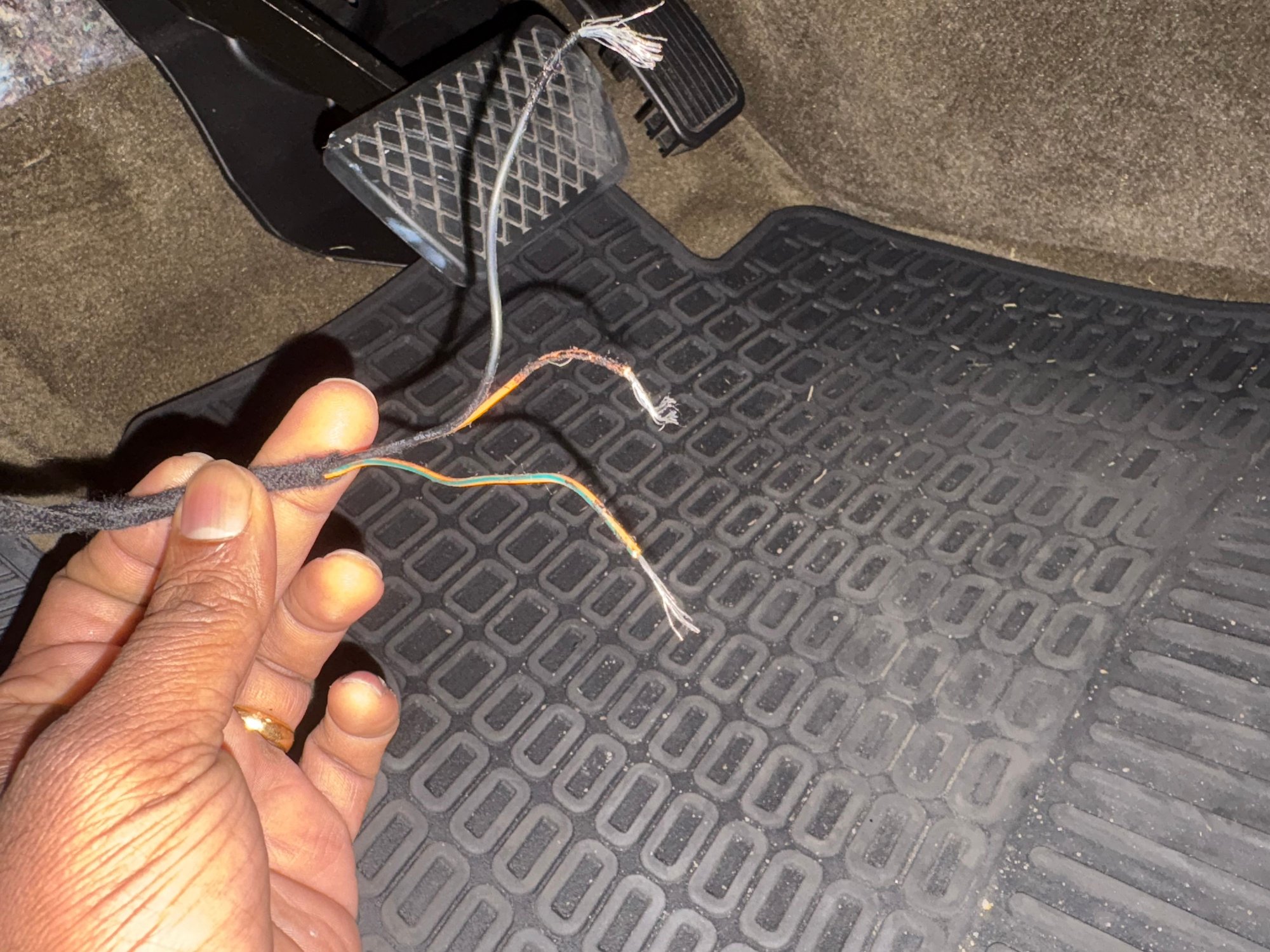

Hello all,
I have a 2013 Acura rdx tech with a viper remote starter which has the ds4+ module . I found this wire hanging on the carpet which is black , orange |green and orange | black.
i removed the steering column cover to check for any wire that is being spliced and I don’t see any.
If I try to start it, it shuts down immediately and the green key lamp comes up on the dash . But it starts but it shuts down a while.
I am running my out of ideas and pretty skeptical about taking it on the road ..
Any ideas where this wires could be coming from
thank you

Is this helpful? https://www.manualslib.com/manual/13...d-Ds4Plus.html
Also, try putting the car in Run mode (press start button twice without stepping on brake), measure any voltage on any of the three wires. Also see if any of them are grounded.
