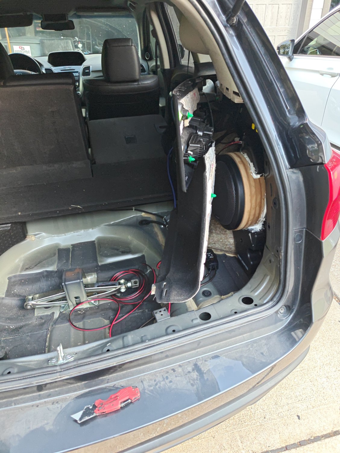

I know this thread is a little older, but I just picked up a 2017 RDX a couple weeks ago and I was blown away with how crappy the sound was in it. The fix was fairly simple, although I have a little more tuning to do. I used to install high-end car audio about 30 years ago and I've never been afraid to use cheaper components to get a decent sound and be happy.
1. I replaced the factory sub with a Pyle 8" from Amazon. Easy fit with a couple new screw holes. Heck, the factory holes may have lined up but I had a Phillips driver in my hand with a few drywall screws nearby so I did what any normal man would do... The speaker is a dual 4ohm voice coil so I wired it in series to take it to 8ohm, but bridging the amplifier it sees it as 4ohm.
Amazon Amazon
2. I installed a bridgeable amp in the wheel well (I took out part of the foam around the spare tire) so the amp is hidden from view. This amp has settings to control 6 vs 12db crossover as well as frequency cutoff adjustment for subwoofer use and the standard gain.
Amazon Amazon
3. I simply snipped the wires to the subwoofer and ran them into the high-level inputs on the amp and back out on the bridged channel from the amp to the sub. Since it's mono going in it should not hurt anything so I ran it parallel into both channels. It's possible the amp might burn up in a year or two but I'll replace it for that price and enjoy my music in the meantime.
4. I don't know if it made a difference but I had already disabled the ANC in the system prior to see if it made a difference so I left it off.
I will probably change the capacitors on the front door tweeters as they are way too high. A 1" dome (and they aren't bad tweeters) should not be crossed over that high. I might bypass the caps for a while to see how they sound as I believe it's possible the factory amp is crossed over, anyway. As a quick test I bypassed them temporarily the other day and they sounded fine and sounded like they were still on a HP filter, anyway. We'll see where that goes.
Hope this helps someone else!
I can say it is a thousand times better and I'm amazed how anyone at Acura would lay claim to that factory ELS sound system.

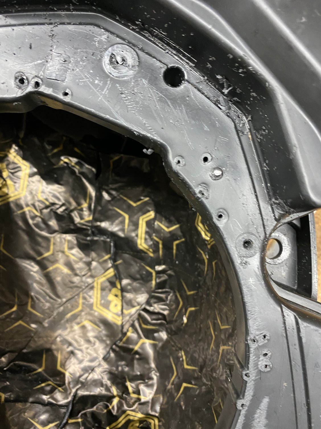

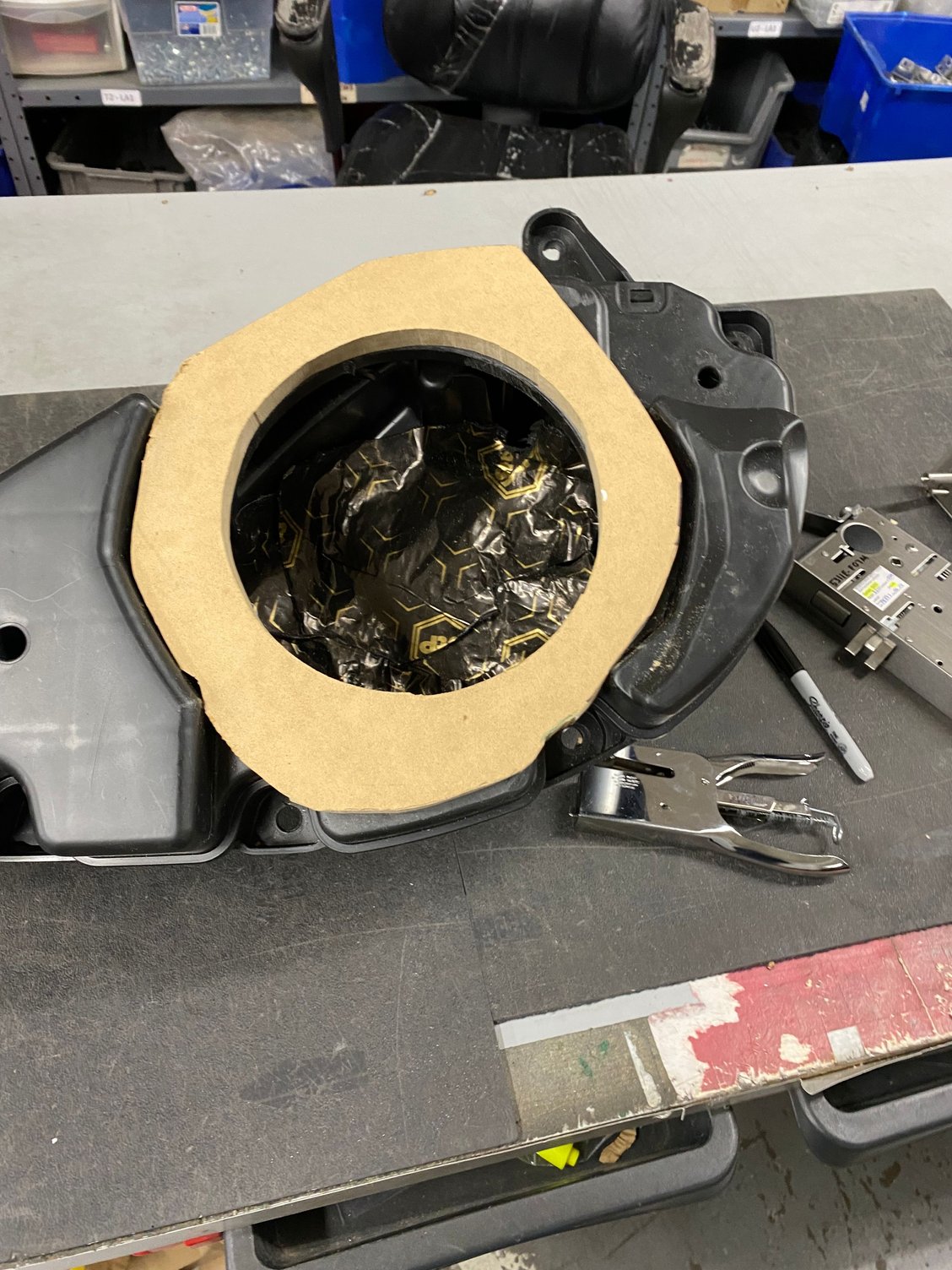

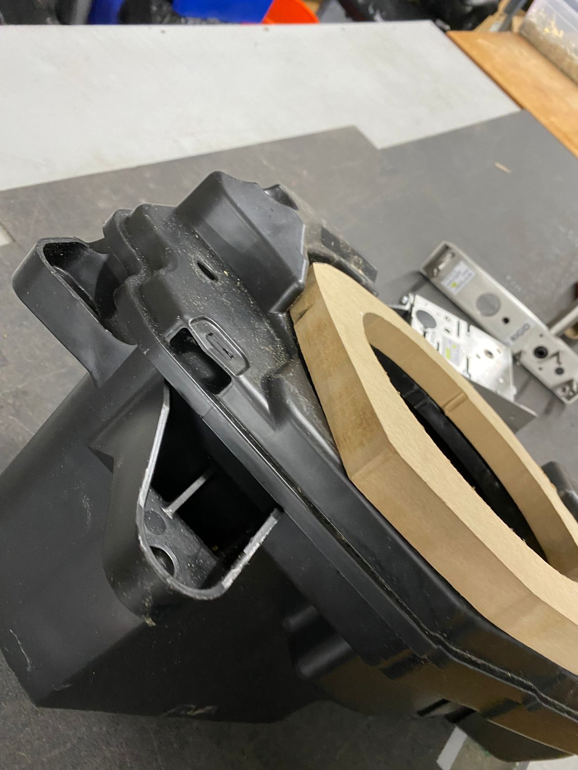

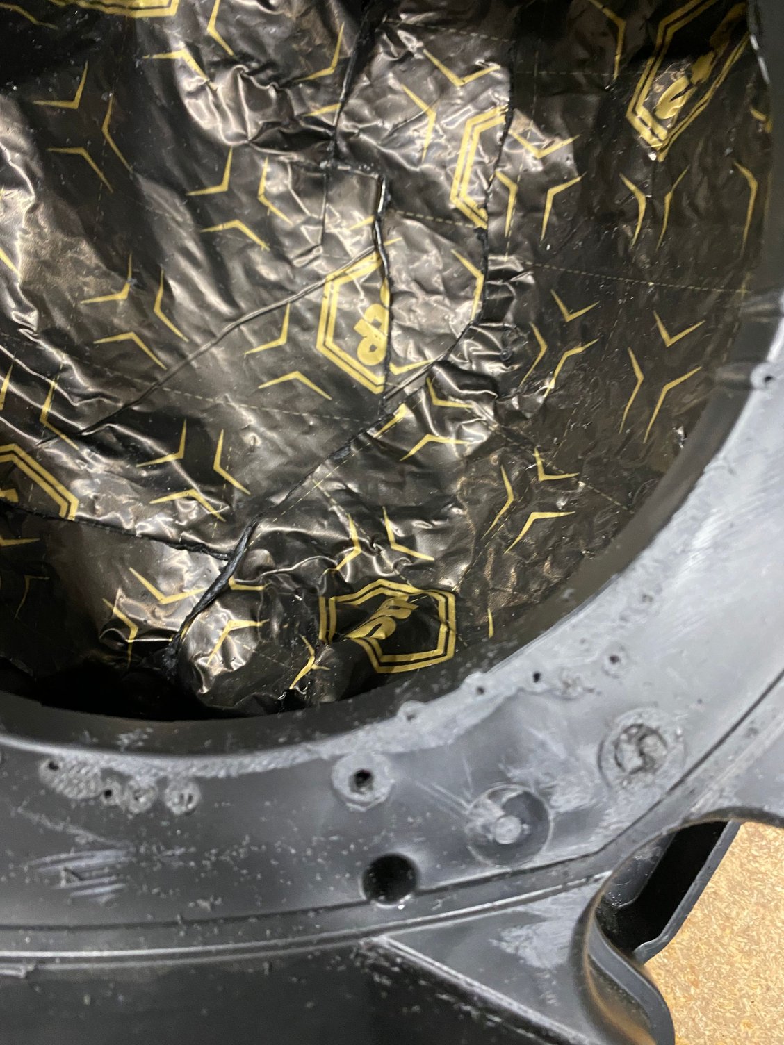

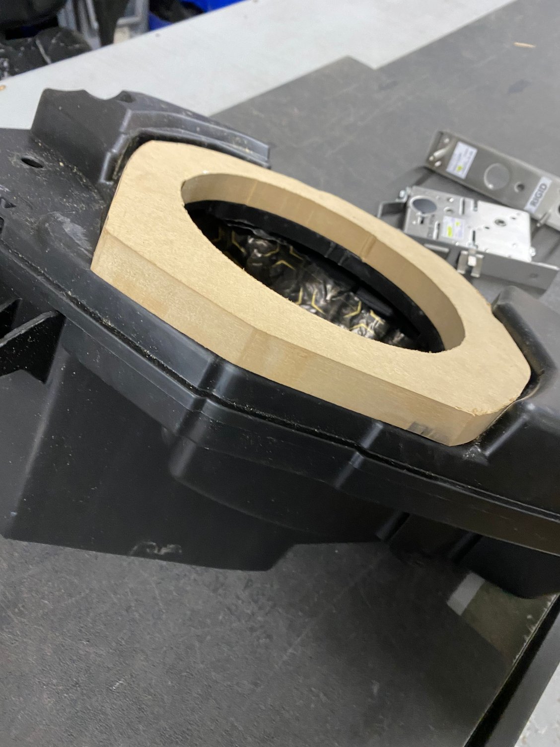

2013 RDX Tech Sub Mod

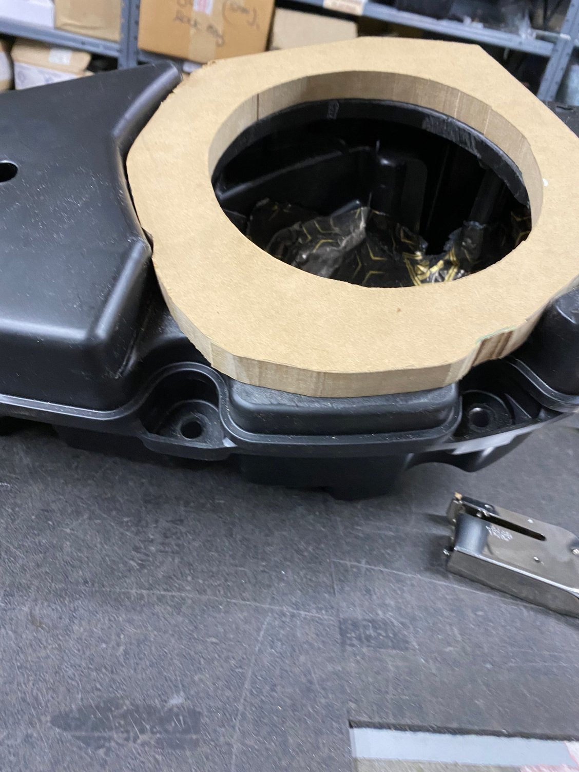

Ok so i used @JD8 Idea mainly because the 8 inch sub that I got didn’t quite fit the hole. The stock hole was slightly oversized for my sub Which made mounting it extremely annoying because the screws wouldn’t all catch like I’d want them to … This lead to air escaping between the The rim And makes the sound poor This also increases the inside space so it will make the sound a lot better
Final look Waiting for the grill to come in
Getting the fit right making sure the surface is nice and flat
Shaping to fit
Nice and flate

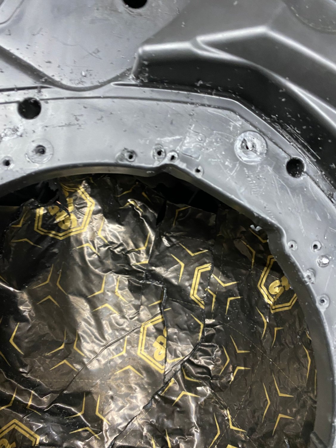

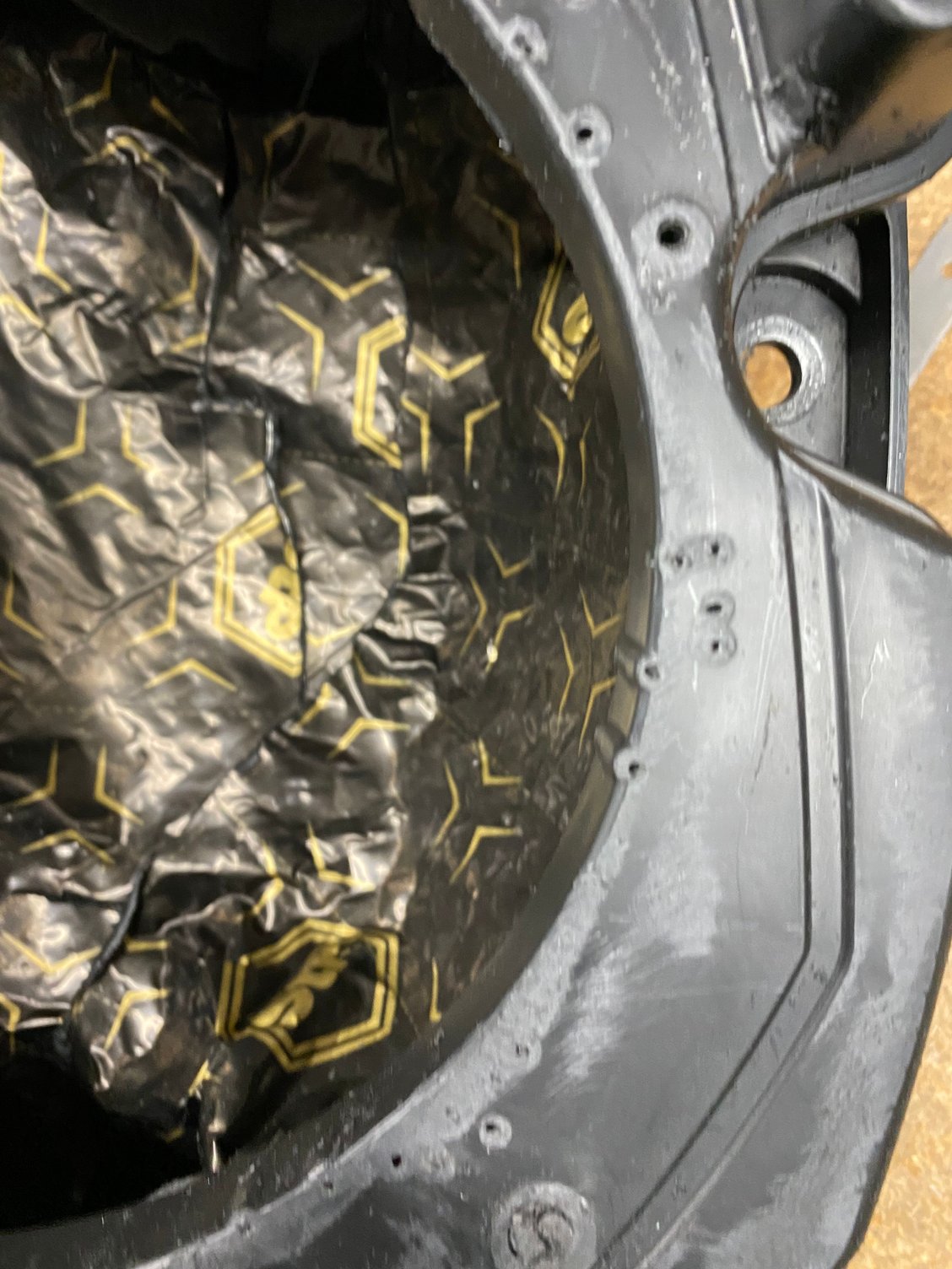

Here you can see the attempts to mount the speaker to the oem sub enclosure
Filled all of it down and i had to remove the 4 standoffs that held the inner plastic grill
Standoff removed top right corner
Surface filing

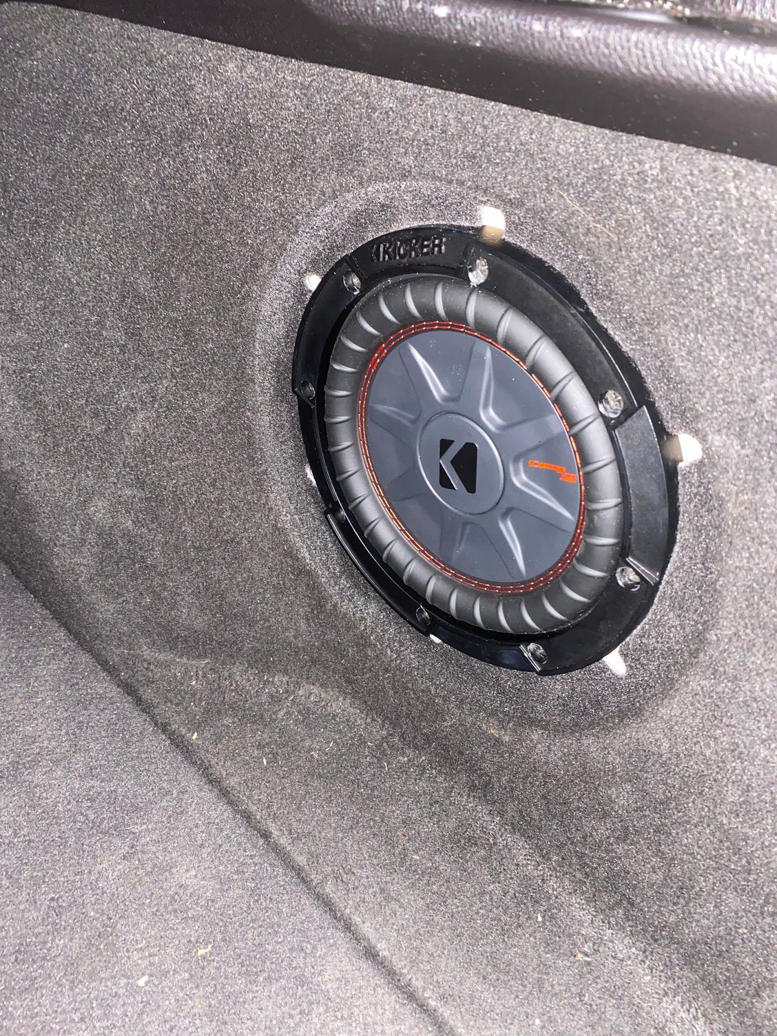

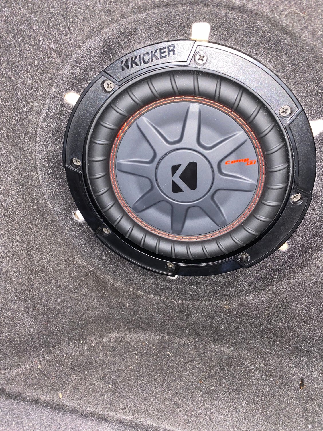

2013 RDX Tech (Copying JD8 Mostly)
Copying JD8 for my 2013 RDX Tech, same subwoofer, 6.5 inch NVX V series door speakers for the front and rear doors, dedicated amp for the sub, and dedicated amp for the door speakers, keeping the OEM amp for the other 5 speakers and using the LC2i to tap the rear speaker wires to get full range speaker signals sent to both amps.
