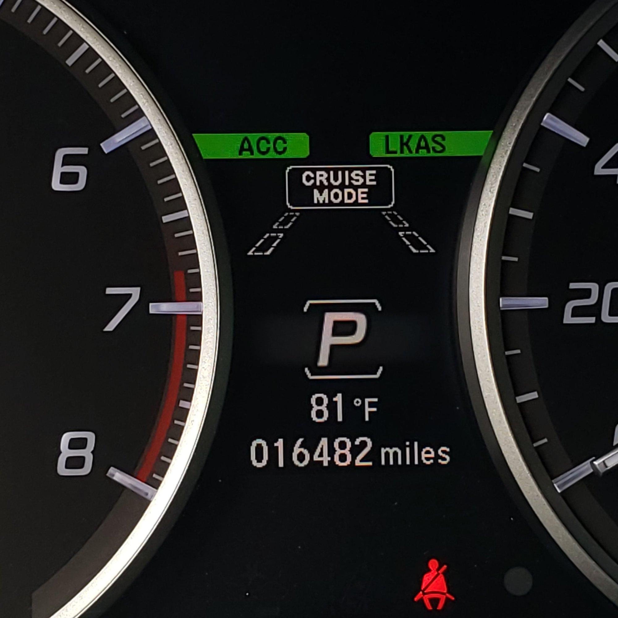

Hi All
Yesterday I noticed that my ACC display changed. When on, it used to show a car with lines to show the following distance.
Now all that shows is Cruise Mode. As far as I know, I didn't change anything and I went through the ACC settings to see if there was something there I could change...
At a loss.... Any help is appreciated.

If you press and hold the distance button it toggles between the two modes (ACC & CRUISE).
