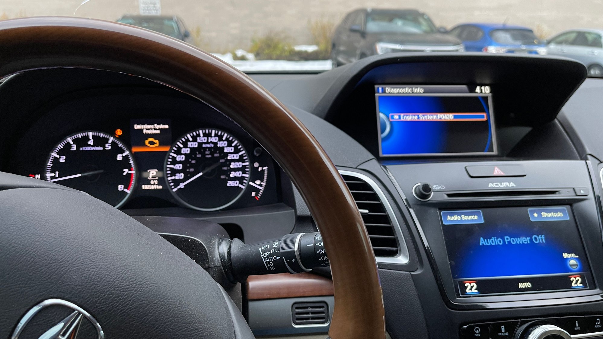

I have a 2018 RDX Elite (Canada)/Advance(US), 8 years old with just over 100k km (60k miles).
Last Saturday when heading out, it shifted roughly, then the engine lugged… ran really rough, smelled bad even when in neutral. Got it home, and towed to Acura dealer.
They managed to look at Saturday, said it was a misfire in cylinder 3. Issue did not follow ignition coil, so Monday morning the tried replacing plug. That did it, so I had them replace all , even though they are normally “due” at 7/160. Unfortunately they threw the plugs out, I wanted to see how all of them looked, since it seems early.
I got about 5 km/3mi down the road, and Check Engine light came on for an Emissions System - Error PO420
Error message
Error message
. Tech ran diagnostics which suggested a bad first cat… but that maybe driving it hard for a bit may clean any unburnt fuel out of cat…
So… anyone come across this before? 8 years, but only 100k km on the plugs… seems early. I always use premium fuel, and do all required maintenance per the Minder.
Also thoughts on whether some driving (hard) will clear cat? Driveability is good, possibly better than before…
Ideas?
