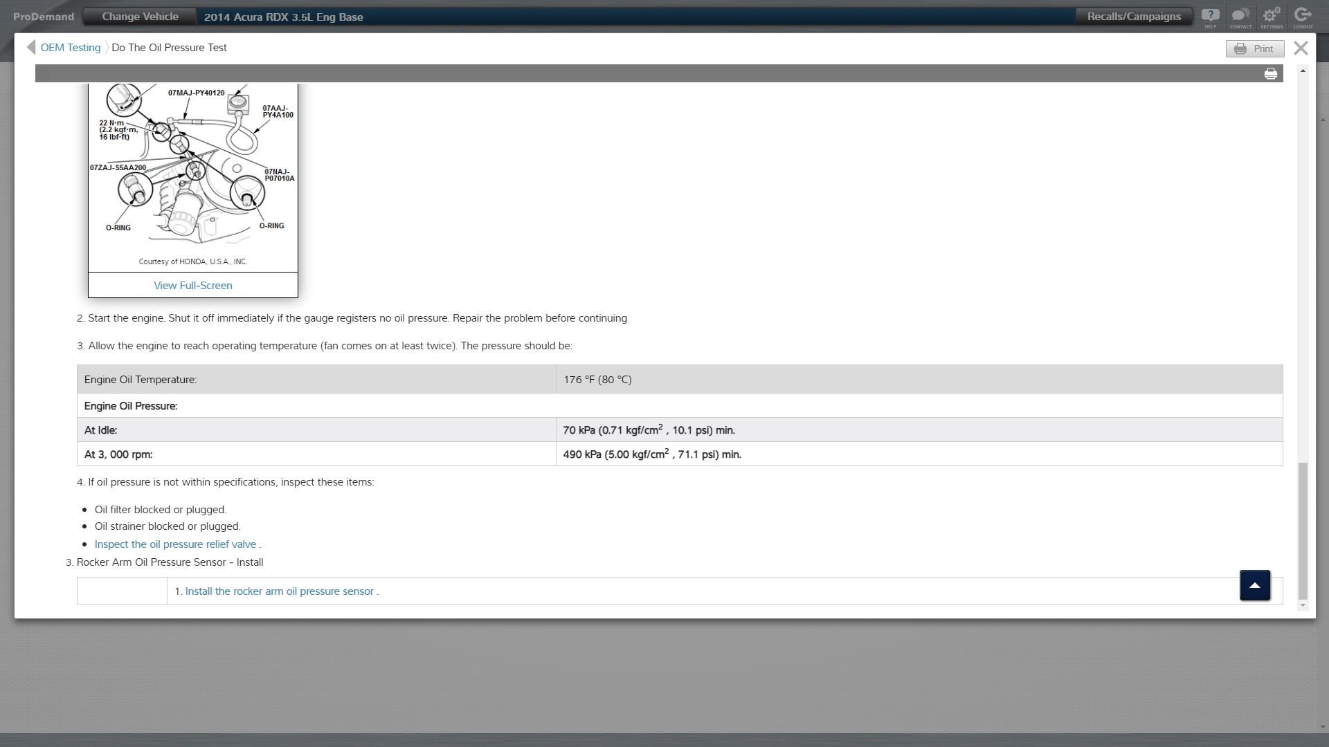

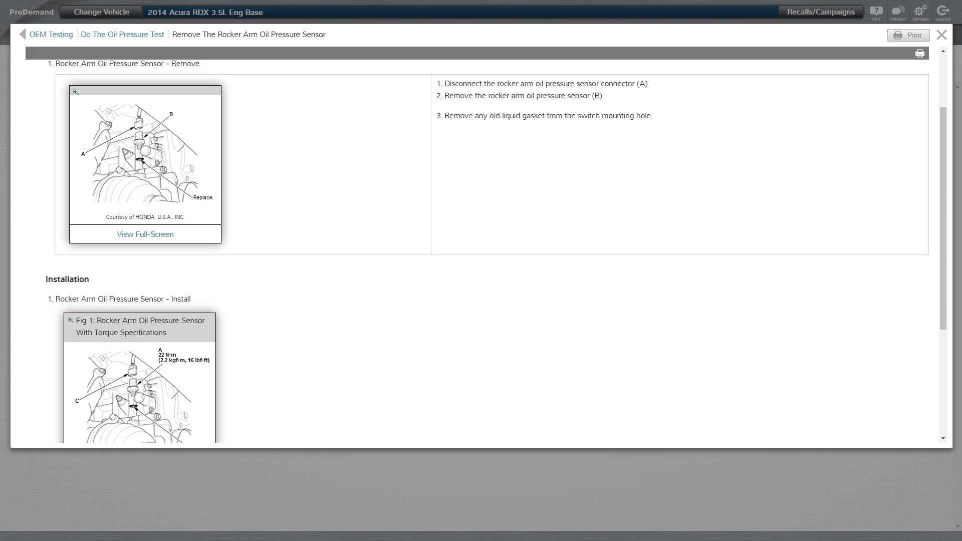

Thank you, I appreciate the information. I was really concentrating on the other 2 pressure switches (the ones that are under the hood on each bank of the engine - Single Wire Switches. I used the manual pressure gauge I received from Amazon today on those switch housings, and the gauge registered no Pressure at all (zero). I then started thinking about the third switch that is on the oil filter housing - this one has 3 wires ( this is the one shown on the guide you posted above). Tomorrow I'll do the pressure test on that one and see what I get.

Today, I checked the pressure on that 3rd port near the oil filter and the readings are within the specifications. I also made a big oil mess when I turned the ignition ON by mistake when the switch was uninstalled and before i hooked up the pressure meter. (got the stupidity award for this one for sure!!), luckyly i had a big bag of sand to contain the damage before it spilled all over the whole driveway!!.. Anyway, the oil pressure is about 15psi at idle (650 rpm) and just about 80 psi at just over 3000 rpm. So it is now either the oil pressure switch or the wiring at fault. Checked the fuse (The one labelled "Oil Level" in the fuse box under the hood - 15A) and it is OK. However I can not read any voltage on the red wire of the pressure switch whether the ignition is ON or OFF. There supposed to be a reference voltage on that red wire, but I am not sure when it is supposed to be present and how many volts.

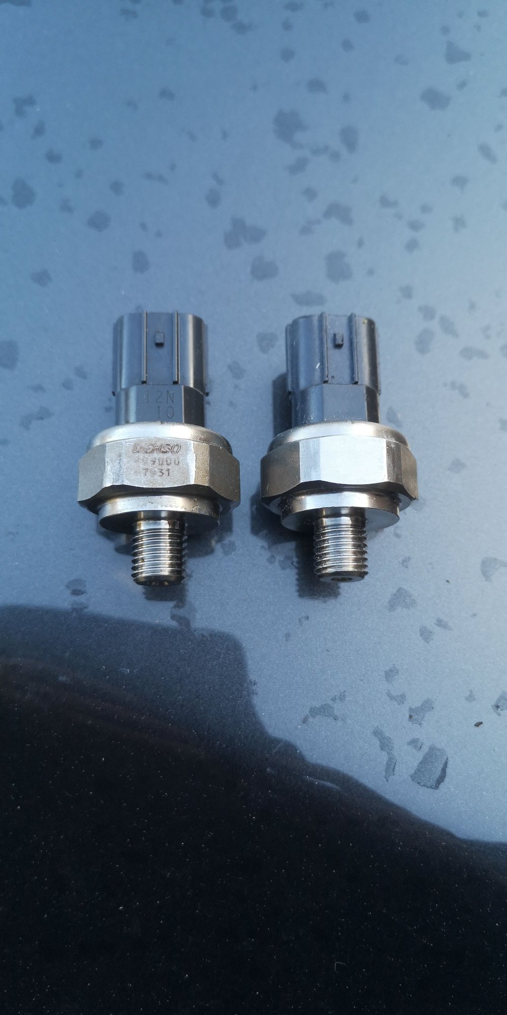

Yeah, no damage other than the oil spill on my driveway . Yesterday, I said, "oh what the heck, I'll buy that $15 replacement switch from Amazon and see if it fixes the problem rather than me trying to diagnose the wiring, and lo and behold that cheap sensor marketed as the FUEL LINE pressure switch and that looked exactly the same as my OEM Oil pressure switch fixed the error code. This part sells for $218 at Acura Parts Warehouse, compare that to $15!!. OK mine is not the OEM part but no one can actually tell whether it is made better or worse than the OEM part, and whether it will last as long (10 years) but they look and feel exactly the same except the cheap one has no brand or any markings on it while the OEM one is a DENSO switch. In any case now that I know how to replace it, i can always get an OEM one if this one doesn't last long enough.

If you look at the picture the OP provided the sensor on the left is the Acura OEM Denso part #499000-7931.
If you google that Denso part #499000-7931, it ties back to #12 Oil pressure sensor on the Acura parts diagram below.
In addition, it is the only sensor near the oil filter base that is close in dollar amount ($218) to the one OP refers to in post #12.
