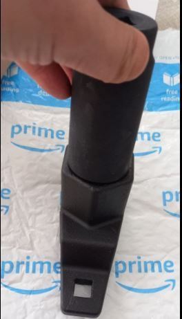

Hi everyone. I will be changing the timing belt on my 2015 RDX soon and have been watching several videos online.
There are conflicting statements about the direction of crank pulley move that may cause damage or turns the timing off. Some say counter-clockwise move would do the damage and others say the clockwise move.
Since removing the crank pulley bolt could be a challenge, I bought a 19mm heavy socket and crank wrench to hold it.
However, they do not fit in each other (see the picture). This means that when I want to remove the crank bolt using the 19mm socket I cannot use the wrench. The bolt opens in counter-clockwise direction. So the question is whether I should hold the crank pulley from moving. Some say that since the direction is counter-clockwise it is OK and some say the opposite. Others say use the wrench when tightening the bolt at the end of installation for the torque spec preventing it from moving clockwise.
Has anyone used these socket and wrench? Any suggestion?

I just did this last week. Before you remove the acc belt, hit the bolt with your heavy socket as is. Took 7 seconds with a 25 gallon compressor at 130#. Regular impact socket never touched it. Get the bolt out, remove acc belt, all the covers, then put bolt back in by hand. Turn crank clockwisewith ratchet or breaker bar until all the marks are aligned. Then hit the bolt with the heavy socket to remove and it won’t move the crank a bit. Swap everything out, and you will get to use pulley holder to install. 47 foot pounds then 60 degrees. Pro tip- Rotate the rear cam gear clockwise a 1/2 a tooth to help get the belt on. Not much, but it will save you some frustration. Be methodical, make sure pump o ring doesn’t fall out of groove, and after you pull grenade pin, turn engine over 5-6x by hand clockwise with ratchet to ensure marks still line up.

The second generation rdx 3.5 v-6 crankbolt is not reverse thread. Lefty loosey. Yes- just hit the bolt without the holder, and it should spin right off. You have a v-6 with the timing belt on the passenger side of car, right?
There are 6 sides to that bolt head. 6*60=360. Take a white paint marker, index your starting point on the pulley, and the ending point, and tighten bolt that much. Get the car as high in the air as you can, to use the longest breaker bar you have. It’s going to wind up around 180 nominal foot pounds.

If you have the milwaukee impact, you shouldn't even need the pulley holder. I was able to take off my CP with ease using my Dewalt 1/2" impact. I pulled out my holder looking to use it but never had the opportunity
OK sounds good. Yeah the Milwaukee impact is a monster. It's loosening power is incredible. Has a Dewalt but sold it and got the Milwaukee. You need the holder for tightening the bolt at the end of process though. Without it the harmonic balancer may start moving.
