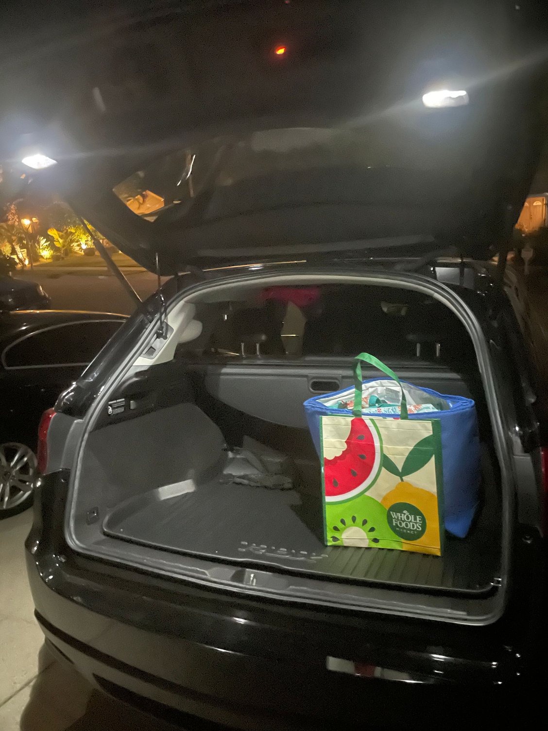

Here are night pics
Cargo leds
Cargo leds

Looks good in the photo, but how much brighter would you say the cargo lights are over the stock bulbs? A little? A lot?

A TON. I did the same thing when I got my car and the change is eye opening.

yeah a ton the oem yellow lights are very dim can’t see well at all these are what should have come stock.

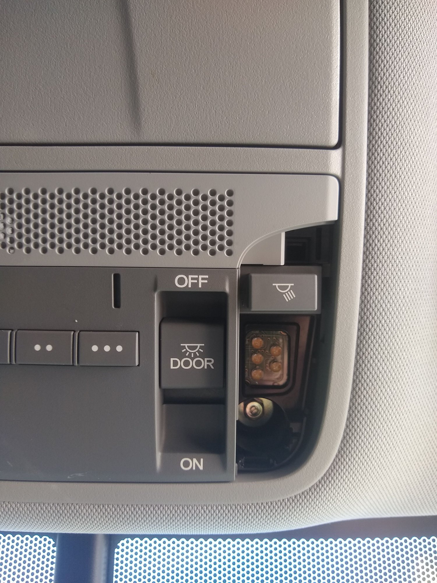

Hi guys, for the 2016-2018 RDX's the front interior lights are already LEDs and appear to be hard-wired in/not easily replaceable (see picture I took below). I was hoping to change them from warm white to cool white.
The center dome light bulb above the rear seats is a DE3175 (not already a LED)
The trunk/hatch lid lights are 2825 ((not already LEDs)

Yeah I did not touch the map lights on front only the cargo/door/center with numbers noted in the thread
